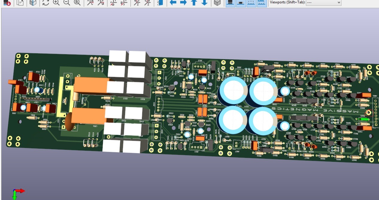

One possible contender was Luxman B1000F. At least it was more from around the time of MA9S2, as versus more recent. Maybe more on this subject later.what is the best? no.1?

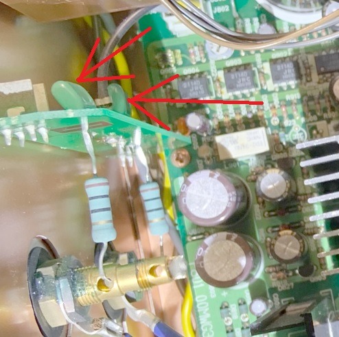

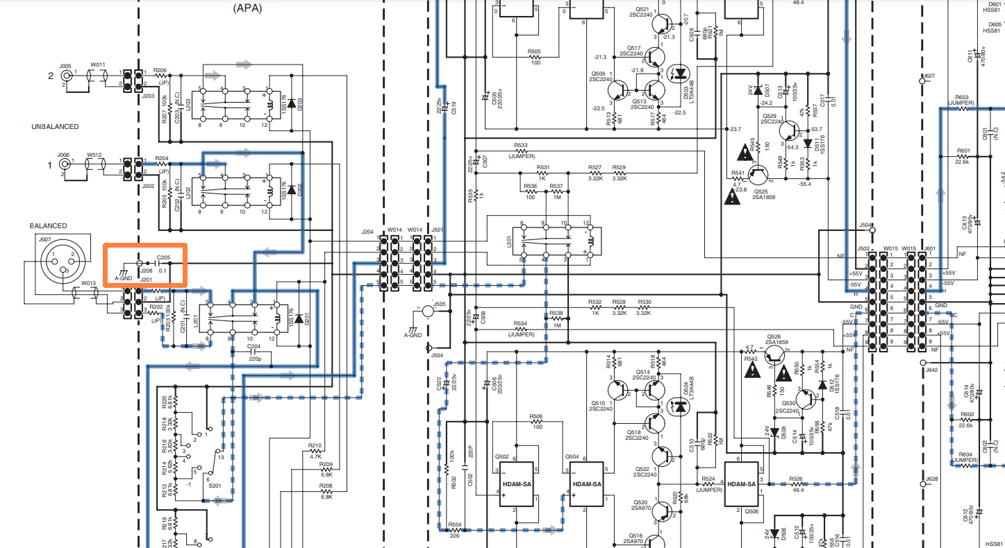

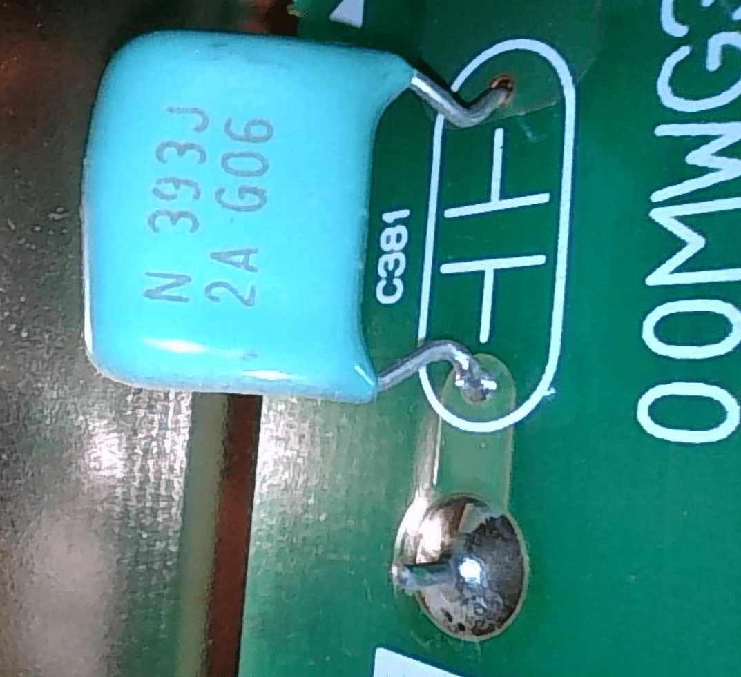

Hi.It writes C311 at their service manual.It is in series with R362 which is 10 ohms 3w .It is Zobel circuit to protect speakers from oscillation.

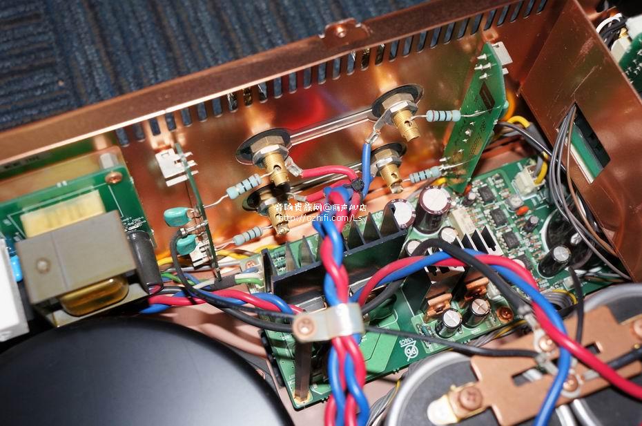

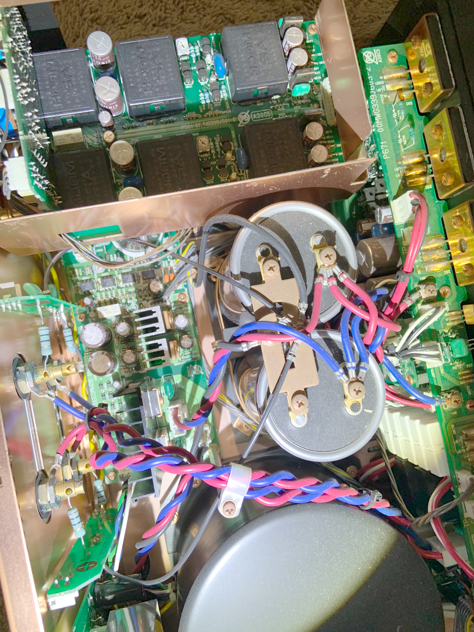

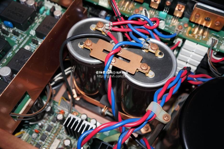

Dear Mark.Thank you for the photo.Could you also check the choke? We want to know DC resistance of the choke for building.Okay, finally got one opened up. Ground wire on the bus bar between the big caps goes almost straight down and attaches to the case baseplate:
Thank you very much for your measurement.My friend also wants to know the VA rating of the Main transformer.I think it is not necessary but he wants to know it. I think It may be estimated by dimensions of the transformer too.
I thought it was taller. Allright.Maybe we can use bigger core as it is easier to build.Could you also tell what is size of the choke approx?
~2-1/2" high, ~3-1/2" diameter
Would also note that most of the electrolytics around the sound path are Silmic. A few others are Elna Certafine, or Nichicon KG(M). Beyond that I hope to close this thing up again pretty soon and put it back into hi-fi service. May open it up again sometime later, but can't say exactly when.

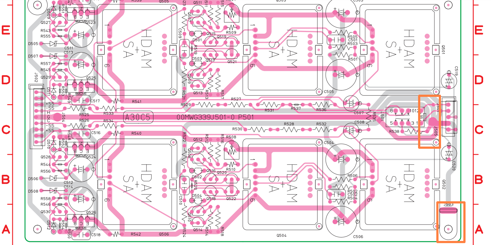

There is an RF ground at the input:
DC ground must be via the output side.
EDIT: Well, maybe not. Looks like there are places for jumpers to ground (e.g. J505, J810, J811). Not sure where it connects. May depend on what was found to work best after the layout was tested.
