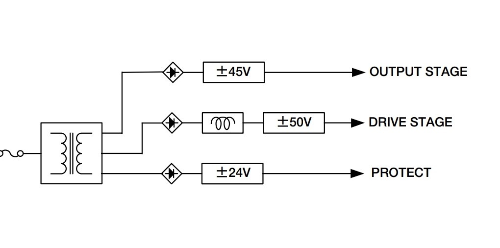

post #14, this is a low power supply for the front ends, and so i have no problems with his calculations. seems typical..
i suspect that the front end of the amp this psu supplied is class A so that loading is pretty much constant...

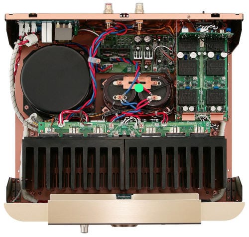

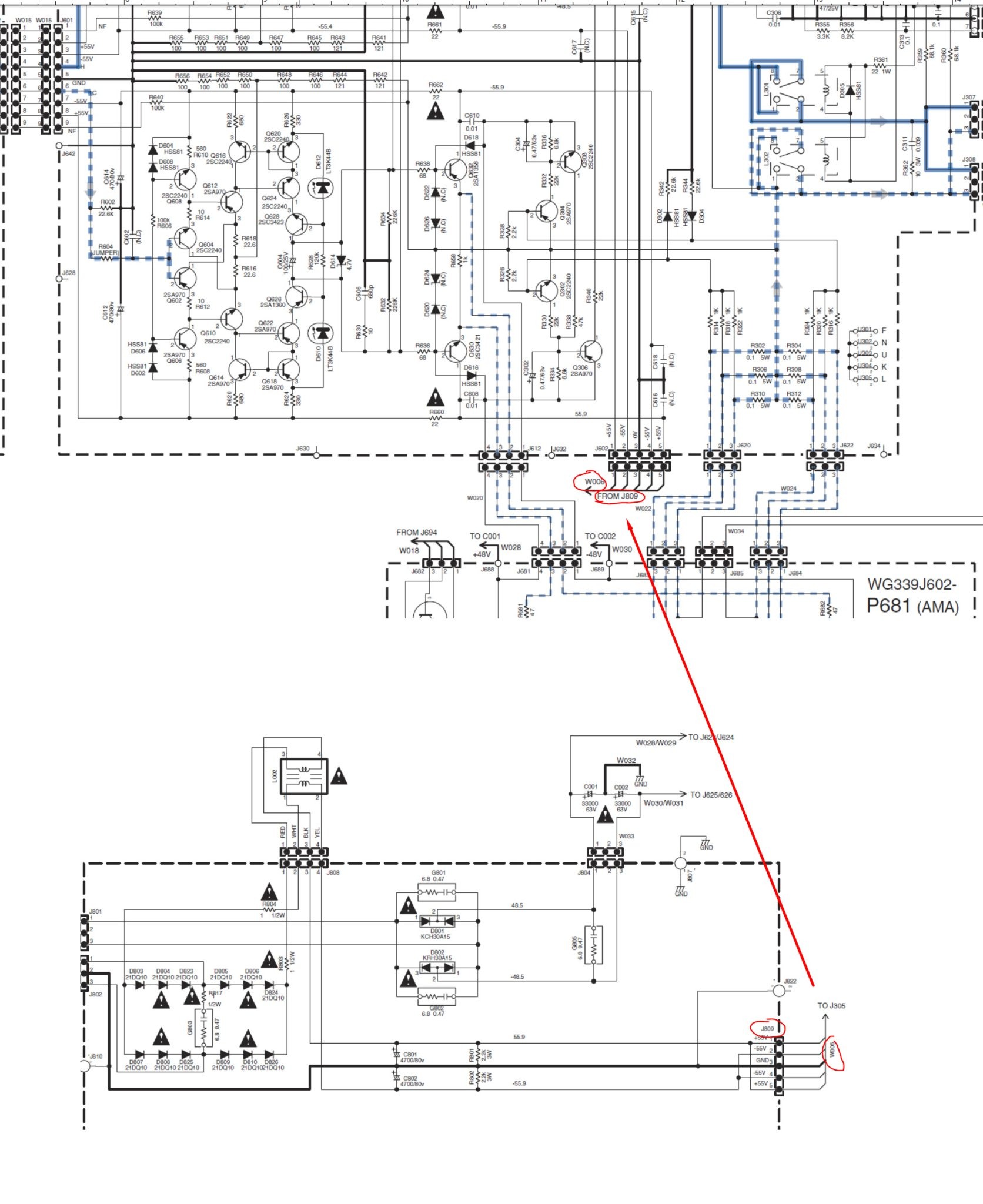

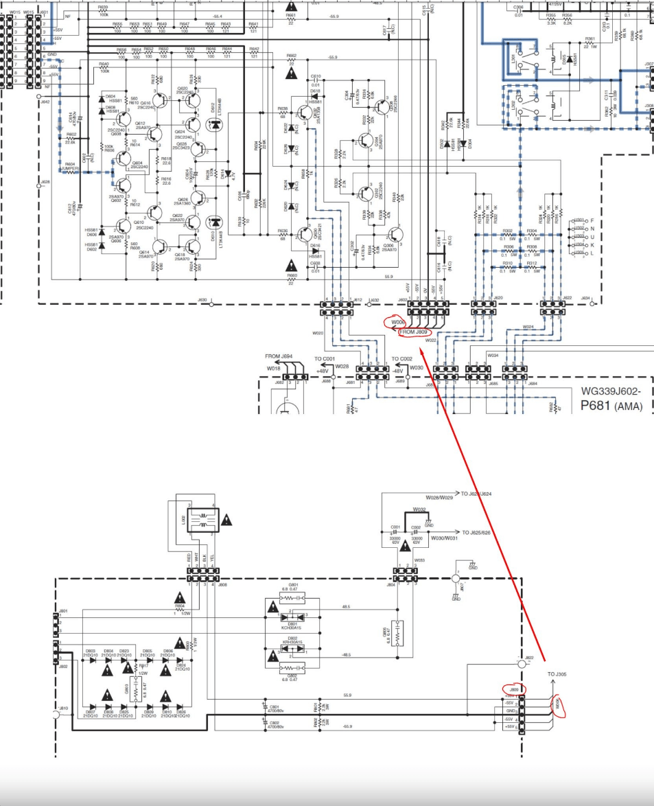

Did you miss my post where I clearly stated that you overlooked the fact... that the choke in question supplies the full current grunt needed by the amplifier PCBs? I even posted a little photo...

Have a better look... the choke supplies current to the main amplifier section. This is why my calculations pointed to a 12A rating... the worst-case power consumption/output, 4-ohm load.
The inductance could be calculated only if the amp is examined under load on a test bench.
I think I've provided enough info here, for something that should not really be encouraged... ripoff of the original design.
Do you mean choke supplies current for amplifier output?

Based on what? Your experience?? Did yous see the size of that choke?? Drawing from your experience, do you think Marantz would use it just for the pre-amp section??

Of course, it would be useless... you did not bother to check the circuit diagram, went on showing here how you are experienced and know so much, and then admitted the choke calculations are correct... for a pre-amp section - which is WRONG.

Still refusing to follow the red arrow??
We only know the inductance (2x180mH ) but do not know the wire gauge and toroidal core.Any ideas?
Looks like R803,R804 are 1R, 1/2W. That puts some limit on what the current through the choke is likely to be. BTW, have a pair of those power amps here. Haven't gotten around to opening them up to look inside yet, though. SQ is very good. Better in some ways than Benchmark AHB2.

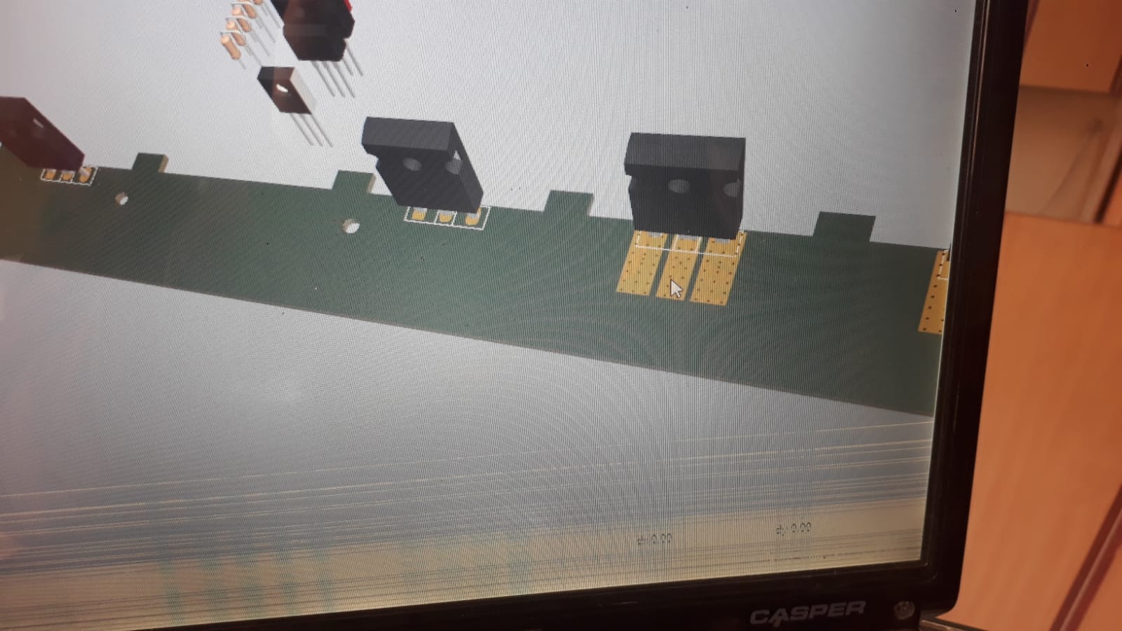

Hi. I am now finishing the output. Could you please tell where center tap of the power supply caps are connected? Are they connected to chasis gnd?
