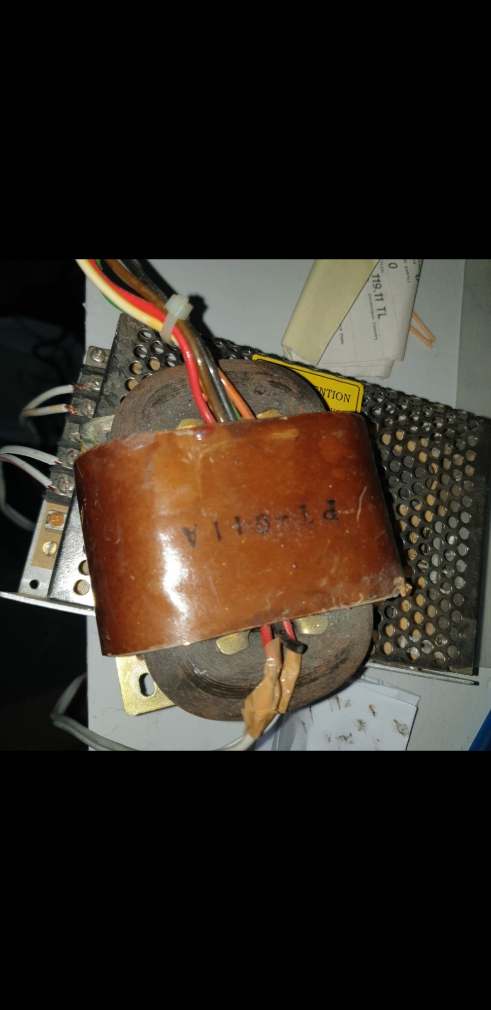

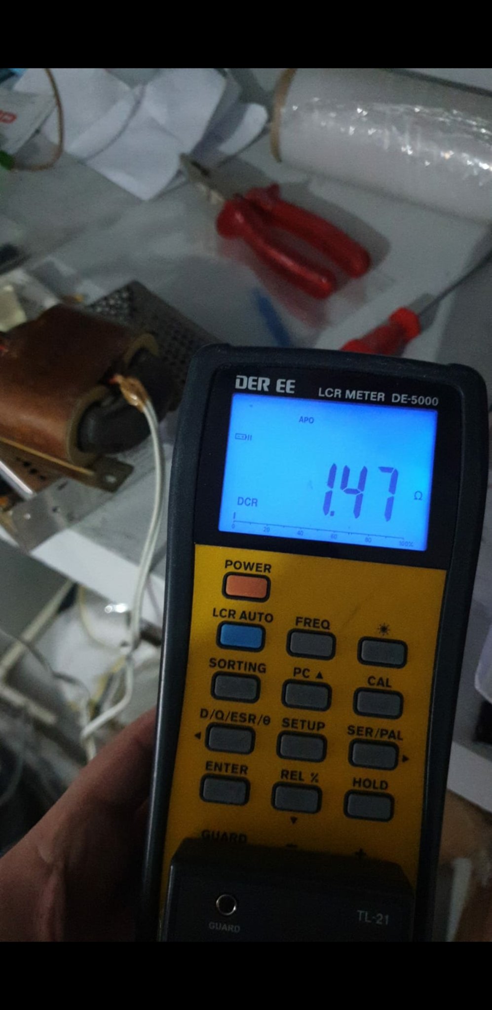

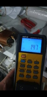

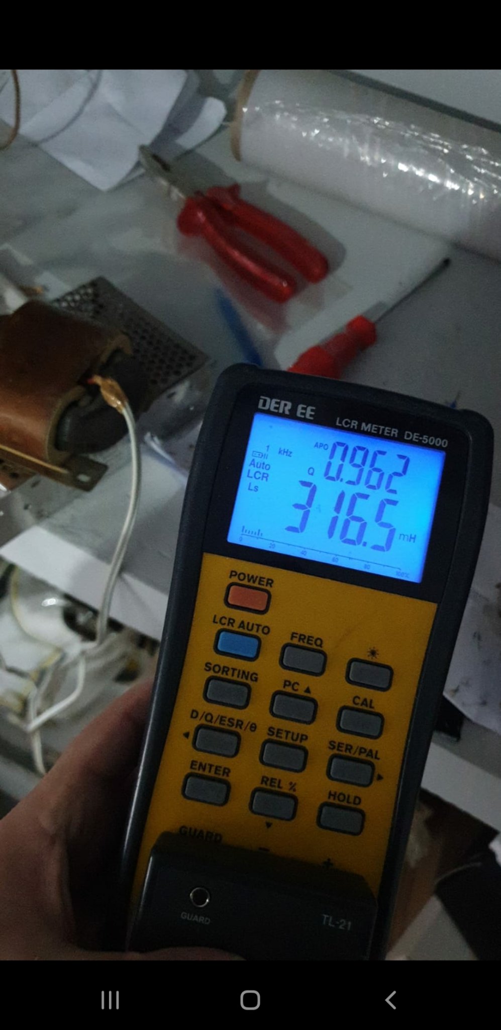

For chokes I already have 6 pcs of these R core transformers. Afaik they were removed from an old oscilloscopes and does not have a usable voltages so maybe we can wind it for chokes? It seems similar results may be achieved
