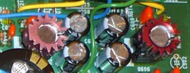

Finally I received the pair of LME4970HA op-amps from Farnell. In they went and at the same time I bypassed and disabled the HDAM.
Wow! what a open and detailed sound. This is a great mod.
But the op-amps run very hot - can feel it when touching for few seconds. Is this normal? Does any of you use heat-sinks on these?

Yes the Metal CAN 49720HA works quite hot and for peace of mind I put a heat sink on it 😉

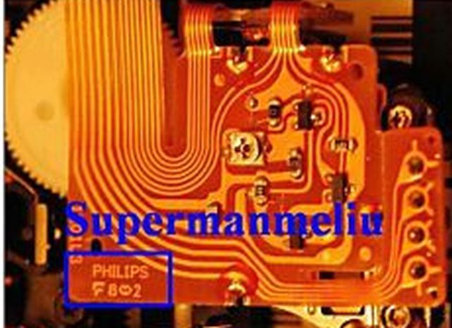

My laser has annoyingly decided to be very selective about which tracks and discs it plays. I have cleaned it but this makes no difference. Based on what I have seen on here, I understand that it is likely that the laser needs replacing.
Does this mean I need to replace the whole of the plastic assembly on which the laser and tray sit, or will the laser come out on its own?

I suggest before the laser dies you may try trimming the laser voltage by adjusting the small VR at the back of the laser unit. This may sometime help to extend the laser life.
Thanks very much for this. I have no idea how to do this, but I am seeing my guru next week and will ask him. (As an aside, I'm assuming 'VR' means 'voltage regulator', and 'trimming the voltage' means putting a resistor in circuit or inserting a lower value regulator?)
Not really. Yes VR means variable resistor. Trimming means you just use a small screw driver to turn the VR.
