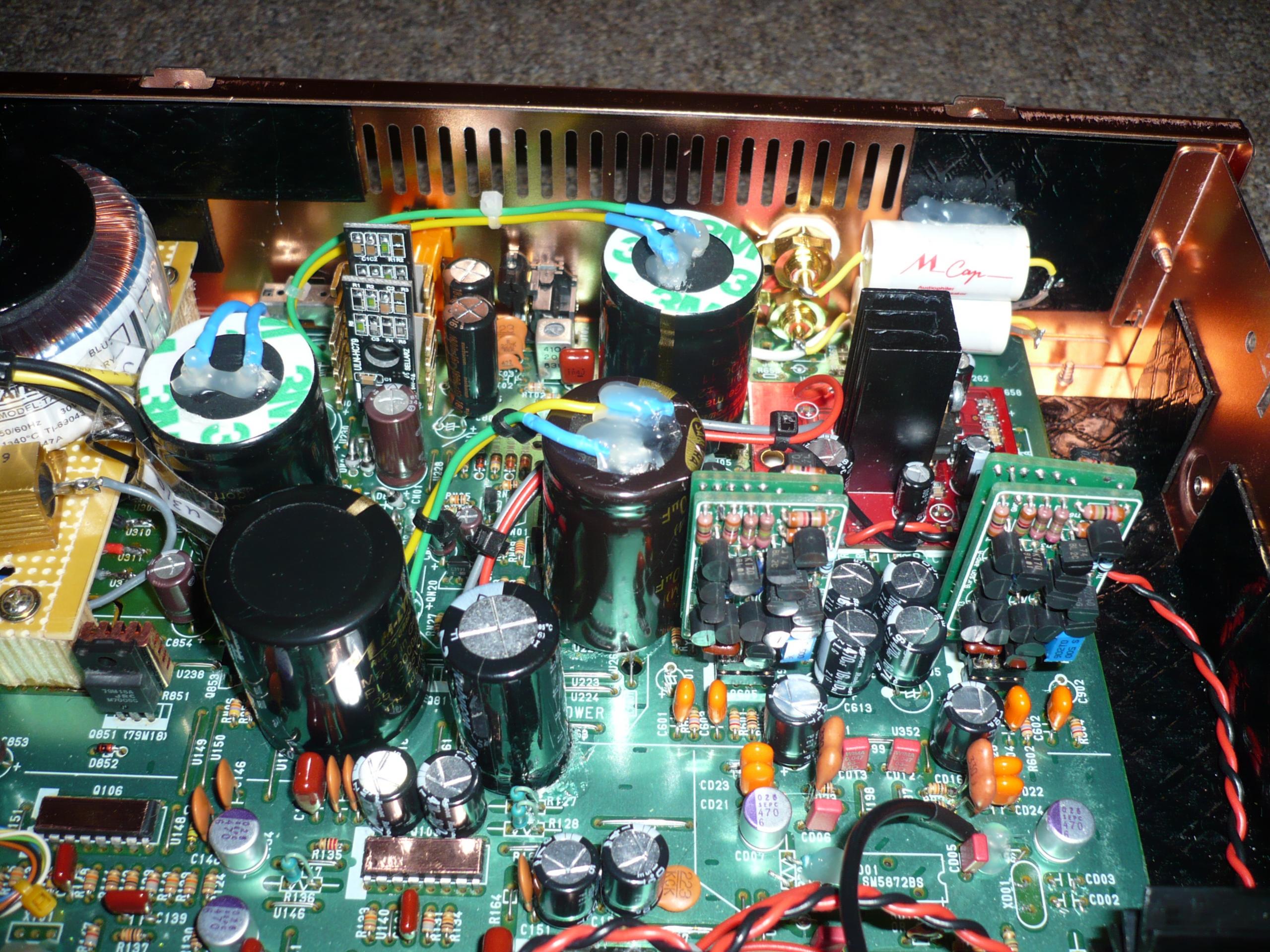

popped a 2n2 polyprop in place of the ceramiic 2,200 fitted nice change 20yr old phillips styroflex nos good mod .😀😀
Yes, this makes a big difference. Why the hell did they use ceramic for C505? Ceramic should not be used in the signal path.
Dos versus lme49720 opamps im interested in the comparison ? I like the sound i have @ the moment but itchy fingers and all that, We all know that one lol.
I don't have any experience with DOS but between 49720HA and discrete opamps I prefer the SQ from the discrete ones 🙂
I want to, Alan, but I still have to do more listening. It's not as simple as just that comparison because the whole output stage and power circuits were replaced. I spent a lot of time trying different op-amp power caps before settling on BG Ns, so those must've had an influence on the old sound, and they're out now. I had upgraded my filter caps with mica, but the resistors were still original. My stereo image is clearer now. There's so much to hear that is new and improved, but I'm sure there must be some trade off and I'm not sure what that is yet. I often A/B between CD and vinyl because I have several of the same albums in both formats. I think I need to do that with the DOS.
Oh yeah, also, established wisdom is that the DOS needs high quality regulators and big VA PSUs to sound its best. I just have four 7X12 regs fed by my existing supply (30VA?) with 22,000uF smoothers. Even as it is, it's definitely better on balance, both in terms of detail and musical enjoyment. I haven't had the hairs stand up on the back of my neck yet though.
One thing you can do if you have itchy fingers, Alan, is build one anyway and try it. It's possible to hook it up without removing the old output stage.

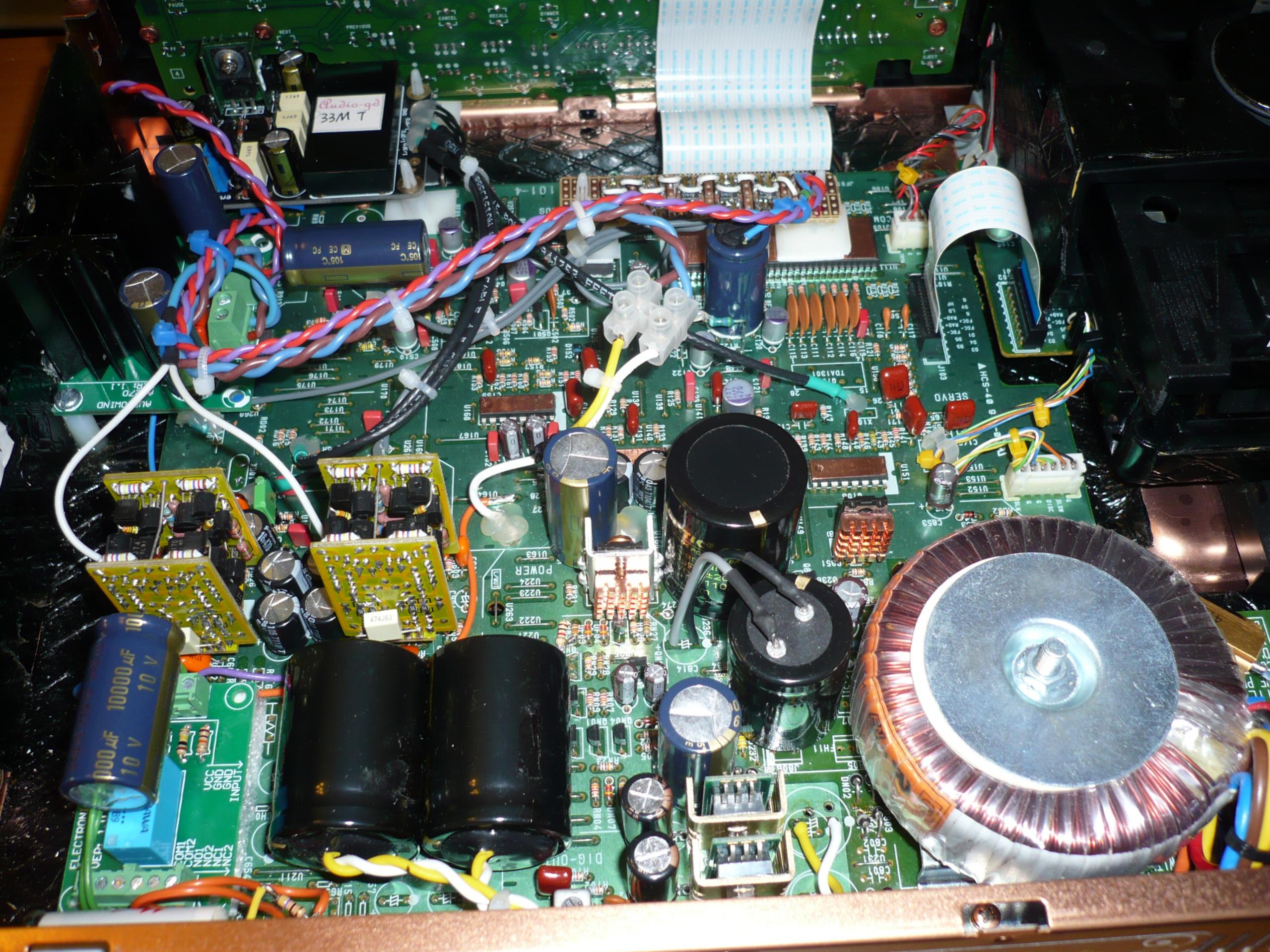

Cool pics! Those are two impressive looking players. One thing that jumps out to me about the discrete op-amp solution is that it looks like it must involve almost four times the component count of the DOS.
I found discrete Opamps sound better than metal CAN 49720HA but they need to have very low noise and stable voltage regulators to bring out their wonderful performances. I use +/- 15V to drive them.Cool pics! Those are two impressive looking players. One thing that jumps out to me about the discrete op-amp solution is that it looks like it must involve almost four times the component count of the DOS.

re discrete
Are they burson discrete stage .?🙂
Yeah and they sound very analogue and smooth. I love them 🙂
