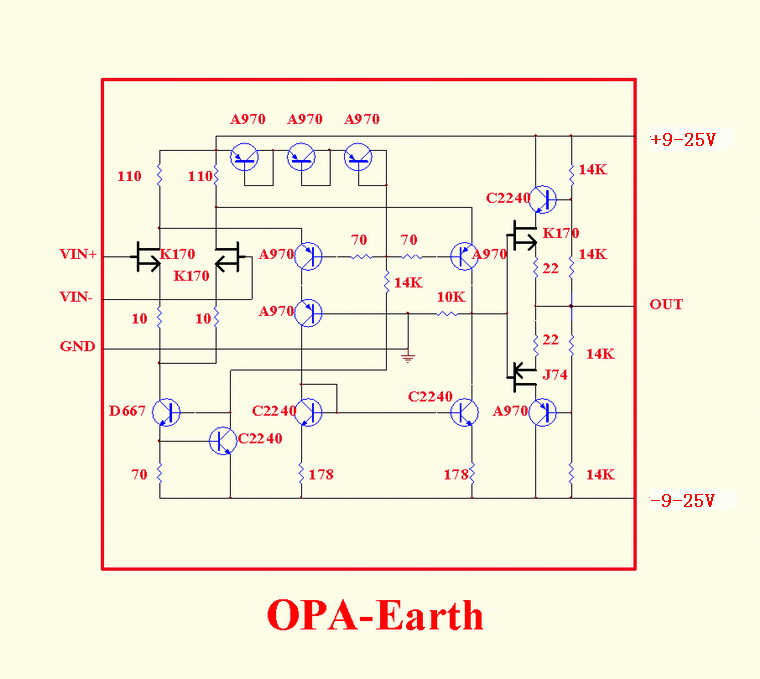

GD-Audio opamps
This is the circuit diagram of GD-Audio's Discrete Opamps OPA-Earth. This is the basic Opamp from GD-Audio and I am using the better design OPA-SUN. Someone said Burson's Opamp has very similar design as OPA-Earth.
see this link for details:
