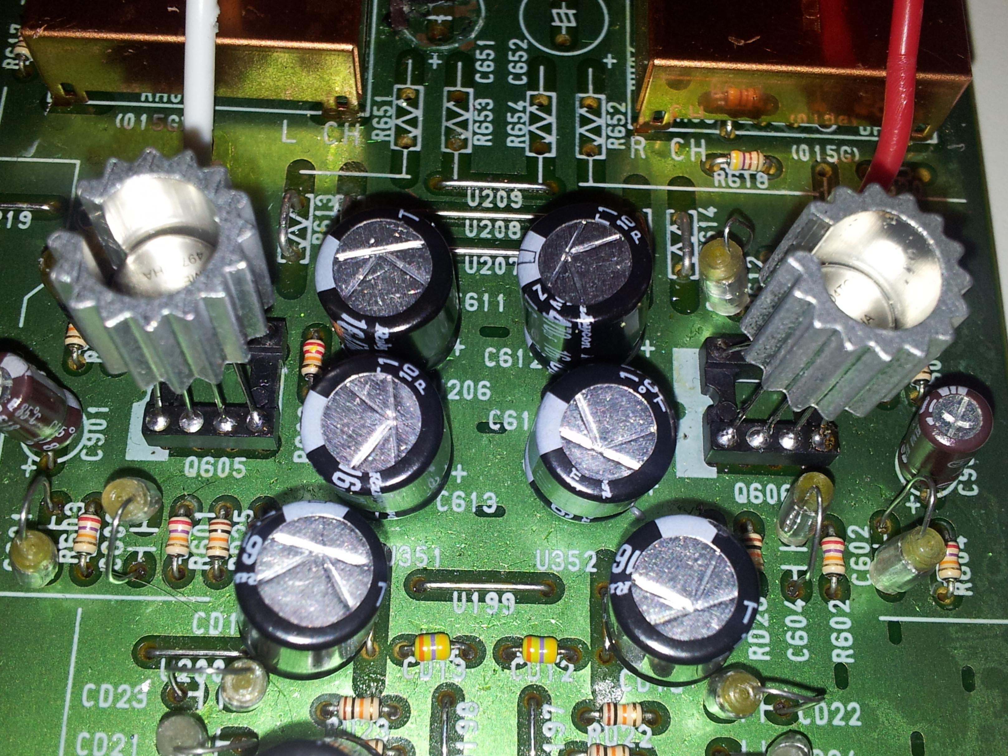

Yes the Metal CAN 49720HA works quite hot and for peace of mind I put a heat sink on it
I followed and put heat sinks on mine.

Why do the metal cans run hotter, this doesn't make sense to me. Heat dissipation should be the same, regardless of the housing.
It could be a sign of high-frequency oscillation, did anyone check the output with a scope?

Unfortunately, I don't have access to a scope.
Quick google search shows that others are reporting high operation heat of the metal cans.
I have 47 ohm in series with the output. That should take care of the capacitive load from the interconnects.
Could it be oscillation elsewhere?
I have checked with a scope and there is no oscillation at all. The metal can is hot but I think it is only about 50 degree C without heat sink. I put another pair of metal can to the circuit and they also got the same temp. I think the heat is normal. I also found the non metal 4562NA is also "hot" after running for some time
