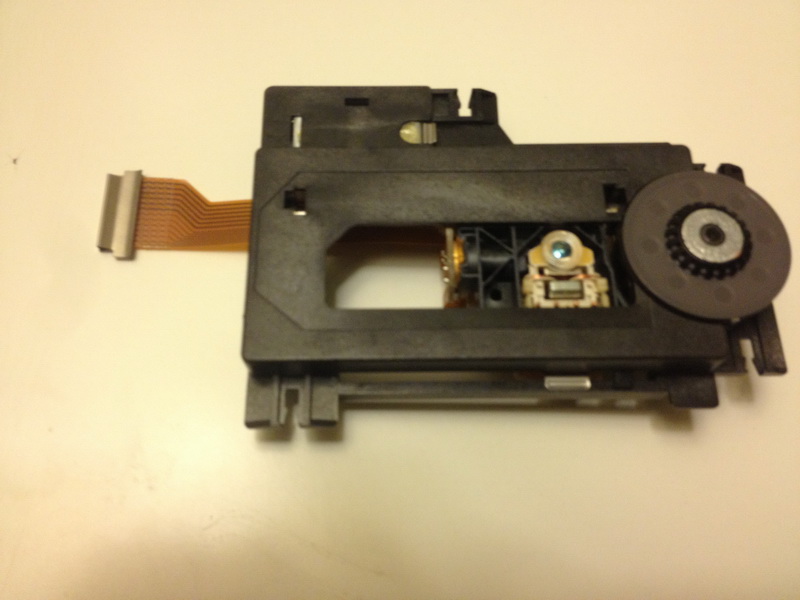

Just been looking at CD transports for CD63/67, and on one site it mentions that before installation you must "remove protection points",
Is there something that should be removed on the laser assembly before trying to use?
Yes, small metal clip on the end of cable on the left.
Only the one on the ribbon cable then, nothing on the laser assembly itself?
Nothing else.
