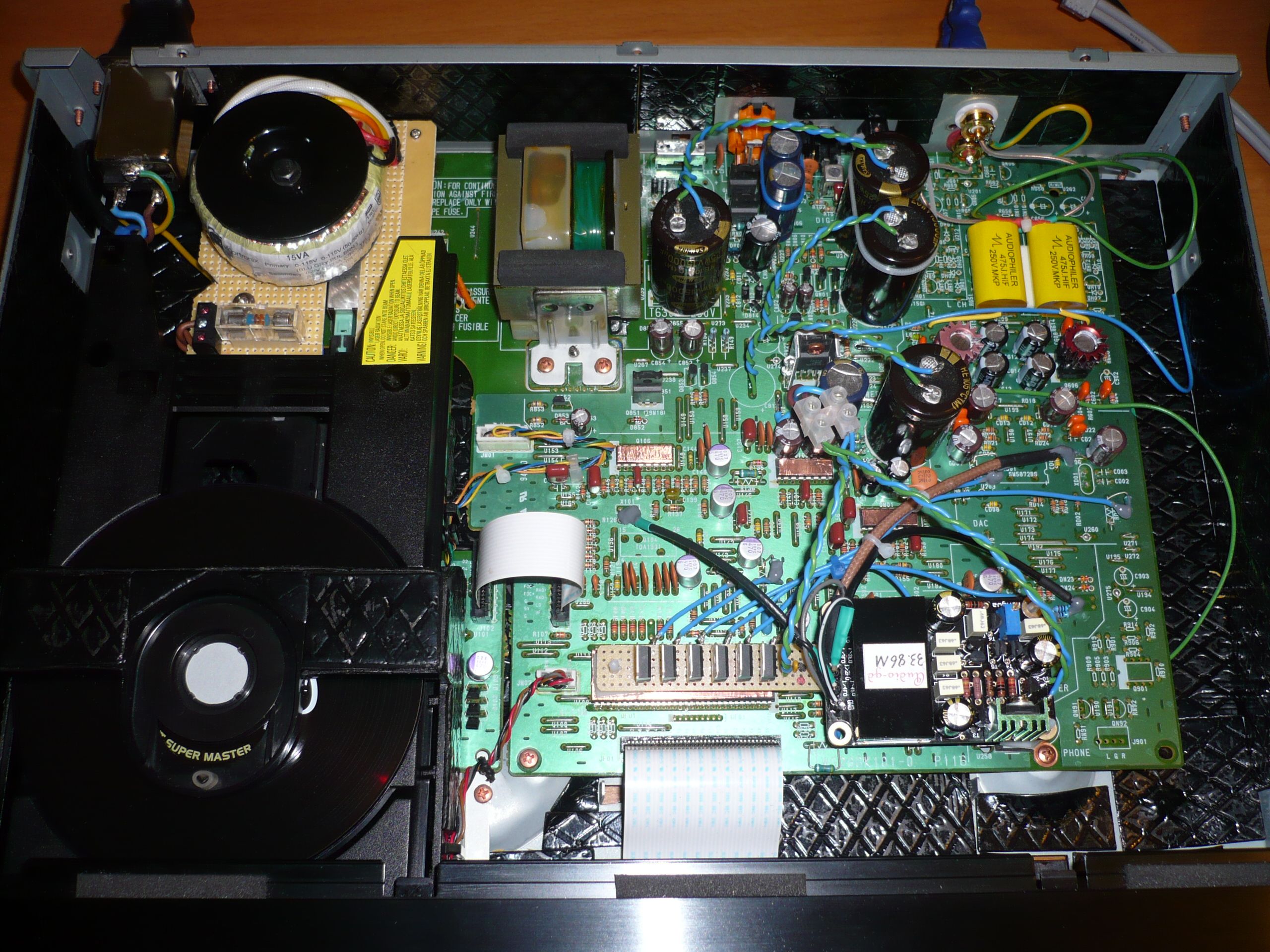

8th CD63 modding project complete
The muting relay arrived yesterday morning and I have just installed it onto the CD63 (the relay is at the bottom left hand corner of the attached photo). Now my 8th CD63 modding project is complete and my friend will pick this up in the weekend 😉

Thanks for sharing Highlander.
I have a few questions for you :
- What do you use to shield the ICs ? I've searched farnell, but didnot find anything that seems ok.
- What type of coax cable do you use ? There's so many ref on farnell, I'm lost, I have no idea what to choose.
- Which ref are the RCA socket you put ? I've found many different ones at various prices, and I wonder how much is worth to be spent on this. With the idea in mind, that I would also add the same pair on my amp.
- Last one, what kind of cable (again, ref if possible 😛 ) do you use between RCA socket and the pcb ?
- The shields are copper foil like this:
http://www.ebay.co.uk/itm/EMI-COPPE...?pt=UK_Sound_Vision_Other&hash=item43bbb4fef6
- I use small sized HF coaxial cable for wifi like this:
http://www.ebay.co.uk/itm/RG316-Coa...osters_Extenders_Antennas&hash=item45fcaa5a87
- RCA sockets are CMC gold plate sockets like this:
CMC Nickel Free Gold Plate RCA Socket 2 pairs/4 pcs | eBay
-for internal connections I use pure OCC copper wires like this:
Pure Stranded UP - OCC Cyro Treated 7N Copper Wire (per ft) | eBay
