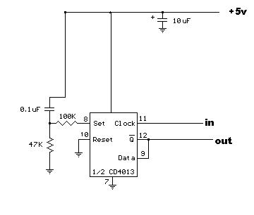

rowemeister said:
Do you have a schematic at hand or do I have to find one myself :) hehe
cheers
HI.
Something like this........................
Power on reset ( SET actually ) is possibly not required.
Use 74HC74 or 74AHC74 not CD4013 - available from Maplins.
Andy
