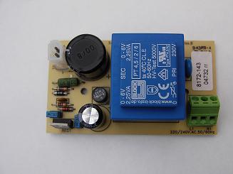

Hi Adfinni,
I bought a load of these PSUs of EBAY. They fit just nicely behind the display panel.
These are as basic as you need :- transformer, rectifier (yes-I know it's a cheap bridge!!), smoothing caps and regulator.
( I have to make a slight mod as these are set to 6v - I will be setting to 9v then using a super-reg to +5v )
Layout is not critical so perf-board will do, if you build one youself.
Maplin also sell a small board for an adjustable psu ( part no. VE58N )- just connect a small transformer ( eg Maplin part WB01B ) and set the volts to +5v.
Andy

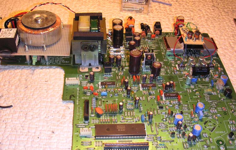

Hi Franz,
Nice job, it's starting to look like a KI already 😀.
What's the PCB floating above the HDAM cans? Some PSU filtering?
Ray.
Ray.
No, this is a simple LC low pass filter (ca. 50kHz/12dB).
All the modifications are according to Gerald Gessner. The audio part consists just 50% of an OPA2134 followed by the LPF.
Franz
Franz

Hi Andy,
I took out the resistors directly at the outputs of the DAC and connected it to Thorstens filter instead. The circuit sounds very good, but I have some HF noise present in my tweeters. I'm now figuring out if it is radiation from my nearby clock PCB, or because the circuit uses only one output and thus it is not cancelled out in some way.
