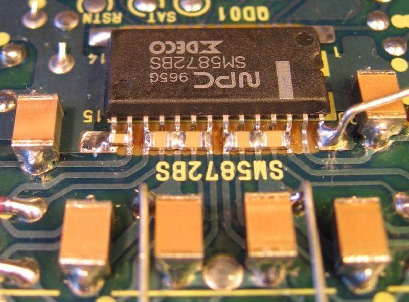

avr300 said:Can anyone confirm feeding of the "analog" part of the DAC together with the clock power is a good idea?
/avr300
Hi avr,
The acoustica article shows that the analog supply pins are more like digital pins, considering all the PWM noise that must come OUT of these pins. That's why they insert the extra caps directly across the DAC pins. I would recommend feeding these pins off a separate 5V regulator, not together with the digital or clock supply.
Ray.
Ray,
What is the spec / type for the smt caps?
It looks such a neat job, I think I will have a go myself.
Andy
Andy
I think I'll try the clock hack again with the LM317 reg. off C813, this time I'll only feed VXDD and leave U200 on it's own 5V.
Sure, PWM is noisy.
/avr300
Sure, PWM is noisy.
/avr300

poynton said:Ray,
Andy
Hi Andy,
You mean the big ones or the small ones? 😀.
The smallest one sits between pins 15 and 16 (DVdd and ground) and that's a 100n X7R in a 0603 case.
The other four are also 100n X7R and 0805 case size. I first soldered them to the outer pins (17, 21, 22, 26) and then joined them in the center to ground. If you center their position they overlap the other pins nicely.
The six biggest ones are 100n PPS in a 1913 case and they replace the 47n ceramics.
If you use a fine soldering tip and not too high temp it's not that hard. Some thin soldering wire (0,5mm) can be helpful too.
Ray.
