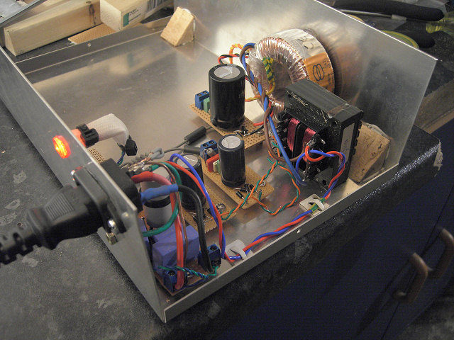

Evening all.

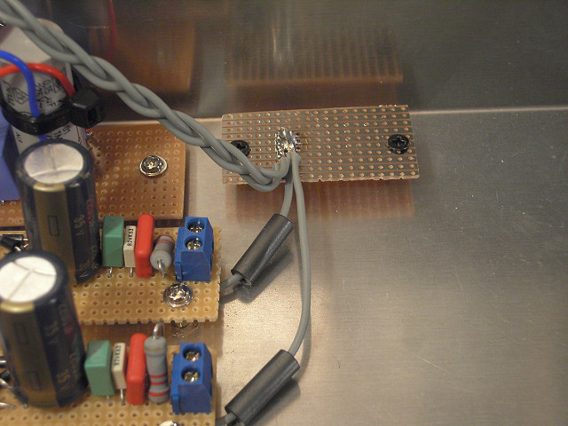

I decided to get my external psu back into the workshop this evening as there was excessive noise on the cd's output. I added a star earth point and wired it to house earth. This reduced the noise to an acceptable level (more to do soon) but had the happy side effect of doubling the perceived improvement of the mod. I had to trawl through 5 or 6 CDs revelling in the awesome bass and beguiling, detailed sound.
The braided wire is connected to the earth pin of the IEC socket. You can see I added ferrites to the earth leads to minimise any HF noise polluting the earth (who knows!?)
Spurred on by not breaking anything, but quite the opposite, I decided to add another transformer (15v@1a x2 toroid) and psu (schottkies, 15,000uF Rubycon, 1uF polyester). This feeds my 5v reg board (was fed from 20v in the player). (The 5v board has 1000uF Black Gate and then 33uF Pana FC after each reg (analogue dac/decoder, digital dac/decoder, and other 5v (err, what is it??) same as before)
I also popped in a red neon I had lying around, to warn me that it's on, as there was no other indication (apart from a quiet hummm close-up).
I've only had a quick listen since this mod but listening to Dire Straits, Dire Straits the result is surely a good imrovement. Mark Knopfler's voice has never had this kind of fully develpoped character before. Each part is easy to follow and well rounded. Yet again, upgrading power supplies in this thing proves to work!
(I can hear a high pitched whine now, which probably wasn't there at switch on - perhaps something is marginally stable or something??)
Simon
Simon

After some SMD surgery they are now +/-12V 😀. I'm going to put some three-pin sockets on the PCB so I can swap regulators easily. I'll let you know what I find, but it may take some time
Simon,
Nice work, seems the separate PSU's really pays off. You still have room in there for a lot more trannys
Ray

rowemeister said:
Good stuff mate. Only one thing to pull you up onNEON = noisy 🙁
I would change it for an LED.
Brent
Yeh I did wonder but it's far easier to use a neon and it shows that mains is in there. An LED would only be lit if the power had gone through a tx etc. (unless I did a dodgy connection straight through a resistor and diode)..
I am toying with the idea of having an LED (purple!) for each power rail
SimontY said:
I am toying with the idea of having an LED (purple!) for each power rail![]()
You big gay
Looks good mate, and is pushing me towards building a spearate PSU for my 5V reg board (when my cdp is running again 🙄 )
adfinni said:
You big gay![]()
LOL
I said that on msn to him LMAO
