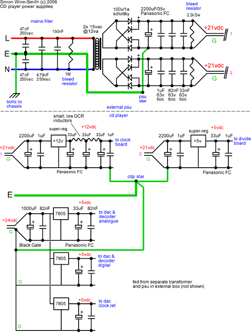

adfinni said:I finished at 12:30am and spent the next hour and a half listening to music 😀
Excellent mate, I'm really happy for you! How does it sound?
Simon
adfinni said:Must have been too much heat from my iron when de-soldering.
Don't leave it in the fire for so long !
poynton said:
One channel or both ??
Possibly a mismatch in the filter after the DAC.
Both channels fairly well equally. I've not touched the DAC or anything near it. The noise only came on after adding the external power supplies for clock and fliplop.
So I presume it can be narrowed down to one of:
1 - a grounding problem
2 - noise from reg boards or wiring radiating into a circuit, like op-amps
3 - I've accidentally interfered with clock or divider ccts (I've been careful)
4 - other stuff I'm not clever enough to realise
What do you think?
Simon
rowemeister said:Simon can you post a pic of your pcb/layout and also send me a recording of the noise.
Brent
Yeh, sure thing. I'll ammend my schematic to reflect the exact setup at present, ignoring the latest psu, as that made no difference to the noise levels. Or I could add it anyway with that proviso.
A recording will be a royal pain in the bum but I'll do it if you think it'll help!
What do you think?
Simon
Could be radiation from your clock beating with the 8MHz clock of the uP due to long lead length?
Do you have ferrite beads close to the input/output of the regulators to stop RF ?
Andy
Andy
Nope, I have no beads there but now I have ideas, thanks! I think I have a couple lying around I could use. Also I will try to neaten things a little in the player. The other I'll try is cutting out the bleed resistors, as Brent says they could cause oscillation and he feels they're not necessary. Gimme a couple of hours to get home and I'll perform surgery...

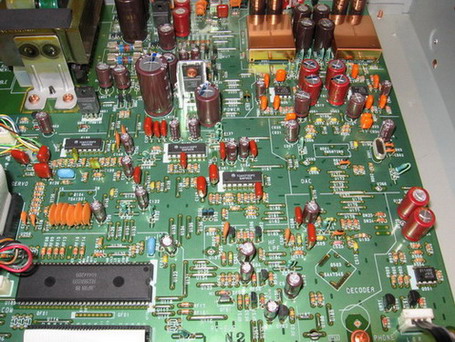

Hallo to everyone!
Here is my modded cd63se:
C805/806 Elna Cerafine 100u/25v instead Elna RA-2 470u/16v
C651~654 (HDAM) Elna Silmic 220u/16v instead Elna RA-2 470u/16v
C903/904 Elna Cerafine 100u/25v instead Elna RA-2 100u/16v and NJM211DD (headphone amp)
C508/134/136/151/152 120pf/50v Film caps instead [the same values] Ceramics (red).
16,9 MHz clock (from a cd67se).
Now the sound is wonderfully musical, smooth, warm and deep.

adinica said:Hallo to everyone!
Good start. Watch out, you could become like the nutters here!
It looks like you missed a couple important and free upgrades:
Replace C656/C658, and C655/C657 with wire jumpers.
Replace the "fuse" resistors sticking up with wire jumpers in the analog output stages: R613,R614,R615,R616 on the opamps, and if you still use the HDAM, R651,R652,R653,R654. Later on, after a bunch of other mods you can fine tune this by using inductors instead of jumpers.
Next most important are the opamps. Simple plug in replacements are the new and inexpensive National Semiconductor LM4562 (Plastic DIP version) that's currently only available as samples direct from NS. These sound far, far, far better than the stock ones.
Hi adinica.
Glad your happy with the sound, but there are much larger gains to be had. Mainly with installing a new dedicated clock pcb (e.g. audicom superclock 2 cheap off ebay ~£50), new op-amps, removing the crappy HDAM when installign the op-amps, and many other.
I would also recommend you read over the mod list seen on teh first page of this huge thread. Rays list is excellent and will help you out a lot.
I would advise that you remove the headphone circuitry as it is pretty poor sounding, and focus on modding the most important circuits 😀
