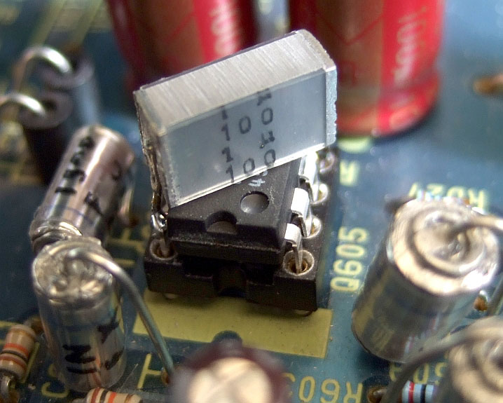

Another thing - if you guys are not adding extra decoupling to these fast op-amps (particularly high BW ones like LM6172, AD826, AD8065/6) you may not be hearing their full potential. Even if they are not oscillating they may burst into damped oscillation (ringing) with the music.
I get great results with ultra-low inductance stacked-film polyester caps across the top of the chip. The Siemens-Epcos ones. The 1uF/100V ones are EXACTLY the right length to fit diagonally across the op-amp needing only a couple of mm of lead. This will guarantee stability of the most unruly of of-amps.

All you need between output of HDAM or op-amp is a series resistor of about 50 - 100 ohm followed by the 100k to ground that is already there. The op-amp or HDAM do not like to see a capacitive load such as your interconnect, and the series resistor isolates the op-amp/HDAM from the interconnect to ensure stability. Robert Noriega (aka 'Bobwire') on AudioAsylum found that when he took the HDAM on his '63 below 20ohms it started to oscillate. I think I used 50 though it may have been 100....
I tried to attach an image in my last post of my decoupling for fast op-amps but it didn't work (too big I think) - I shall try again....
