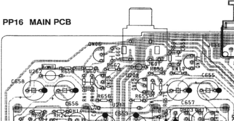

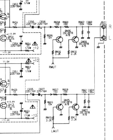

Hi everyone. It's been ages since I dipped my toe in here. My bottom RCA socket is intermittent. I'm sure its where it's soldered into the board. Being really lazy and trying to avoid removing the pcb to solder the back I wondered if anyone can tell me an accessible point on the top of the board, a resistor ect that I can solder a wire link to. I have tried downloading a manual with little success.

The problem seems to me is on the RCA socket itself due to loose contacts but not on the soldering. I suggest you just change the socket for peace of mind. It is dead easy.

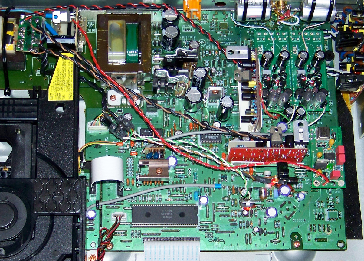

Hi guys!
Trouble brings me back, sadly.
My players started to be unable to play a full disc, I've seen the issue earlier but had not time to fix it.
The flip/flop board I have at driver's IC made this fault when pushed a bit down, kept playing when pulled up. Sounded like a dry joint, so I've redone it yesterday and no luck, the same. Went on pushing gently the onbaord regulator, and fault came & went.
Second work then, removed that flip flop board.
Too messy, I've tried to unsolder and redo it... but that was a hard time, chip got hot, I got tired... back in the player. No more anything, no more focus or turn... I guess no more clock there. And too tight to dare touch it now...
Anyway I wonder if I feed the clock on the right pin, it's on 19 XtalI, resistor and caps removed. I had a 1M smd cap between XtalIn and out (19-18), was it mandatory? It played a bit without since I've lost it...
Can anywone confirm that?
I'm good for a new clock, I don't have time and patience (I've blown my amp and messed with my speakers's XOs also... ) for a new flip flop, so I'll just buy a new clock. Advise anyone? Ray's Flea kit? AudioGD's clock? Another new kid on the block?
Thanks,

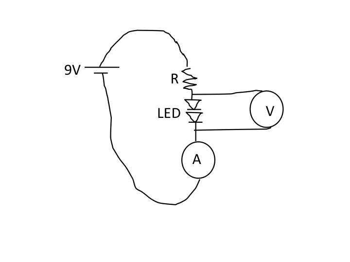

Hi Pete,
I monitored the voltage across the LEDs and monitored the current with a second multimeter (see attached). I used a 9v battery and a range of resistors from 360R to 5.4K. The voltage drop for two green LEDs in series is:
4.6V at 26mA
4.0V at 7.2mA
3.8V at 1.8mA
3.7V at .95mA
Am I doing something wrong? What I need to know is what current range to expect for servo, decoder and dac. I guess I should figure it out from the chip datasheets?

When you use the two diodes to set the 317 output voltage, they are fed from a near-constant current, which is 1.25v/Rset (the resistor between the Vout and Vadj pins sees 1,25 across it). So use a 560 or 680ohm resistor for these LEDs and don't worry about absolute DC voltage - its not important, providing you hit the target +/-5% (i.e. within the fed IC's datasheet tolerance)
NB it turns out there are green leds and green leds, and some newer ones use slightly different forumulation and so have higher dynamic reistance. looks like these are the one you have - but don't worry about it.

Pin 19 is the right pin, so that's not the problem. Have you kept the original resonator? You could put it back and see if that solves the problem. It's probably a broken track or some other bad connection.

sadly the OEM cristal is long gone. And yes sounded like a solder joint but on my flip flop wich I admit was badly done at that time. BTW, the Flea and the Tentlabs XO may save me 🙂

if I understand this right, 680ohm will give 1.8mA (1.25/680). So the voltage drop will be about 3.8V according to my tests (post 20610). I'll give it a go!

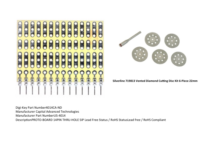

Also, I found these boards at digikey that seem like just the thing for making miniregs. And as I don't have a dremel, these inexpensive cutting discs work really well on my drill to cut them down to size. (I have spent many frustrating hours hacking away at PCBs with various saws and clippers:headbash:). I am careful to avoid the dust.
