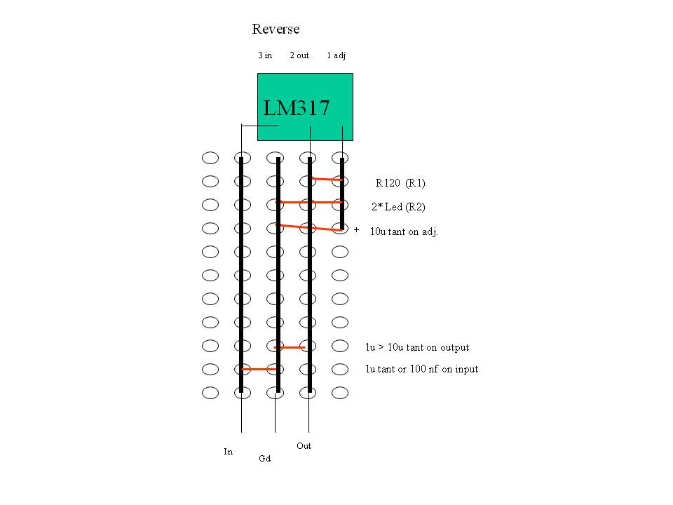

The servo IC regs don't need to be super; just bog standard ones.
I'm personally still only running 'off piste' LM317s on my servo, decoder and DAC ICs. I separated my DAC analogue supplies so I have 4 regs in total, each with their own PSU. I'm not sure about ranking them, but separating the supplies was a big win overall, even with cheapo regs.
If you're itching to throw super regs of some kind in there then I'd probably start with DOS first, followed by DAC analogue. You can always start with LM317s elsewhere and swap them out over time.
I generally just use LM317 with leds or diodes instead of resistors to set the voltage, sometimes with a VBE on the front if I'm feeling adventurous and I don't need a lot of current. Not as good as commercial "superregs" but an awful lot cheaper and a great improvement over stock.
Thanks both for the advice. It is a relief to hear that I can enjoy the benefits of my upgrades without spending £100's on super regs! I can afford to do a lot of regulation with budget LM's. I have been looking at Ray's site but haven't yet figured out how to set the LM's with LEDs. I need to do a bit more research!😀

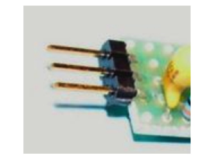

What are the little 3pin adaptors that go on the end of the pcb called? I haven't been able to find them by searching ebay.
Henry
It's for 5v (though could be for other dependant on the number of/colour of the leds used).
the 2 leds are in series, using leds with a forward voltage of around 1.8/1.9 will give you near enough to 5v. If you want to be anal about it you can measure the forward voltage on each led to get an exact 5v, I'm normally happy with anything from 4.8 to 5.2 as they're within normal tolerances for a 5v device.
Pete
