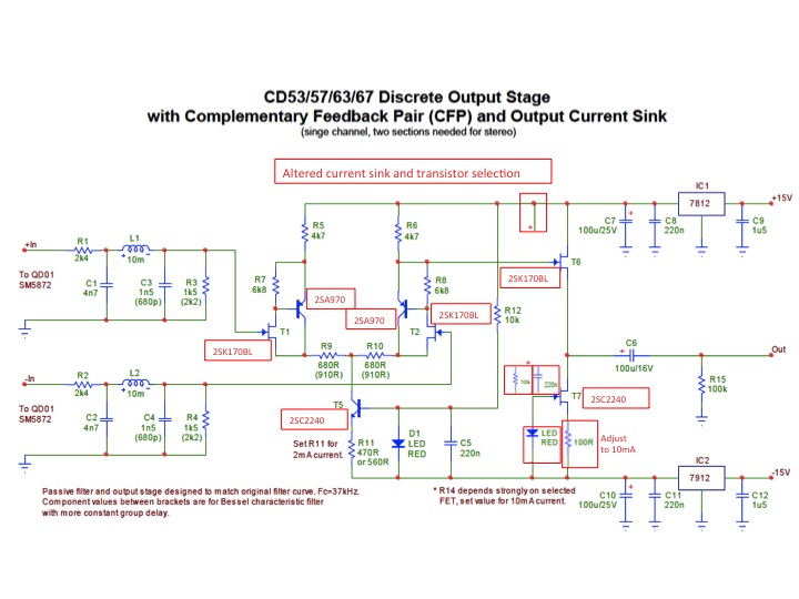

T1,2,6: 2SK170BL, T3,4: 2SA970, T5,7: 2SC2240.
And Ray suggests a current sink configuration: "replace the 100R resistor (R13) by a LED and insert a 10k resistor from the LED's anode to the +12V. R14 sets the current, it should be around 100R for 10mA to flow through the output buffer."
Have I got this right?

So the schematic is good? 😀The current-sink should work if you use a NPN transistor for T7, just like T5.
Yes 🙂
You could add another 220n capacitor, just like C5.

No... not like that! Put the cap in parallel to the LED! You have to pay attention! ;-)
I think I need a coffee before attempting mods! Here is the corrected schematic. Henry
