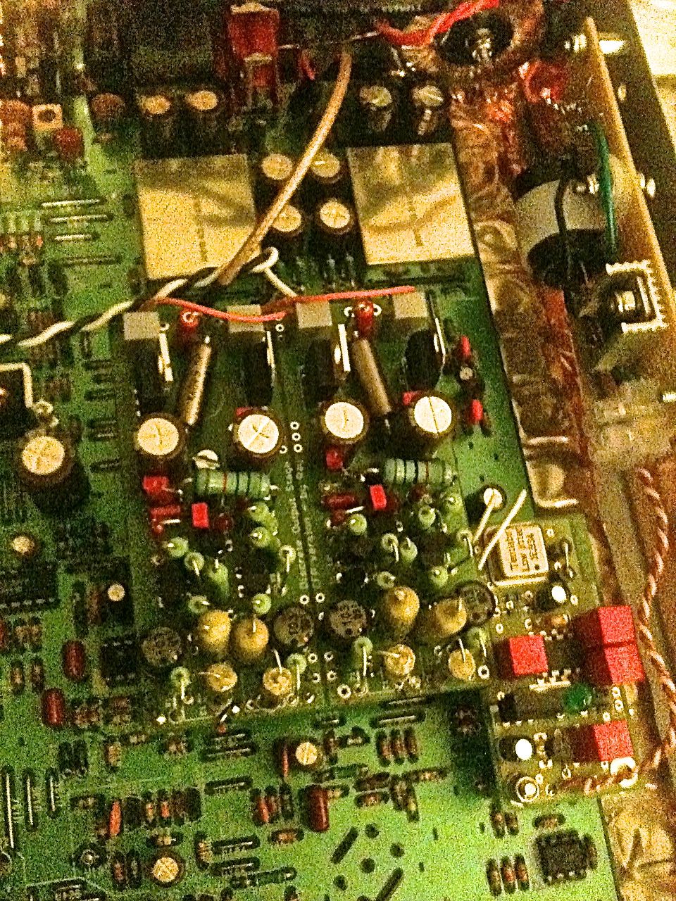

Thanks to Ray and Ben I have hooked up my DOS-CFP board on my CD63, but I am disappointed with the sound: it sounds tinny and non-musical. I just hooked up the left side and left the old analogue on the right side for comparison. The output measured on my scope is about .8V peak to peak (the old output section is about 2V). I took the DOS power from C803/804 (fed by 30VA, 2 X 15V torroid). The voltage measured as it enters the board is -24V/+24V and is 24V between the + and - rails. There is about 4.3V across R5 giving 1.8mA for T3/4. I don't know how to measure the current for T6.
1) Should the output be so low?
2) I have only done the clock and transformers so far - does it just need more modding to bring out the benefits of the DOS CFP?
3) Is there a way to feed a sine wave into the analogue sections for direct comparison of the outputs (record a CD with different tones)?
Henry

Theye are small Russian PIO caps:Hi Henry, what are those blocking caps? They look rather small...

Try shorting them out (as long as your pre-amp has DC blocking on its input, otherwise replace.) You need a value 600+ times larger to avoid low frequency roll-off.
2.2uF is probably the minimum, better still 3.3uF

Ouch - now I see what you mean by small!! I was thinking they were 3.3uF - but they are 3.3nf instead. I wonder how I have managed so far...
I agree. The input impedance is 25Kohms - so 3.3uF would be good. There is no DC blocking on the amp.Try shorting them out (as long as your pre-amp has DC blocking on its input, otherwise replace.) You need a value 600+ times larger to avoid low frequency roll-off.
Yes, it's a factor 1000 too small 😱 No wonder it sounds a bit thin 😉
Well you have done alright so far, the board is working and should be fine if you change the caps.
Ray
Thanks Ray, I put in 100uF similics and the DOS-CFP is now working nicely. I am thinking of replacing them with Mcap EVO Aluminium Oil Capacitors 3.3uf. I haven't have time to compare to the old analogue but will this afternoon.
