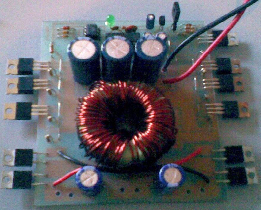

Hi LUKA
I am using 35X14X7mmToroid core (winding Pri:5x5 Sec:15x15) for my 2X120W car amp, So is it sufficient or need to big core size than what core size and winding. My smps Freq:50khz and O/P Voltage 45Volts dual
Best Regards
Best Regards
hey redhorseaudio
For so small amp you really don't need big core, but what I wozld chech is your transformer ratio. Even if your smps will be unregulated, and car voltage is 14.4v you will not get 45v per rail...not to say what would be if loaded by amp

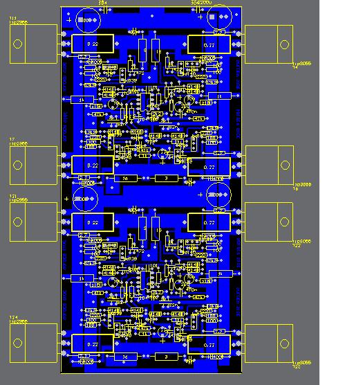

amplifier schematic
hello!!!
i'm sorry for my bad English.
I built a smps from the site of valveaudio and I also realize the power amplifier.
someone has the amplifier design?
thanks
hello!!!
thanks

Hi luka.
as you say that my core have 7*7=49 cross section.
so my smps can with cross section 49 and 44mm diameter of toroid core handle that high current of my 2channel amp?
my amps have +/-47 V and 6a per rail.total power is about 564W.
can that 44mm toroid core handle this power?
but are you sure it is 49? coz that is not 7^2, it can be any 2 numbers, say 7 x 9mm...
my guess is it woun't be, but since this is for amp, you won't need 500w supply... best way is to try and see or just oversize core

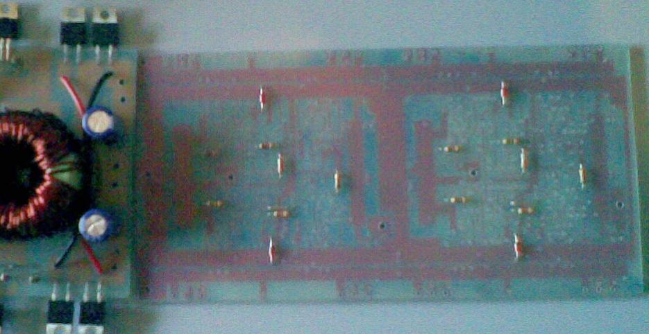

hello!!!!
This is the project I'm making the amplifier.
The first design is the SMPS + / - 30V
I have built and it works very well
