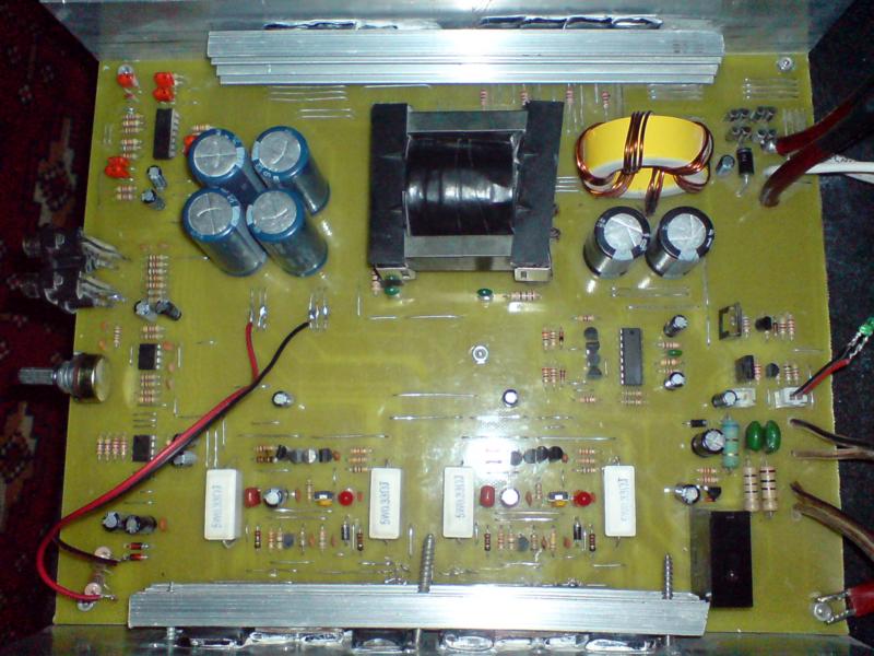

Hi,I have founded the problem.the problem was in primary wires,for firs test when i connect it to supply the primary wires connect to secondary wires because i no covering between wires,when i remove the wires i see thet core is broken,now i use etd49 core,i don't think that ferrite core with 4.4cm diameter can handle this(560w)power.is'nt it?,whereas etd 49 can handle 640VA at 50KHZ.in my circuit rt is 15K and ct is 1nF.it's mean internal freg of TL494 is about 66KHZ and out freq will be 33KHZ.is this right?

do you accept my design luka?(bord design ans placment the components)

You are one of few people that has everything on one board and just by that I like it very much. It looks clean and simple, easy to see where is what,very good all in all design!milad-k800 said:do you accept my design luka?(bord design ans placment the components)

Sweet, it is looking very good, still can't believe you put all on one board, love it!! Does everything work, enough power?
it is like us to use, just one that goes on like that, most of the times used like that, no paste was use

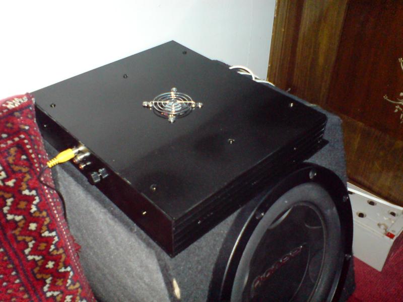

though i have finished my car amplifier,but yet i have no answered question about transformer of switching....

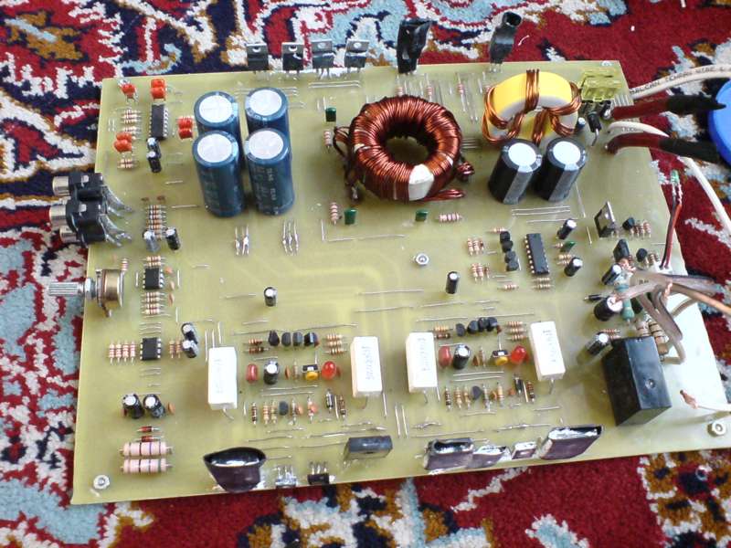

milad-k800 said:this is finally board again with toroid core.I remove ETD49 and again use toroid.with ETD works well...

Your pcb design is too big friend if you design manualy than its good but used pcb cad than very bad, Now look at size of only amp pcb(mono) its on process but compliting very soon with smps which is olso same size
for finally design we must design pcb with good space to apart hot parts like power transistors power resistors and....
your pcb is good and needs little space but for more duty cycle and high performance designer must try to regard all things for finally board.
