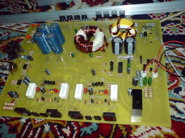

problem with toroid core
hi to all...
i want to help me by luka and pery...
I have finished 2 project of my car amplifier
last project builded with ETD core and current project works with toroid core.
but now I have mistake with yhis core.here is some information of my design:
output voltage at 13.8 volt is +/-47.5 at 6A
core diameter is 44mm outter and 30mm inner
pri winding:5-5(5of1.15mmwires)
sec winding:17-17(3of0.8mmwires)
freq is 33khz
the core and wires gets hot under little load
can this core handle this power that i want?
please help me.
this is my picture of finished 2 channel car amplifier
Yes like Perry said, core must be the right material, for right application, I have used once some I don't know nothing about, and it got really hot at idle, coz of wrong material. Current draw should be pretty small <<5A.
If your winding is ok, which I assume it is or current draw would be huge now.
After you find this out, we will see where to go from here on
