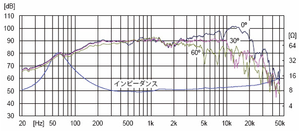

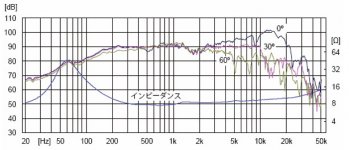

I agree with Chris - the FE108Sol looks like a mighty fine driver with nearly flat response out to 10khz at 30 degrees off-axis. Very similar, but smoother, general response compared to the FE103Sol - I own them and they are one of my favorite full range drivers.
Left to right are the FR's of the FE126En, FE108-Sol and Peerless NE123W-08. The FE108 and Peerless are very similar on axis, but the Peerless is 2/3 cost and handles more power.
