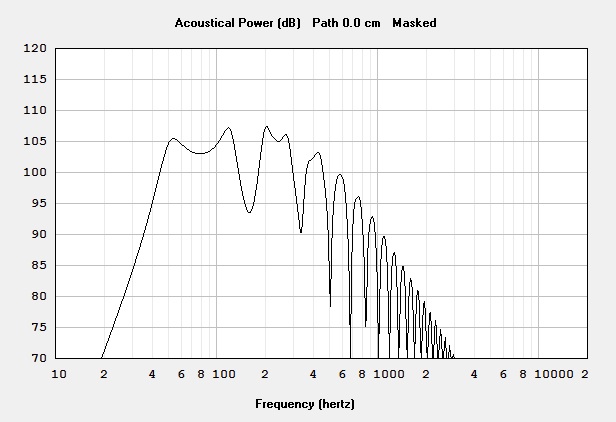

I would like to ask experienced designers from this forum if it is possible to create a asymmetric BLH horn with two mouths ( something like Saburo ) but with different internal lengths so that their summed acoustic output response compensate each other and possibly improve frequency response with less ripples in the output.
I draw a possible response in the second picture without any calculation, just an idea on the paper. Red lines would be a shorter horn mouth response with higher cut-off than the black line with lower cut-off and all from the same driver and compression chamber.
I don't have any computer program or skills to help myself in calculating actual response, just would like to know what you people think about it?

Indeed you can. Variations of that have been done for years, on & off. Although a lot of that in practice is significantly attenuated due to the folding scheme configuration etc.

As presented, you'll need two separate horn systems unless you make it a tapped horn, which is strictly a 2-2.5 octave device depending on the driver's specs, desired peak power handling.
Multiple mismatched BLHs with a common driver will be tuned to ~ the mean of the two same as with multiple different length vents since that's what a [BL] horn is, so if one is tuned to 40 Hz and the other at 60 Hz its tuning will give a bit broader [lower Q] band tuning centered at ~ [40*60]^0.5 = ~49 Hz.
Of course, the room can 'make or break' how well it performs, not mention could conceivably damage the driver due to uneven loading 'swings', so must be factored into the design for best overall performance.
