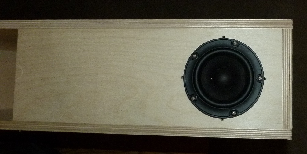

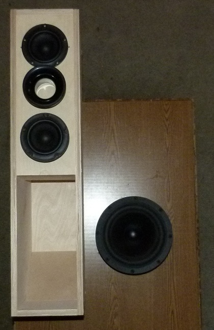

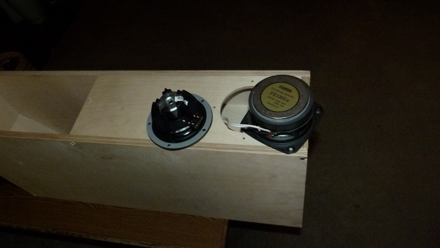

At 123mm, the Peerless driver wasn't a perfect fit in the front panel. The hole was meant for the 126mm Fostek driver. I'll have to make a new one. Which brings up a question. Should I start a new thread?
I just listened to the Peerless unit. WAY more bass at a sacrifice of midrange. Top end was just ok... I swear the bass notes were sub 100Hz. Using an AudioSource Amp3, no EQ. Didn't sound as distorted as the Fostek at louder volumes either. Something lacking in the midrange though. Will have to listen to more tracks, but I'm excited! Maybe needs 2 Peerless, enclosed + an 8" opposing side-firing subwoofers?

Seems reasonable since the Peerless is a poor substitute published specs wise, which must be reasonably accurate judging by how it sounds to you, so needs a BLH design of its own that will allow the mids to open up/'breathe' as much as they're designed to do.
To compare the driver's mids/HF 'good enough' to determine if they will please, stick them in a corner of a well stuffed sofa, chair or just in a 'bed' of pillows there or in a room corner. If room, etc., layout permits, a good way to enjoy them during break-in too.
Just looking at published responses though, the Fostex 'wins' unless a short waveguide [WG] is added to 'plump up' the Peerless's broadband dip in its critical HF BW. Its 'deep dish' cone profile keeps me from wanting to use it 'full-range' as-is.

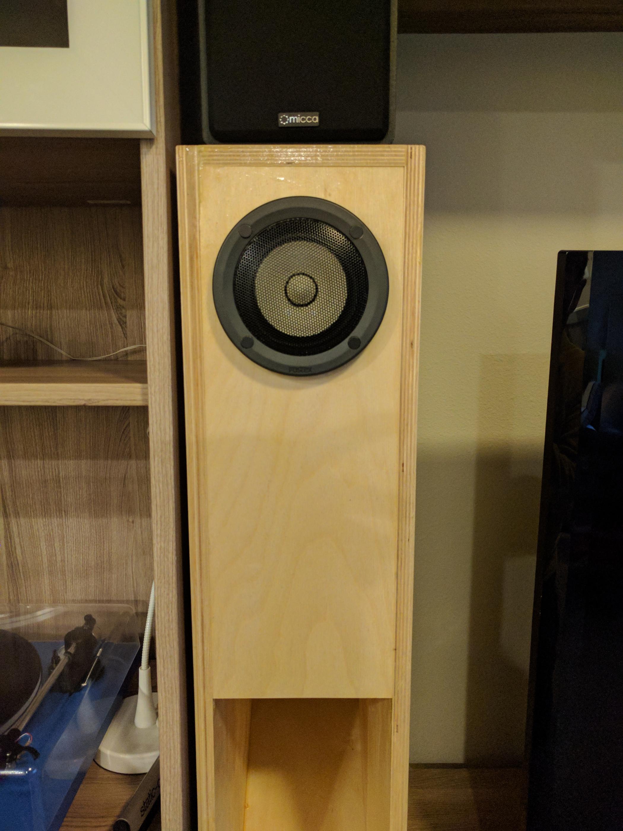

Today I listened to the boxes again with the Peerless drivers. I am really impressed. I'm not going to modify the boxes. I bought 4 Peerless drivers expecting mods. But I think I'll buy 2 more empty BK12m boxes from madisound and build identical units and then try placing them in different areas for an even wider sound.

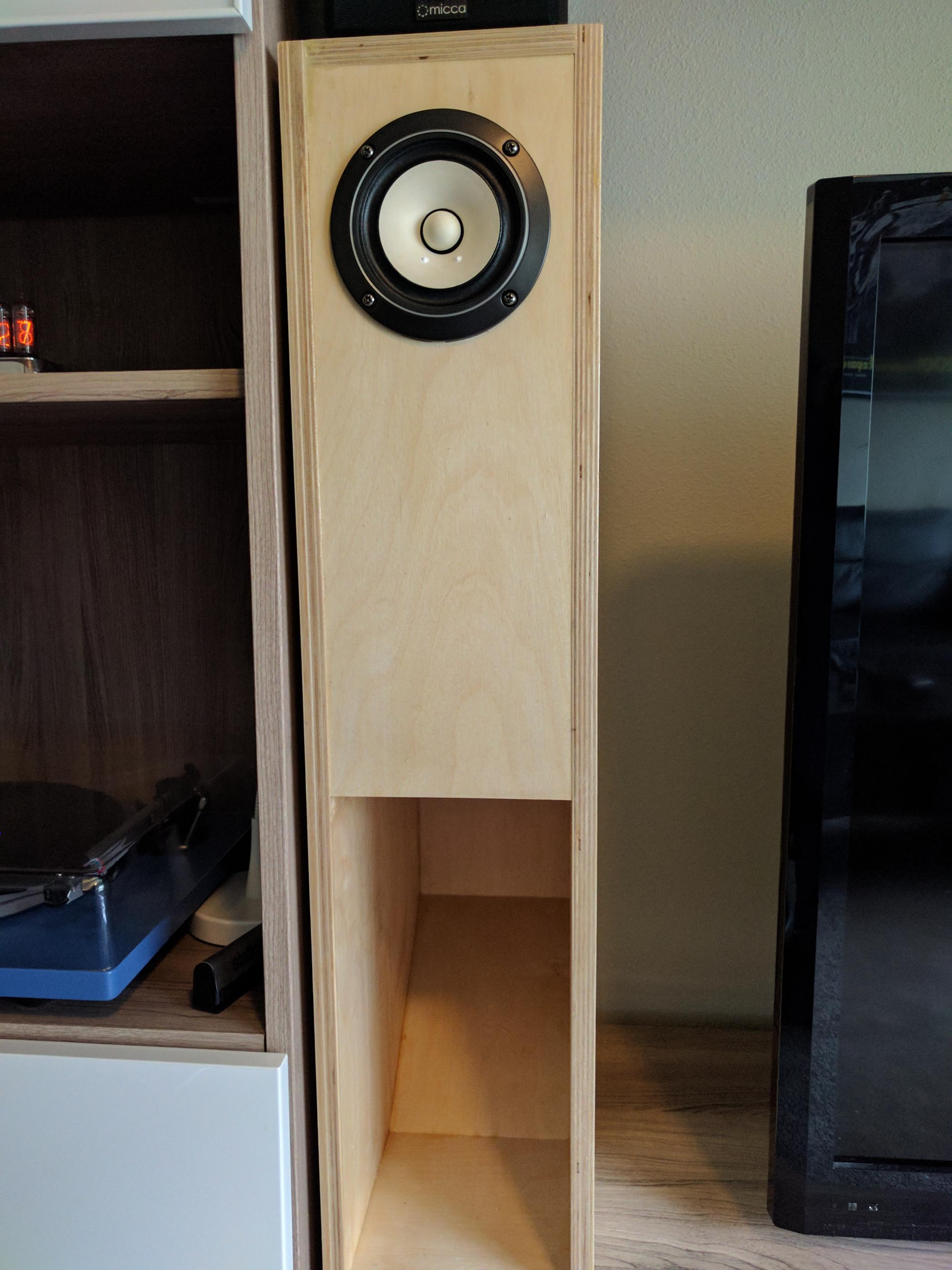

I just finished my build of the BK-12m speaker kit, with the Fostex FE108SOL drivers as a substitute. I chose the FE108SOL for three reasons:
Construction
The provided instructions were mostly accurate and complete. Building the kit was relatively easy, following the instructions precisely. I did run into a couple of build issues:
- I thought that the flatter response curve, as well as the purported lower range might make for a better sound than the standard FE126ENs
- I like the idea of having a “limited edition” driver. It makes the speaker a bit more of a conversation piece.
- I think the circle on rectangle shape is more aesthetically pleasing than the square on square, but that’s strictly picking nits.
Construction
- The instructions call for 5 clamps, of two lengths, 24 and 36 inches. After a small gap on the first speaker, I realized a sixth clamp was needed, thought it need only be 12 inches. In at least one step, the instructions called for clamping one edge with a single clamp, when clamping two corners of the edge were really necessary for a sure fit.
- The circular edge of the FE108SOL drivers meant that the holes drilled passed through the beveled edge the driver is installed in. Although I don’t believe there is reason to suspect this will have either sonic or structural effect, the shape of the FE126EN drivers would not have this issue. Were I to purchase this kit again, I would probably choose the standard drivers.

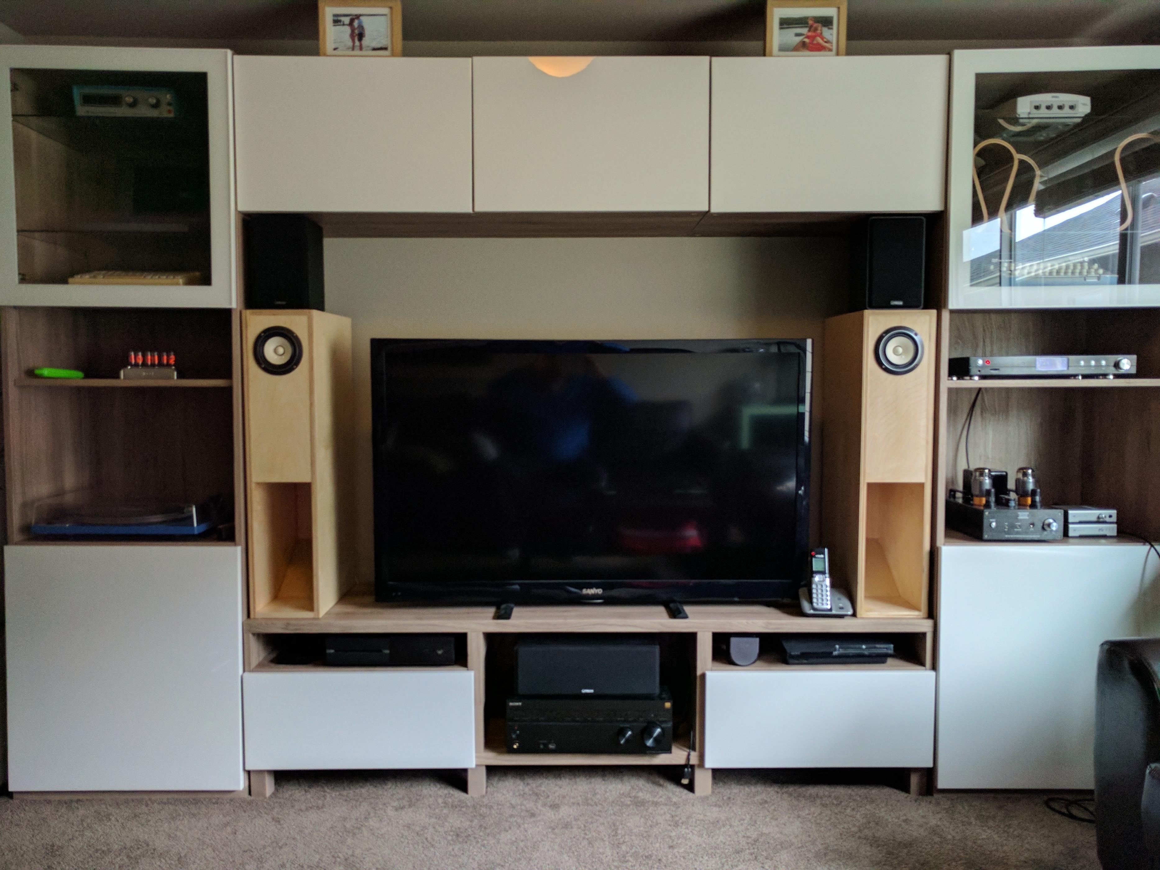

I am driving these speakers with the Musical Paradise MP-301 Mk3 integrated amplifier. The drive tubes are old stock RCA 6SJ7, while the power tubes are PSVANE KT88-T Mark II. The sound source is a Shiit Modi Multibit DAC, with FLAC input.
Previously, I had used my old Energy 22.1 reference class speakers. These are outstanding two-way bookshelf speakers, but were built for a time when high powered solid state amplifiers were the status quo. The MP-301 struggled to drive these speakers, which is why I had swapped in the KT88s. I did a quick A/B speaker comparison with one of my favorite Mazzy Star tracks, and right away, I realized there was no point in the comparison. The two speakers were apples and oranges.
I am very pleased with the result so far, but I’ll need to do a lot more listening, burning in, and tube rolling before I can offer an objective review. My first impression was that this type of speaker is made for low-power tube amps. My second impression was delight, that such a small driver could be coaxed into producing so much sound. I’ll report back again in a few months when I’ve had a chance to form a better opinion.

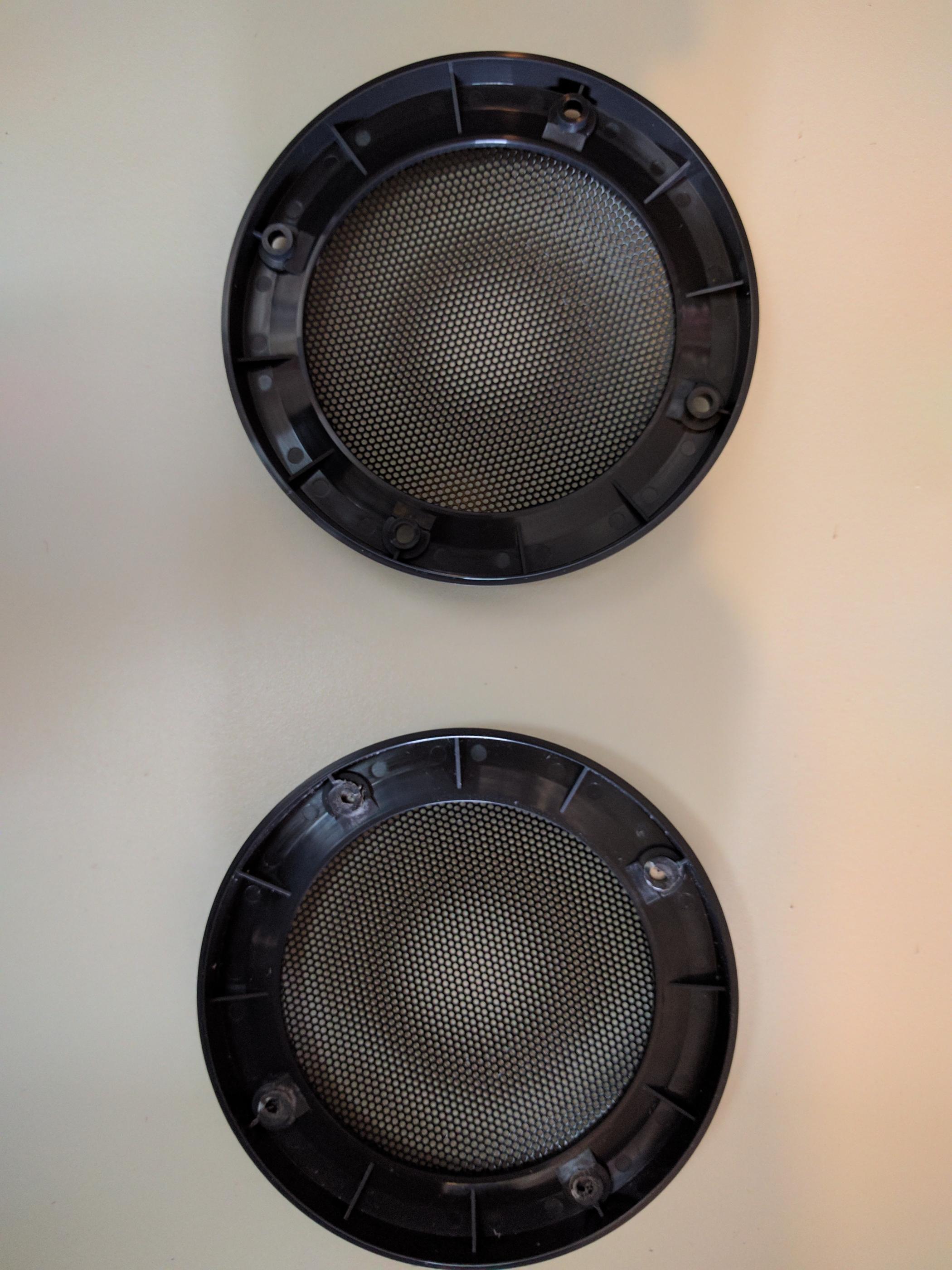

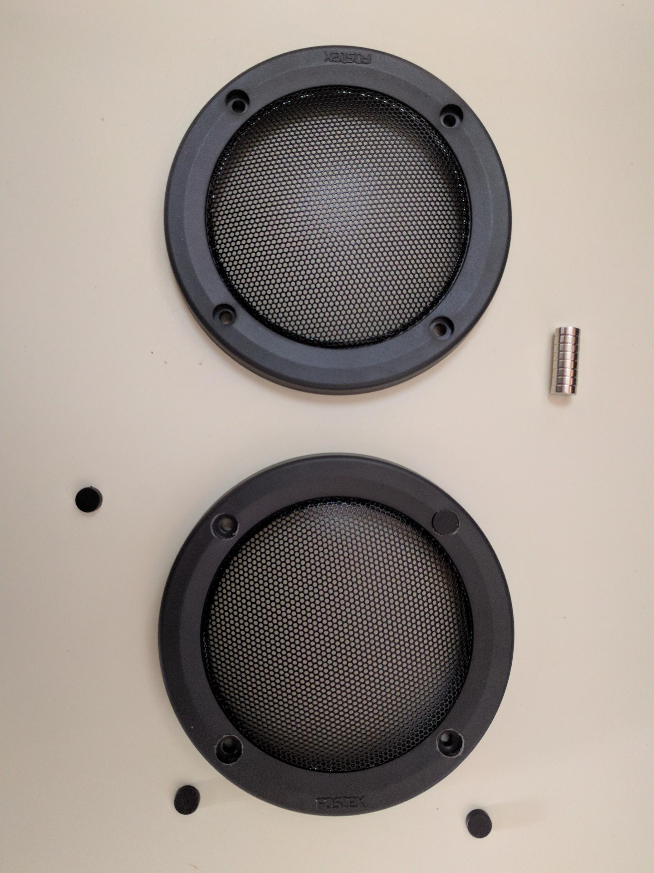

I opted for the matching Fostex KG810 grill covers for the FE108-SOL drivers. I liked the idea of having them magnetically mounted, so I purchased the grill magnets from Madisound. The screw holes in the grills are not large enough to accept the magnets, so I had to drill them out with a 3/8 inch bit. Also, I had to remove the plastic stand-off material at the back of the grills to allow proximity of the magnets to the speaker screws. Finally, I painted the magnets flat black to match the grill color, before press fitting them in.
Not as hideous as I was expecting, and some peace of mind when the curious younglings are visiting.
Good idea with the magnetic grill, and they look pretty good.
