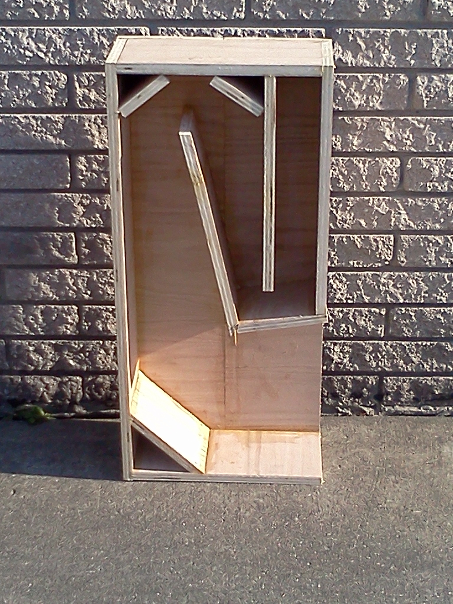

Well here's my first proto build on the BK 12 speaker box. Its almost right? The top corner peices were not cut right and the bottom angle peice is cut a little short but, I wanted to see if I could build this box. It took me a little while but, I got it done. Thanks Scottmoose and Dave. I will be building a fresh pair of these in the next month. N.S.
P.s. I cut the wood using a circular saw and clamps to hold the wood in place. So again not to hard but, it took time . Now if I had a table saw it would have been done asap .

Why don't you just use the speaker box as built? It will work fine. From the sims I see that small differences in angles will not make a huge difference unless it is a throat dimension or channel spacing. It would be a shame to waste that build and all that wood. I think it looks pretty good.

Well you might be right. I think I will keep it and use it as a center channel speaker? I know it would be a shame to waste all that wood. My wife had said the same thing you did about wasting the wood. Also I use 3/4 of a inch not 5/8's of a inch as it has said in the plans. Well again thanks for the encourgement. N.S.

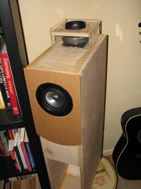

Here is a photo of my "experiment" in the rough mock up stage. I have a super tweeter in parallel w/ a 0.66 uf 250v cap to tone it down to my liking. This setup, along with the baffle, make for a nice listening experience.
Again...the Alpair 7 drivers are wonderful.

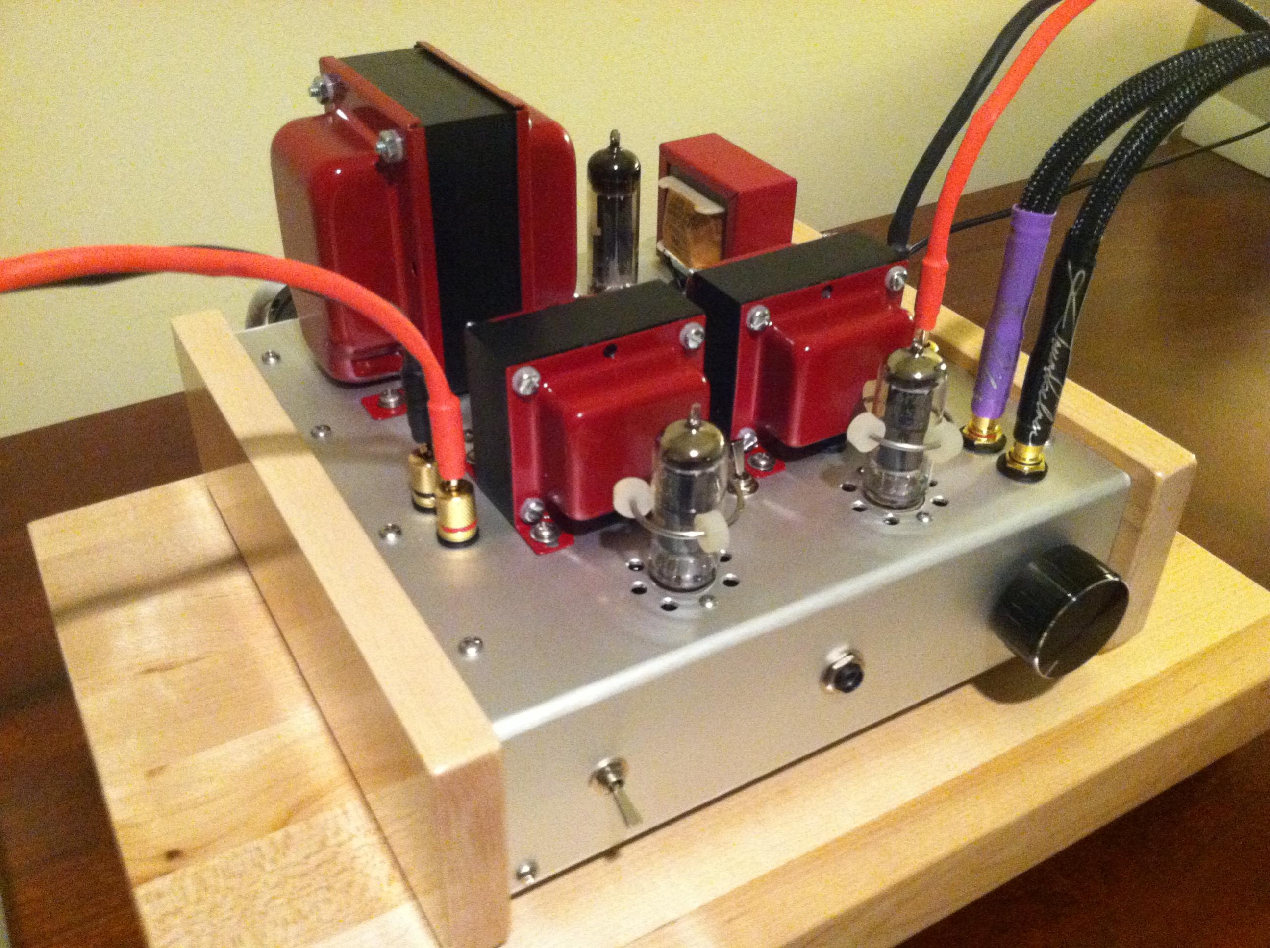

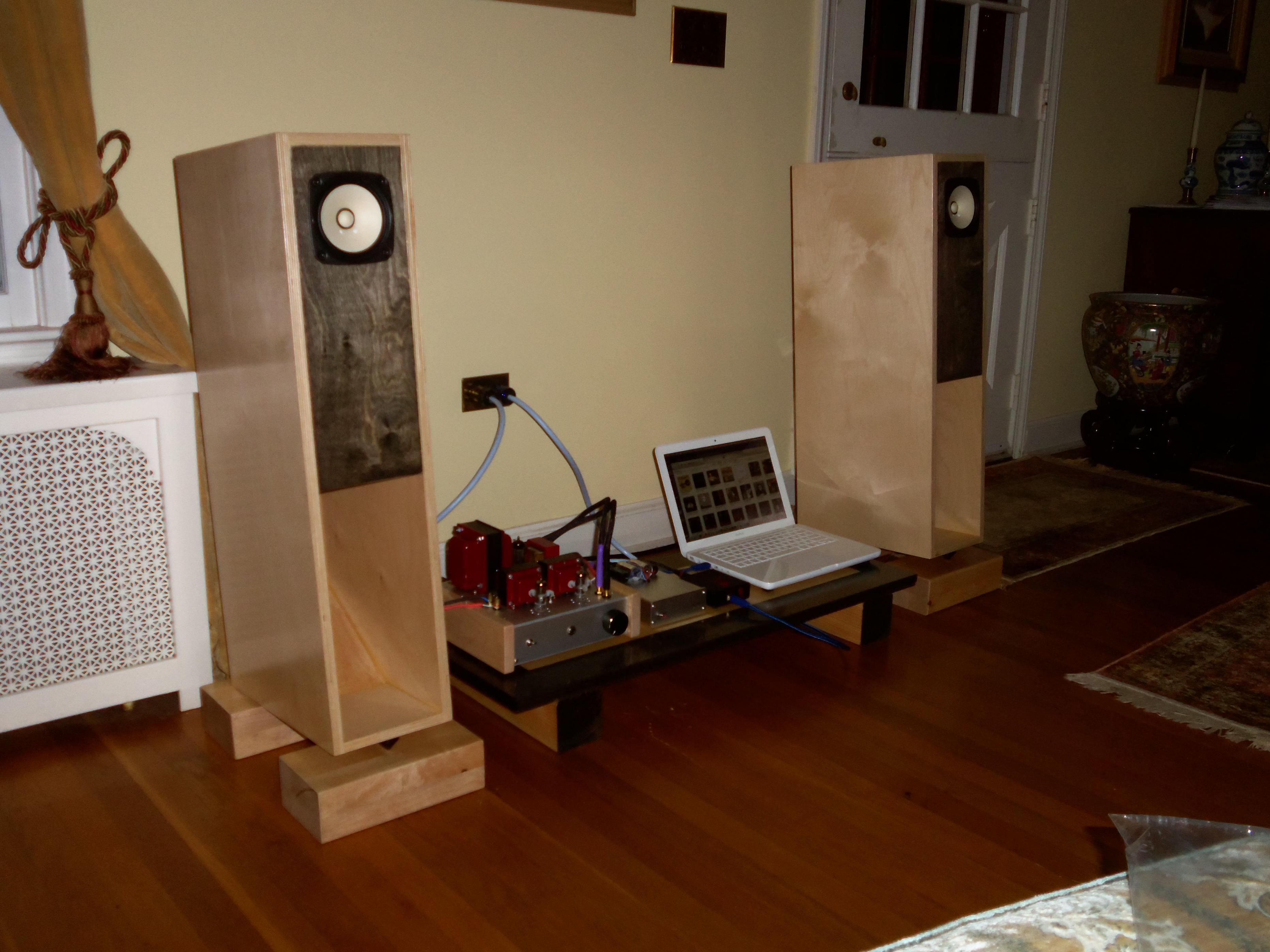

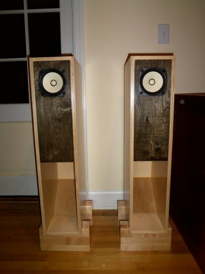

They're finally done.....
...... and this 6197 SEP ( 2.8 watts ) amp will drive them .
Thanks guys ! It took me more than I anticipated to build them since my cabinet making skills are pretty limited . I did not rush, took my time & followed step by step instructions .Very pleased the way they came out.

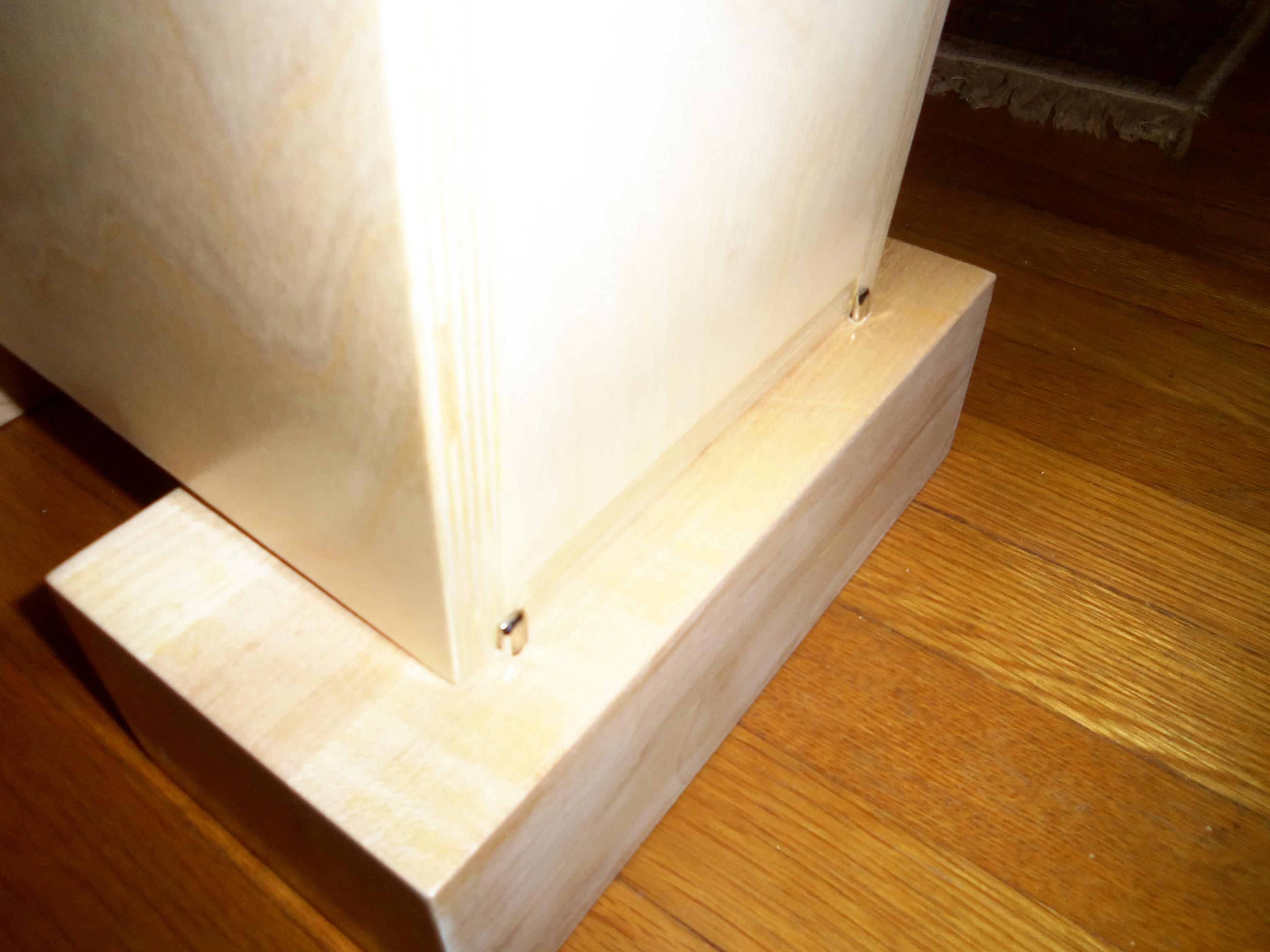

These are 3" thick maple butcher blocks 10"w x 5"h.

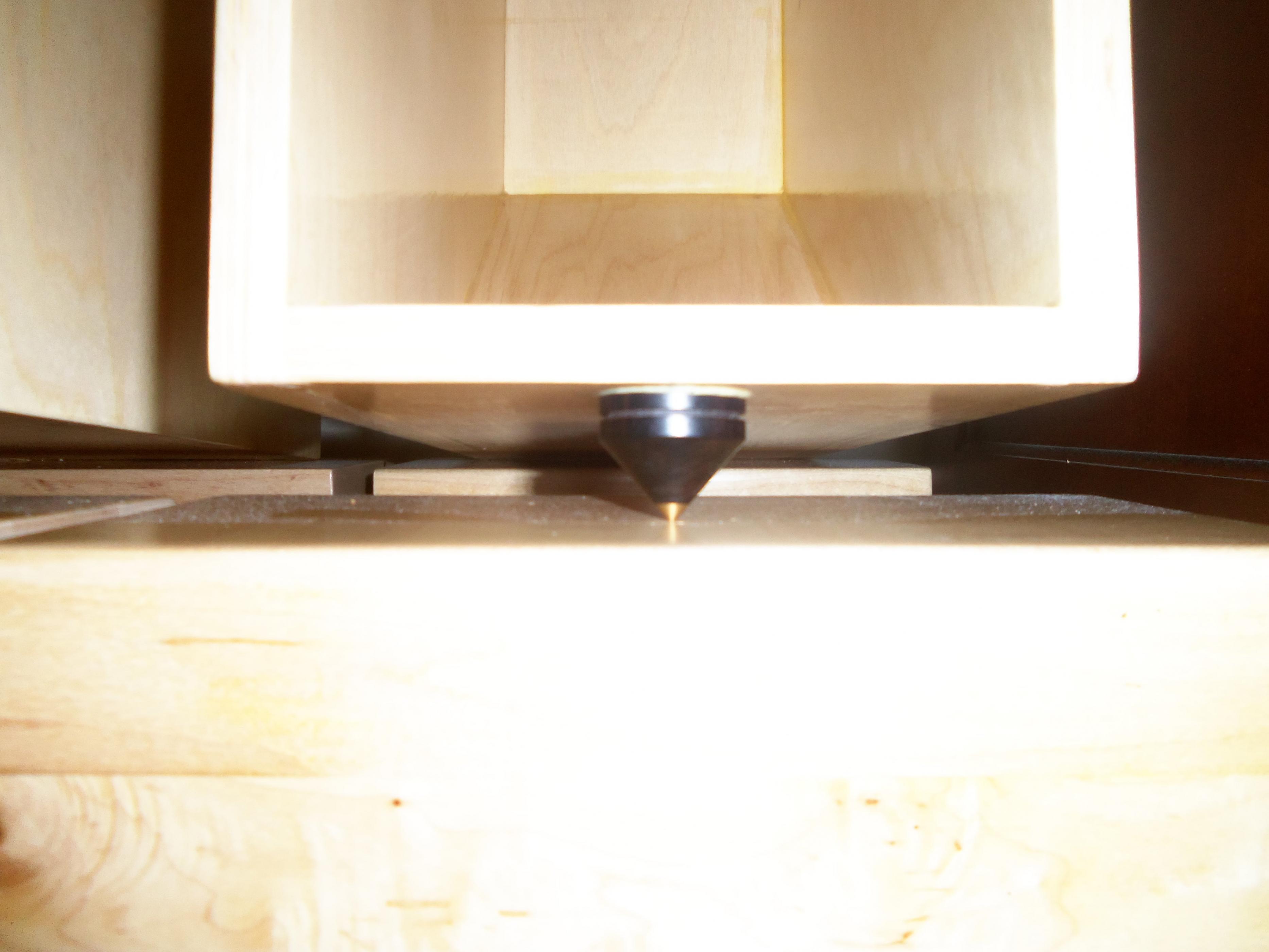

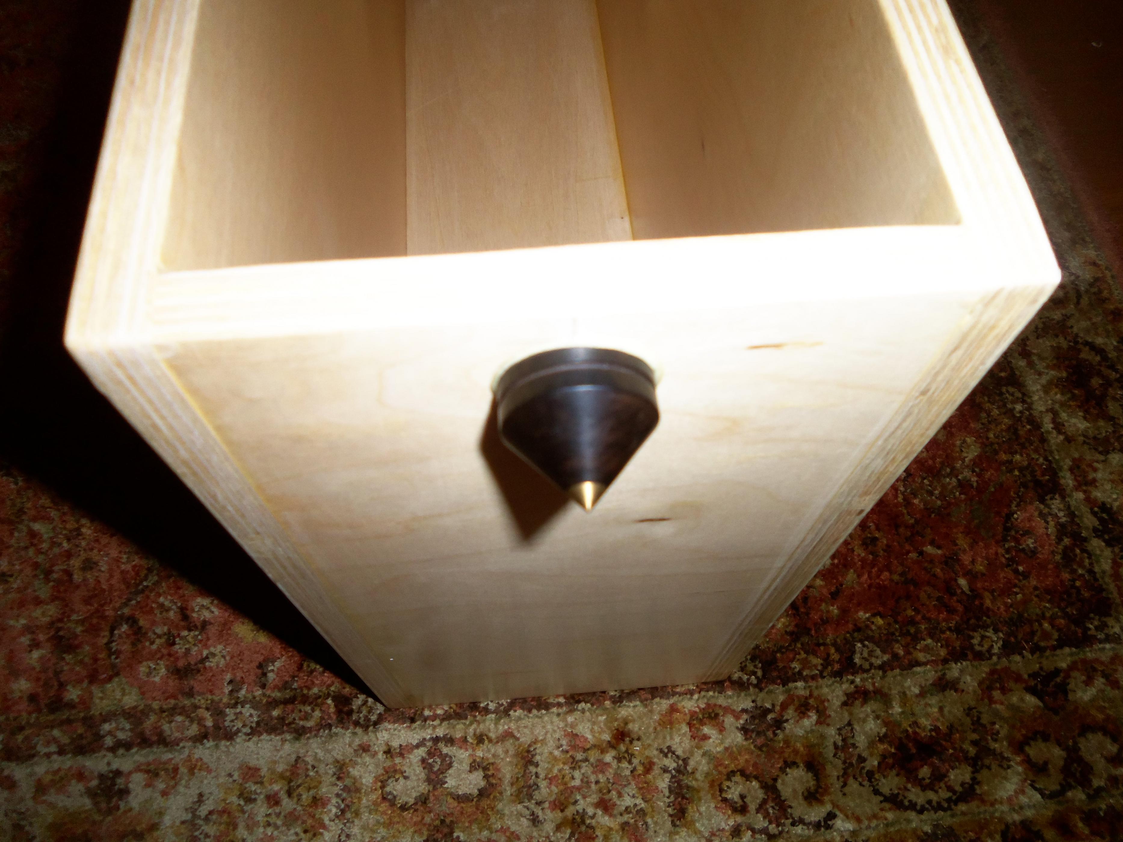

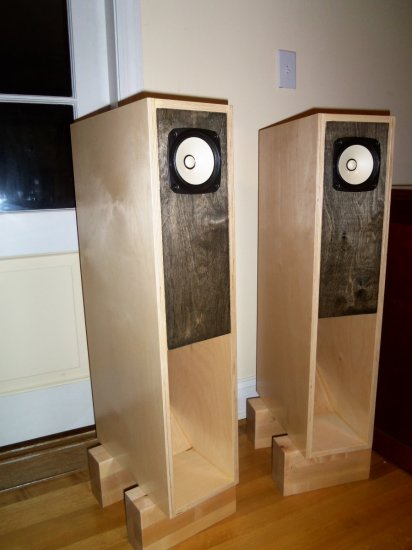

First of all many thanks to you & everyone else who was involved designing these horns. I actually added 1" wooden isolation cone ( pics ) underneath the horns ( about 5dg tilt angle ).To support back of the speakers I used kitchen cabinets shelf brackets (pics ).
Great job! How big are those stands? I'm thinking I should make a pair myself.
Those risers are attractive. Jus
t be aware you'll loose some floor-coupling. Tradeoff between that & getting the driver further on-axis with the ears for those with higher chairs.
