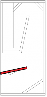

I'd use dry coarse sand, crushed glass "sand" blasting media, or "lead" shot" in the voids. It'll help damp resonances somewhat, and in the lower void will improve stability as well.
While it might detract somewhat from the aesthetics, I think you'd achieve more benefit from in a small internal brace in the mouth ( i.e. 3/4" x 3-4" strip of ply or even solid hardwood), oriented at an angle
Sorry to bring up old post about the additional bracing, but since I already build ones, and I see that the side walls in the bottom are vibrating (in my "only by an ear" estimation it messes up some of the freaquences in a 400-700hz range).
Chrisb,
you mentioned, that small bracing is an option.
My question is this: what about the larger one (see the the image, you provided the smaller one, mine is red, on top of it) - would it help more?
Or would it stand in the way, so to say, and would be more of an obsticle than a helper?
To sum it up: aestetics aside (for exampe larger brace for me seems even nicer than the originally proposed one), what is the best bracing option?
A brace like that should be fine. It should run from mid-point to mid-point, should have a bevel(at least on the end pointing into the cabinet, and can be holey to complicate the resonances of the brace itself.
dave
dave
dave
Dave,
thank you for the answer.
Could you clarfiy a few points?:
1. bevel shape - is it ok, if it would be rounded? Otherwise I don't imagine, what kind of corner should I make.
2. "and can be holey to complicate the resonances of the brace itself" - are you suggesting that i make a few large holes in the brace itself? What % the holes should make of the brace?
Many thanks in advance,
F.
Sure
20-35% I would suggest that circular holes be best.
dave
