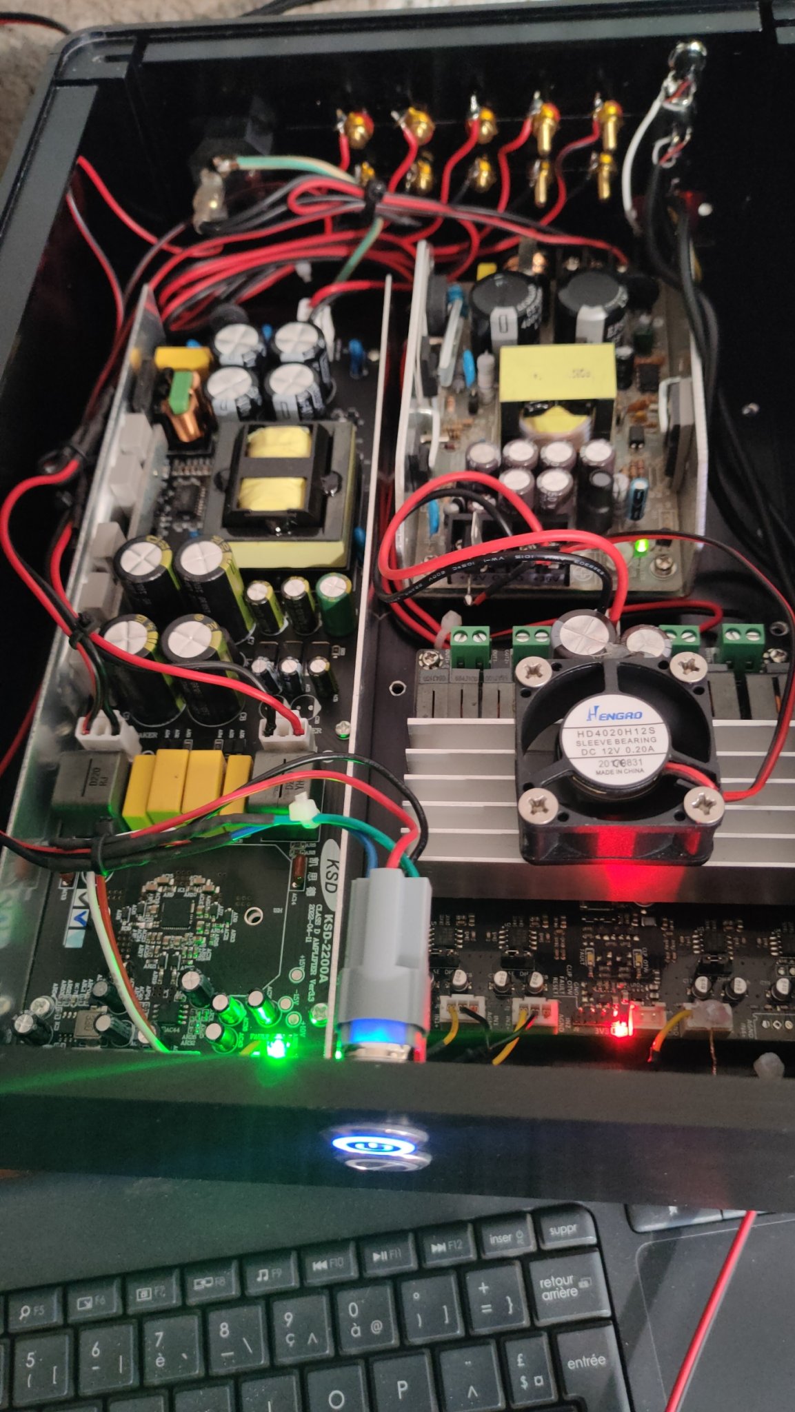

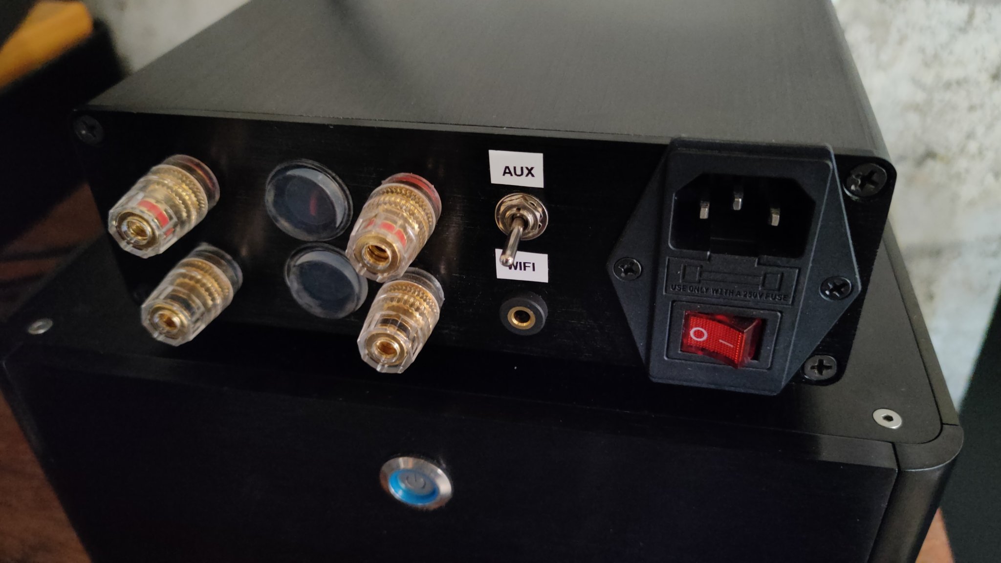

I compared the two MA5332MS cards...MA5332MS card with power supply, ordered!
I will be able to put it in competition with my connected MA5332 amp.. https://www.diyaudio.com/community/threads/class-d-amp-photo-gallery.87913/page-105
wait and see !đź‘Ť

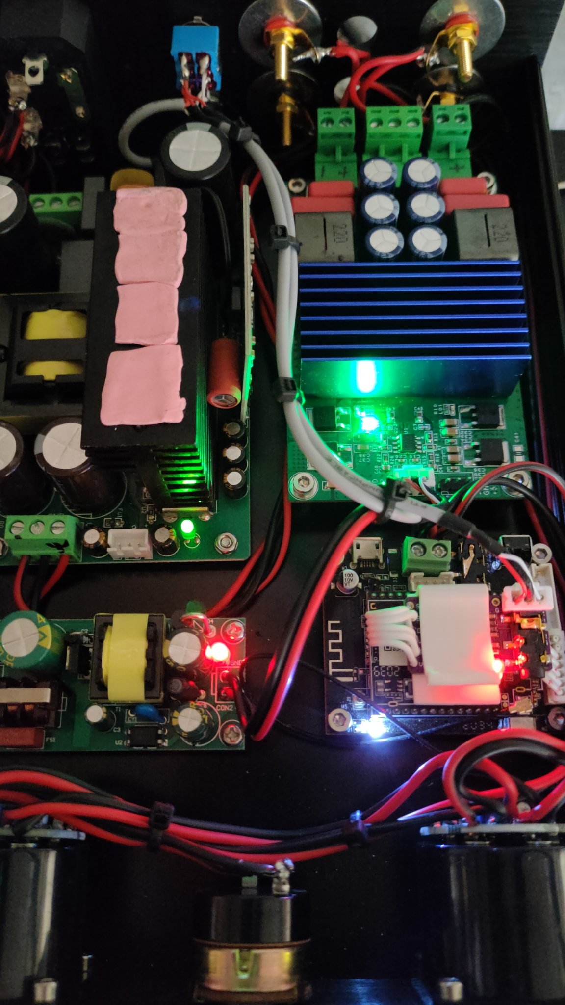

I modified my first amp (wifi) to add an auxiliary input in order to be able to try the 2 amps on the same dac.
Dac Dual ak4493seq (excellent!!).
Well I prefer...The amp card with integrated power supply.
The sound is more detailed and natural.
The power is not lacking and it stays clean!

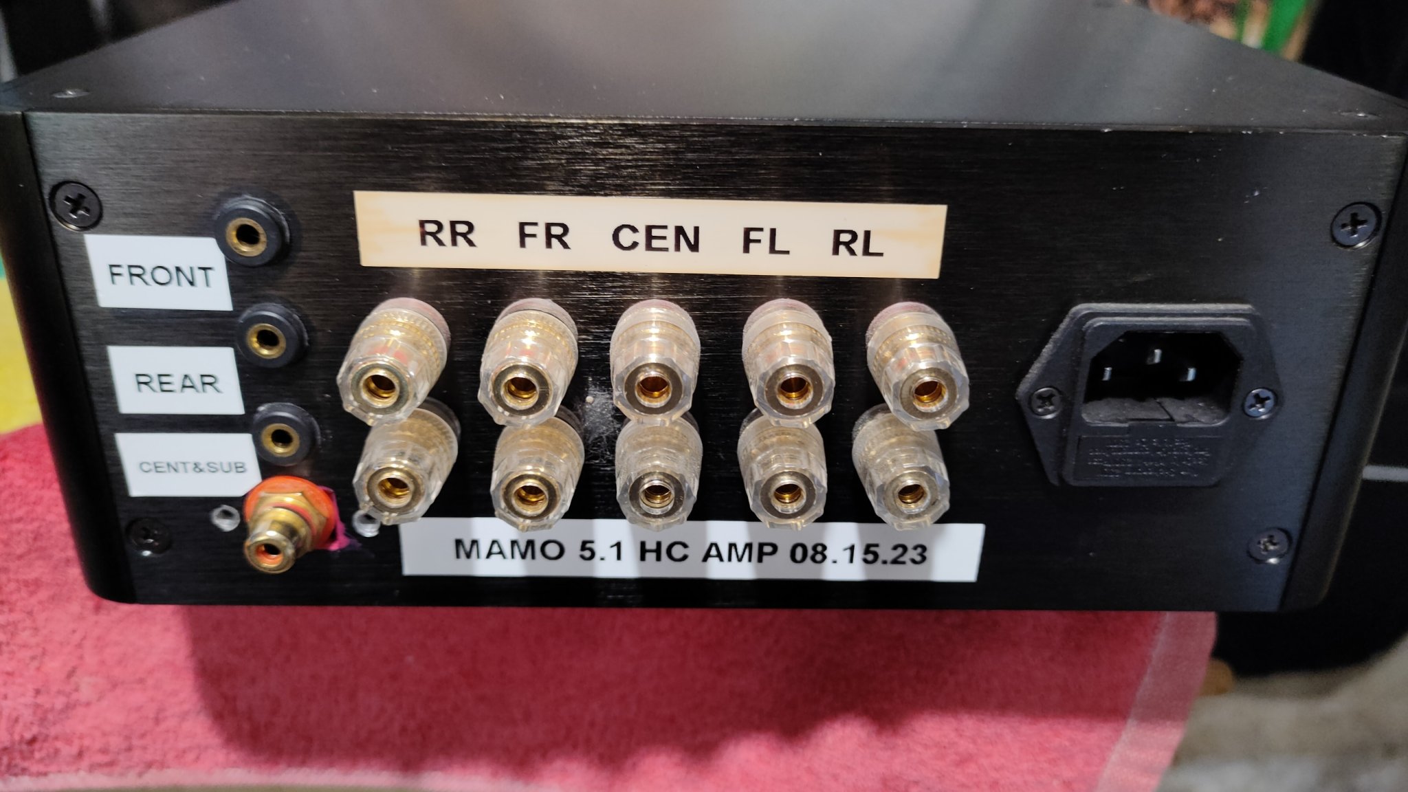

For a 5.1 project !

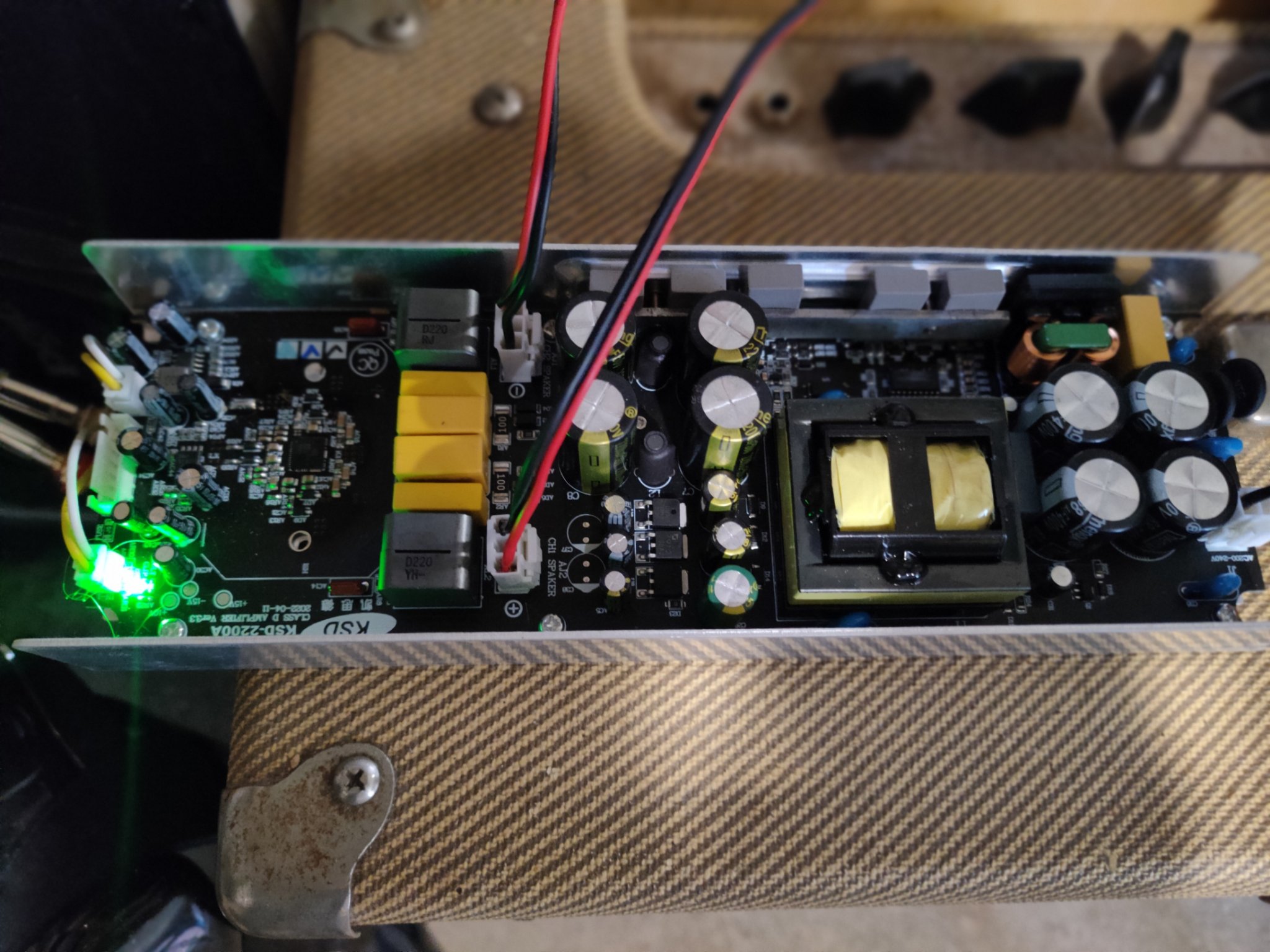

The op amp is an ordinary JRC4580.Interesting. cheaper than the board with a separate power supply.

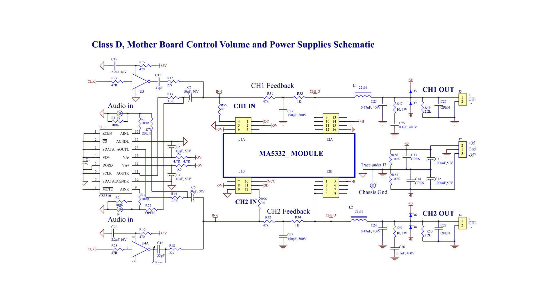

Can you tell us some details? The opamp used, the feedback loop as discussed here before?
They used chemical capacitors on the inputs, maybe better than the ceramic capacitors on the pillor board.
For the rest of the principle of feedback...I don't know...
This power supply card is attached to the cooling box, I'm afraid of doing stupid things when dismantling and damaging the thermal pad of the MA chip!!!
The power supply must also play a role, the EMI filtering seems well designed, it occupies 2/3 of the card.
The least fun, it comes without connectors ...
Jst -VH 3.96 with 3 pins, middle pin not used.

The ceramics are for sure not optimal.The op amp is an ordinary JRC4580.
I think you mean pga2310 , just to add, how about adding 4 or 5 input selection relay with one input fixed as a bluetooth or wifi audio module...View attachment 1195857
Looked at the evaluation board design of Infinion.
The feedback loop is a copy of the evaluation board design of Infinion. Except that R55 is 0 Ohm here....
Why would I want that?I think you mean pga2310 , just to add, how about adding 4 or 5 input selection relay with one input fixed as a bluetooth or wifi audio module...
well its ok, it was just a thought...Why would I want that?

The least cool thing about this card is the pops when turning it on or off... output relays would have been needed after the op amps.
You have to remember to turn on the DAC first and then the amp...and the opposite when turned off.
