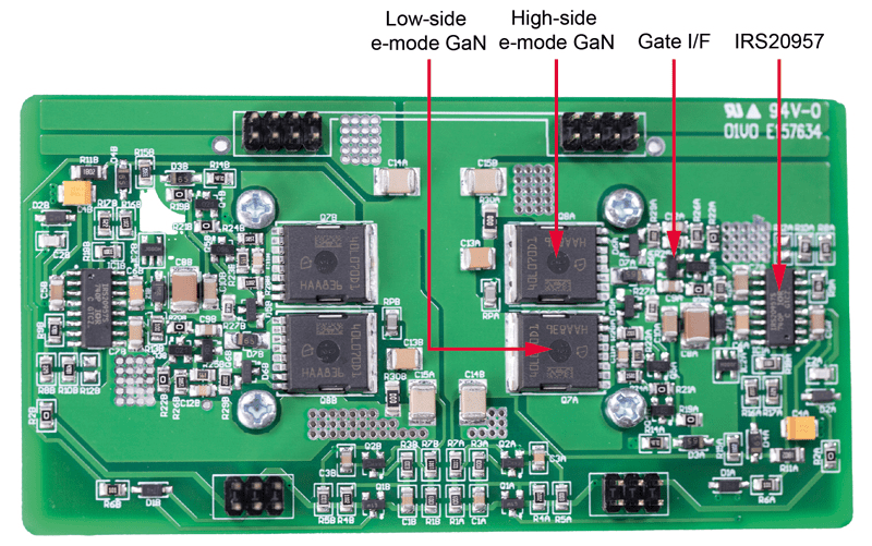

Looked through various datasheets of the IR4xxxm IR2xxx, and the according evaluation boards.
Basically it is copy paste all the time. The same circuit drawn in the datasheets. The same (deviating) implementation on the evaluation boards schematics.
Still thinking the feedback resistor should actually be connected to IN- and not the front side of the Rin. As drawn every time in the datasheets.
Also when in more detail the PWM mode is discussed, it is drawn like this.
Is this indeed an implementation error, that is repeated over and over? Because they copy every time the previous design?
Any opinions?

I removed the 47k's feedback resistors and replaced it by Dale RN60 resistors and connected it to the input of the MA5332. So according to the datasheet.
Didn't get worse, I would even say it sounds better. Cleaner. Of course also a different resistor type use, which will change sound signature also.
I can hear the details in Talk Talk's - Spirit of Eden. That's a good start.
Before I had an impression of some "noise around the edges". Don't know how to express it. This impression is gone. Thought still not that clean as the Sabaj, yet. But comes closer now.

The 2k7 resistor likely was an input filter (combined with the input capacitance) or stopper resistor. Datasheet stuff generally is the minimum required for correct functioning and not the maximum.
2 changes at the same time give noise around the edges, that is correct 🙂 My guess is that it will never be as the Sabaj simply because it is not multilevel class D.

Only mods so far, is changing the feedback resistors, with the 47k directly at the -IN. The 1k is connected from pin 24 to the 47k resistor. This shortens the (too big) feedback loop. So, still listening to the ceramic coupling caps and the 5532.
