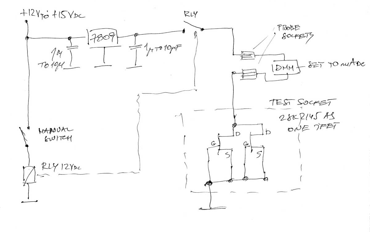

use datasheet of 2SK2145 to decipher approprite connection of bottom pins of test socket
then solder it to piece of veroboard, and use it as pcb for everything else
I included small relay as functional switch for JFet circuit simply because that is best option - certainly much better quality of switch than any manually operated taster or switch; there - every additional Ohm counts, and manual switches are too "dirty" for that small range of currents
then, shown "manual switch" for entire test circuit - I started with taster there, then realized that is stupid to use my digit to keep taster pressed for 15-20-30 secs, as much is needed to see mA numbers on DMM settling to final value

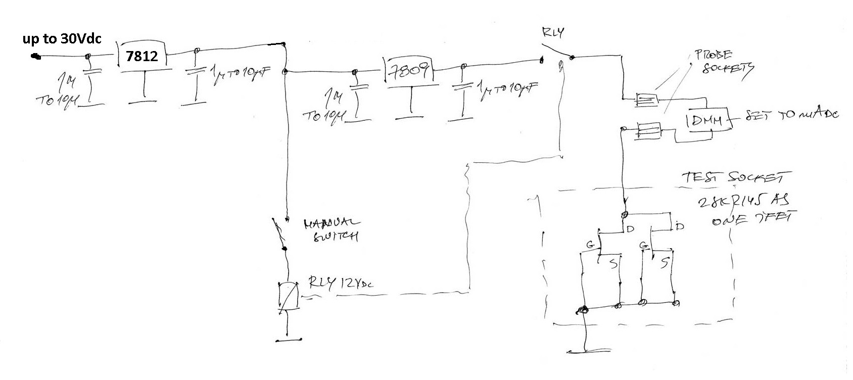

if you don't have handy 12-15Vdc supply, just include 7812 reg in front of everything, then you can use even your laptop supply as main PSU
it depends of matching purpose
say - for triplets I'm using in buffers - I'm content with having all 3 in 0.5mA ........that difference being further diminished when JFets are actually biased in circuit to significantly lower Iq than their Idss is
for 2+2 I'm using in LTP - I'm keeping them in same bracket (0.5mA), but then I'm combining them to have closest sum of twos

then 10mA and 13mA are used for one LTP side, 11mA and 12mA used for other side of LTP

ZM Thanks for the diagram, unfortunately I am missing some components (voltage regulators) and I need to finish the project as soon as possible, I used the dca pro 75 from atlas peak, I was able to select two quartets with intervals of 0.06 mA, the first quartet goes from 4.10 - 4.14 - 4.14 - 4.16 and the second quartet goes from 4.22 - 4.23 - 4.26 - 4.27 mA. better than this I could not do. Thank you for helping me. ![worship :worship: :worship:](https://files.diyaudio.com/forums/images/smilies/worship.gif)

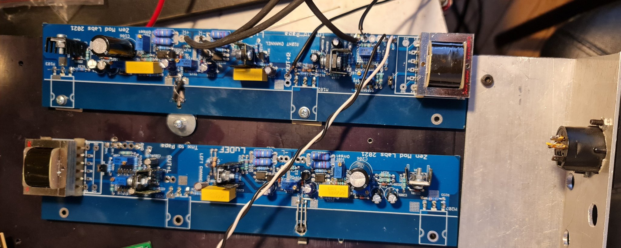

I finished LuDEF last night. All voltages have been adjusted smoothly and are stable, very quiet. I really like how they sound and I would like to use them in an active 3-way open baffle speaker system. Can you tell me, please, what preamp gain it needs to get maximum power?
Thank you .
