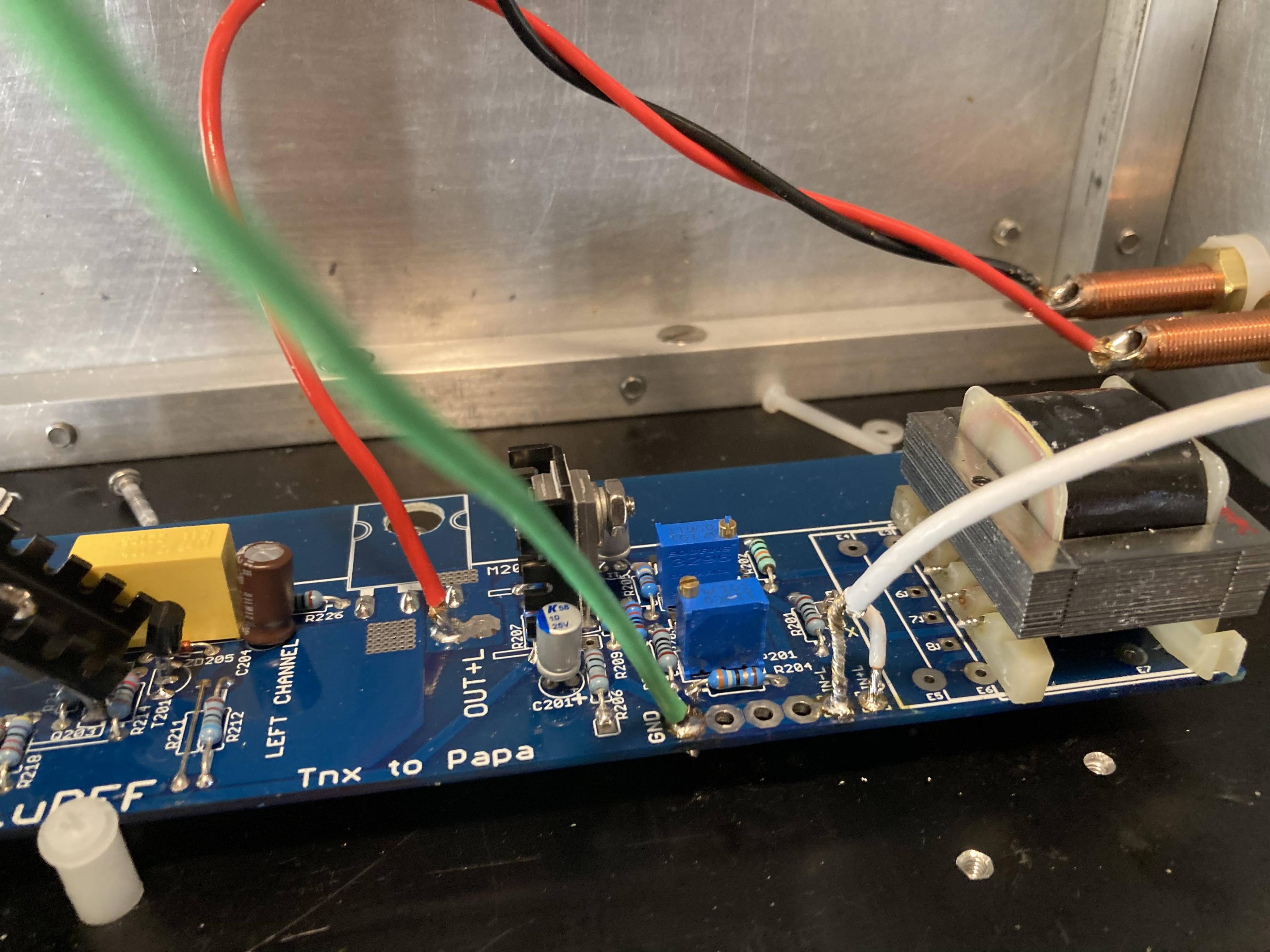

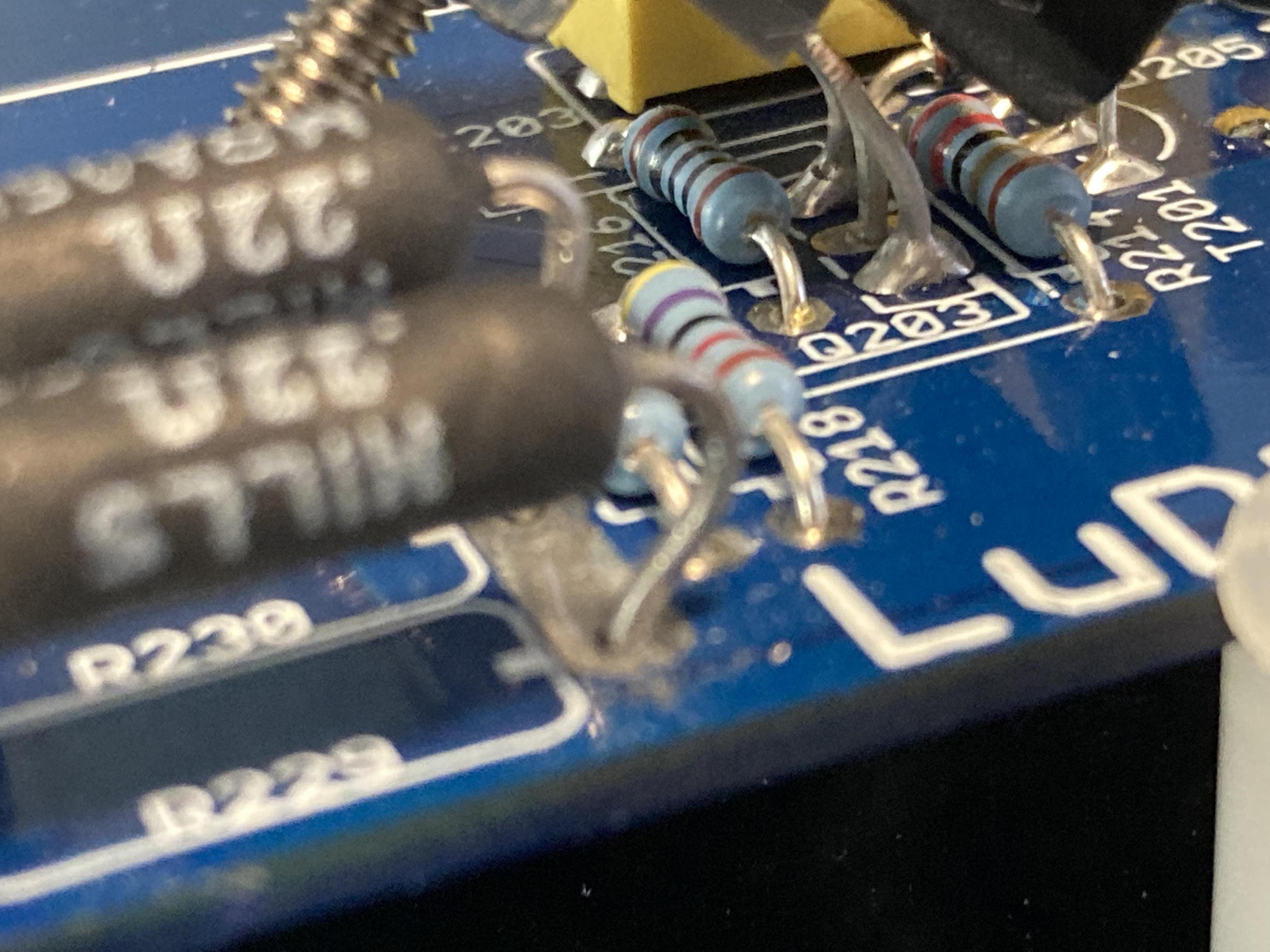

ZM ok a small update from visual inspection and I was measuring resistance in various places and found something strange. On the board in service I am measuring across D and S of the irf510 and find as if I am charging a capacitor the resistance starts small then increases to ~400ohm after that it goes open. On the other board I am always measuring an open circuit between D-S. I am thinking this could be because on the second board the output mosfets are not soldered and the board is not wired so it may behave differently. Still it is a difference. Is this normal behavior? I will remove the board again and check more details. I don't want to unsolder the mosfet unless absolutely necessary and I have no more 510s and I have to order more.

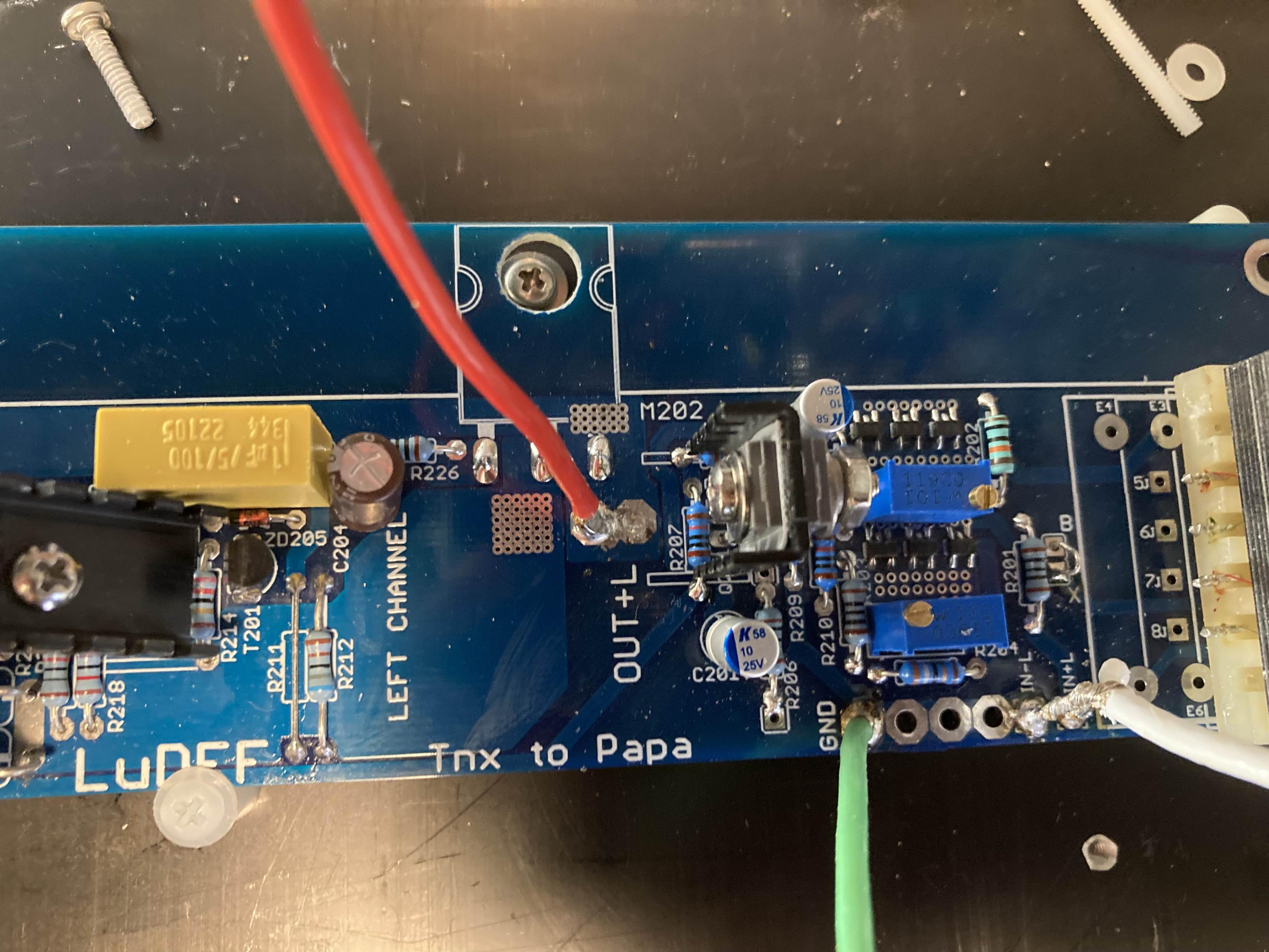

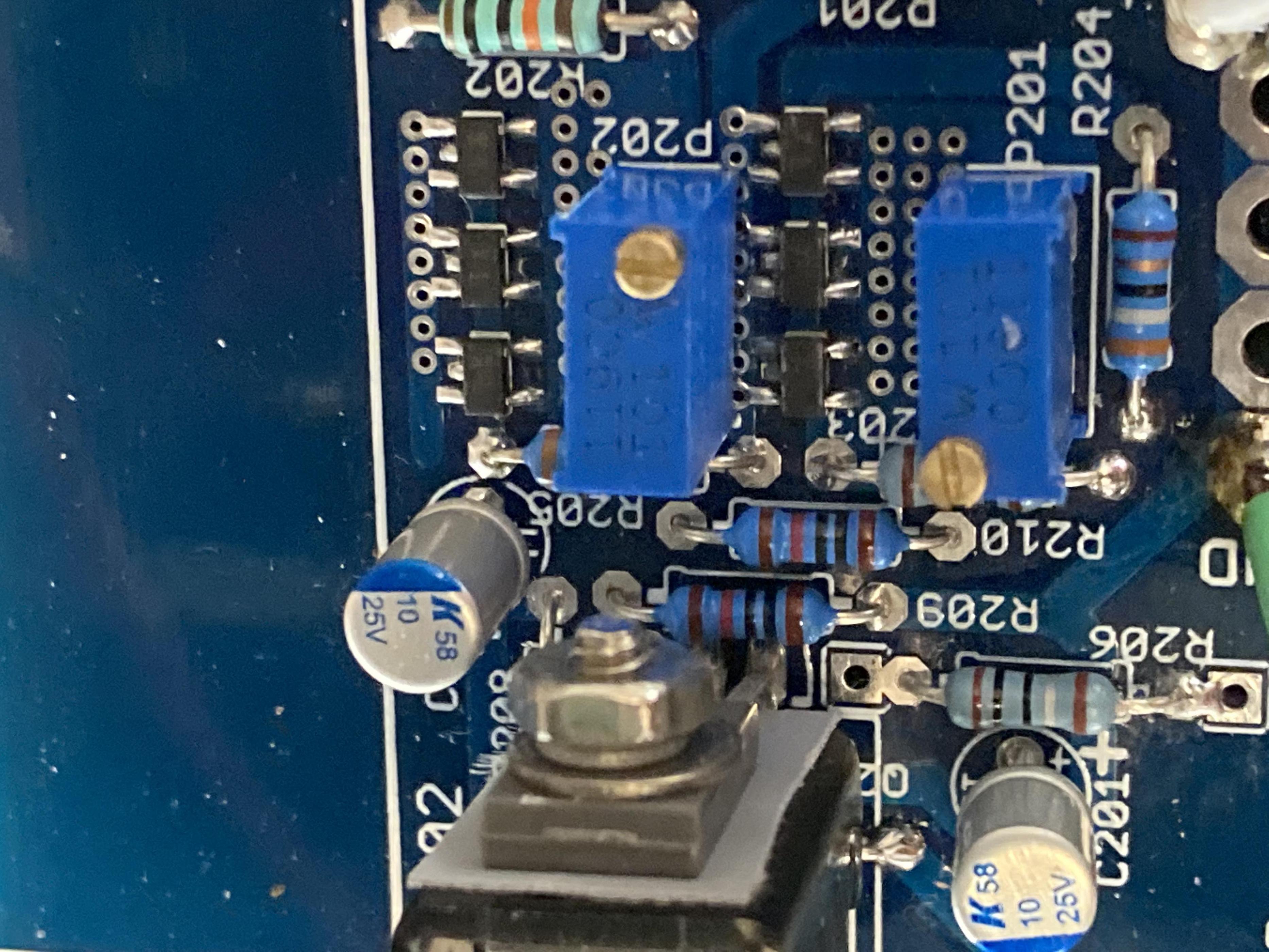

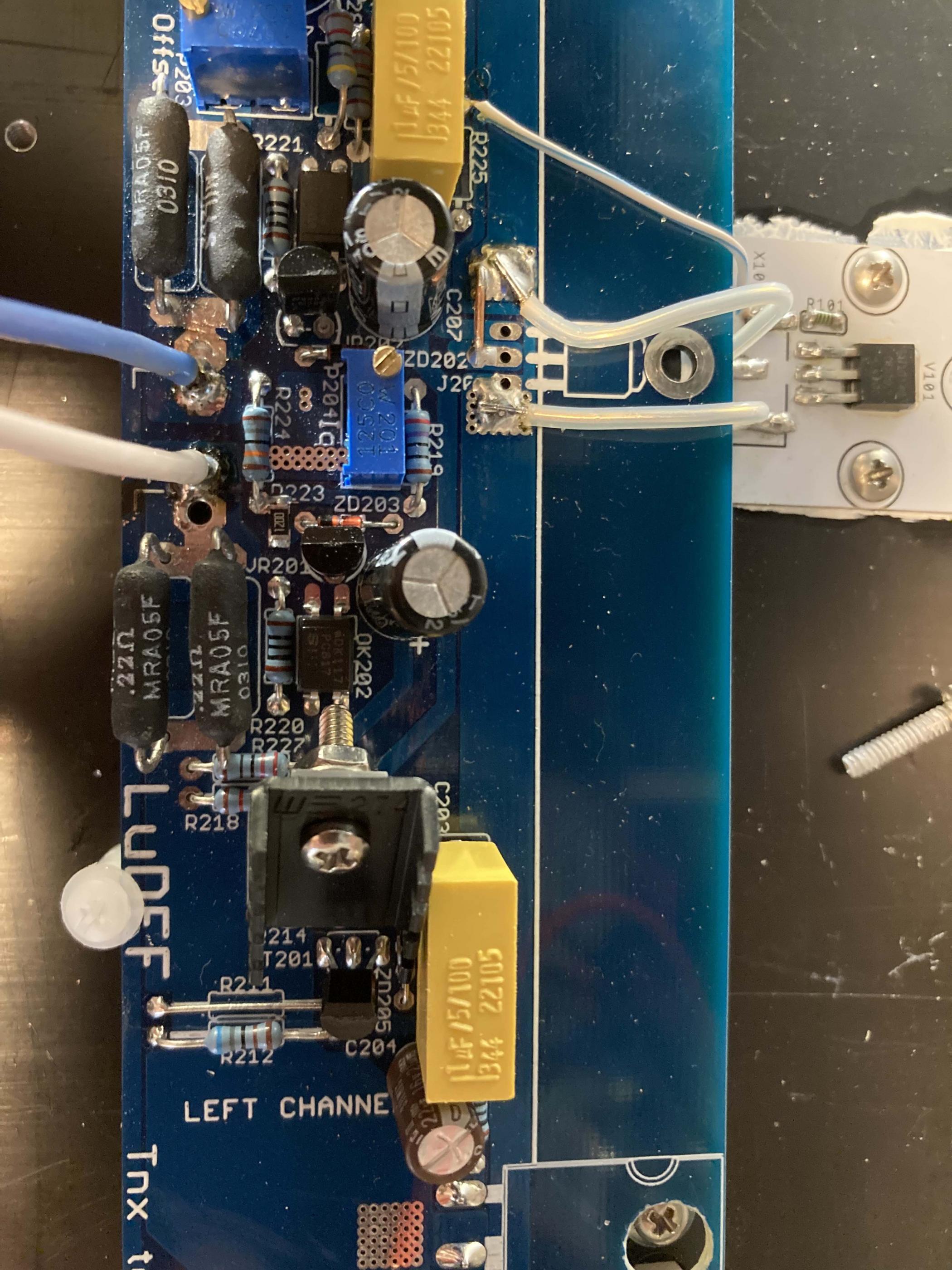

care to post some pics?
that way I'm at least going to feel less in the dark

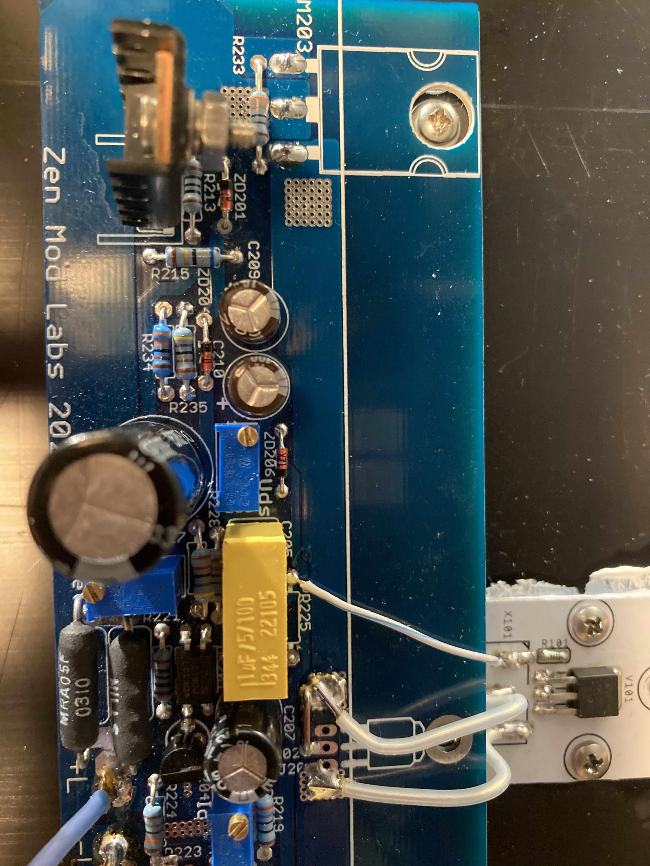

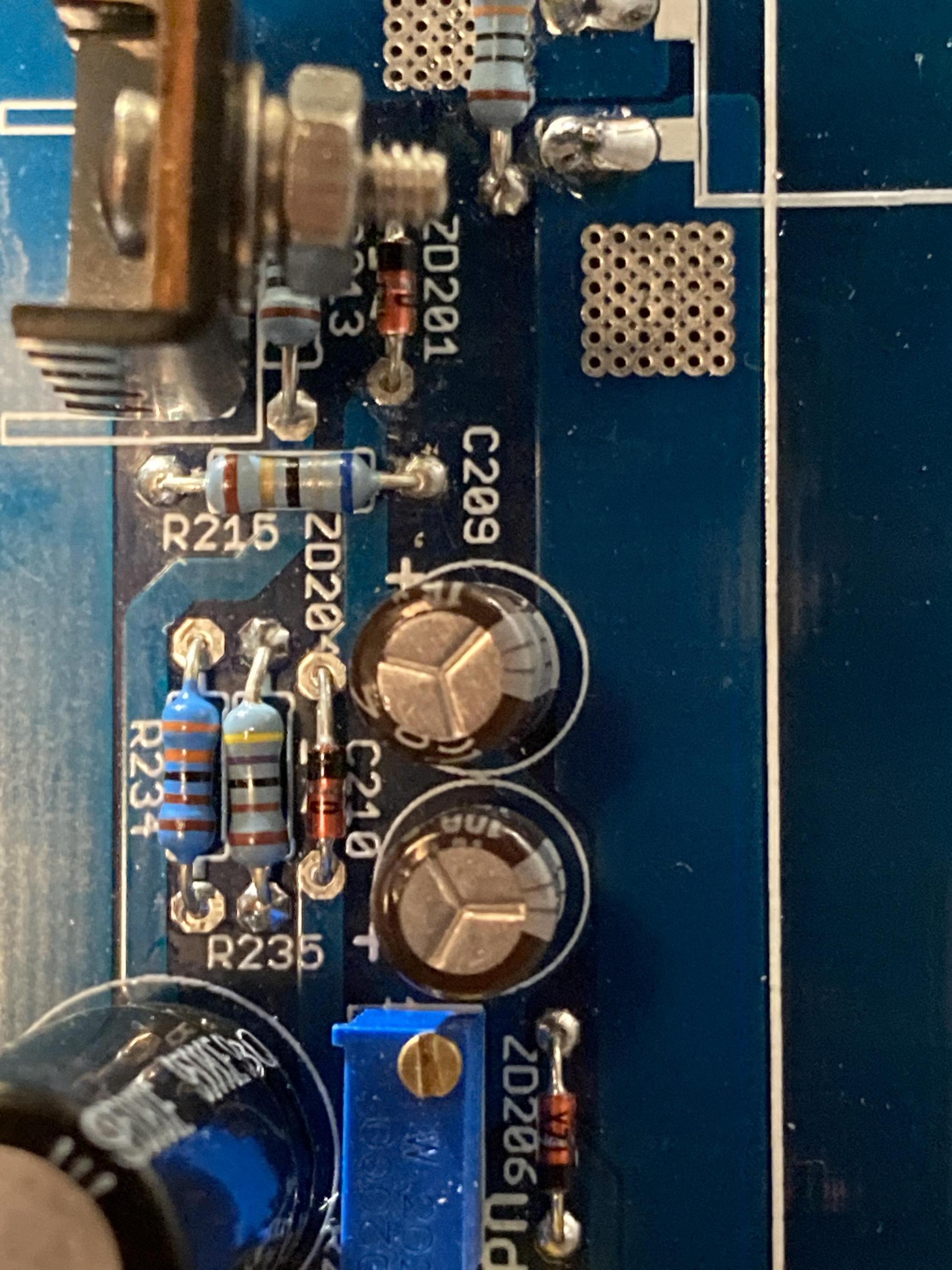

Will remeasure again tonight with your numbers in mind and put pictures.

well, ook, I can't see anything wrong

I can't see nothing on your pictures; probably best is to cool down for few days, then get it, take printed schm sheet and stare at it and on pcb
use this printed too
