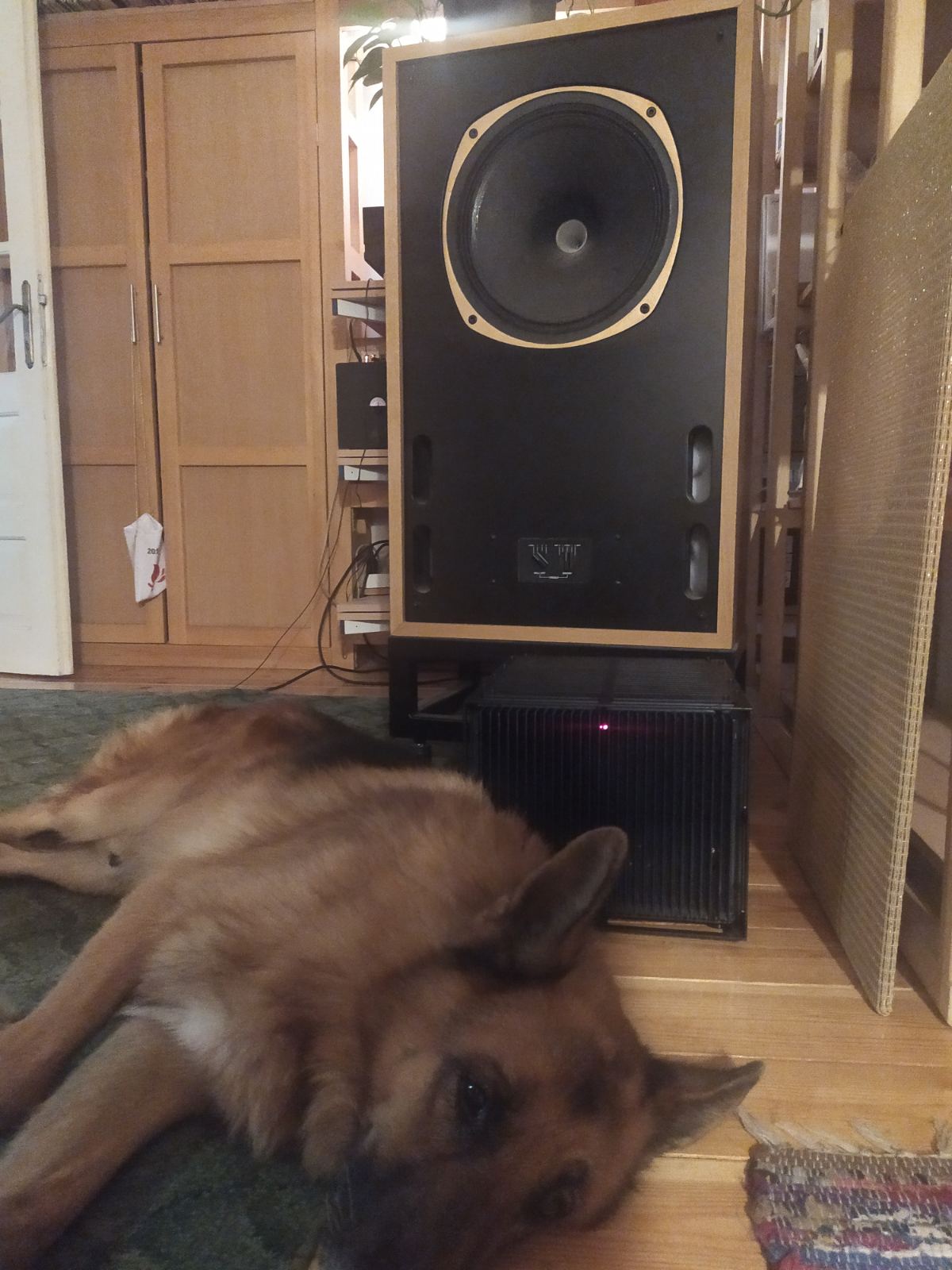

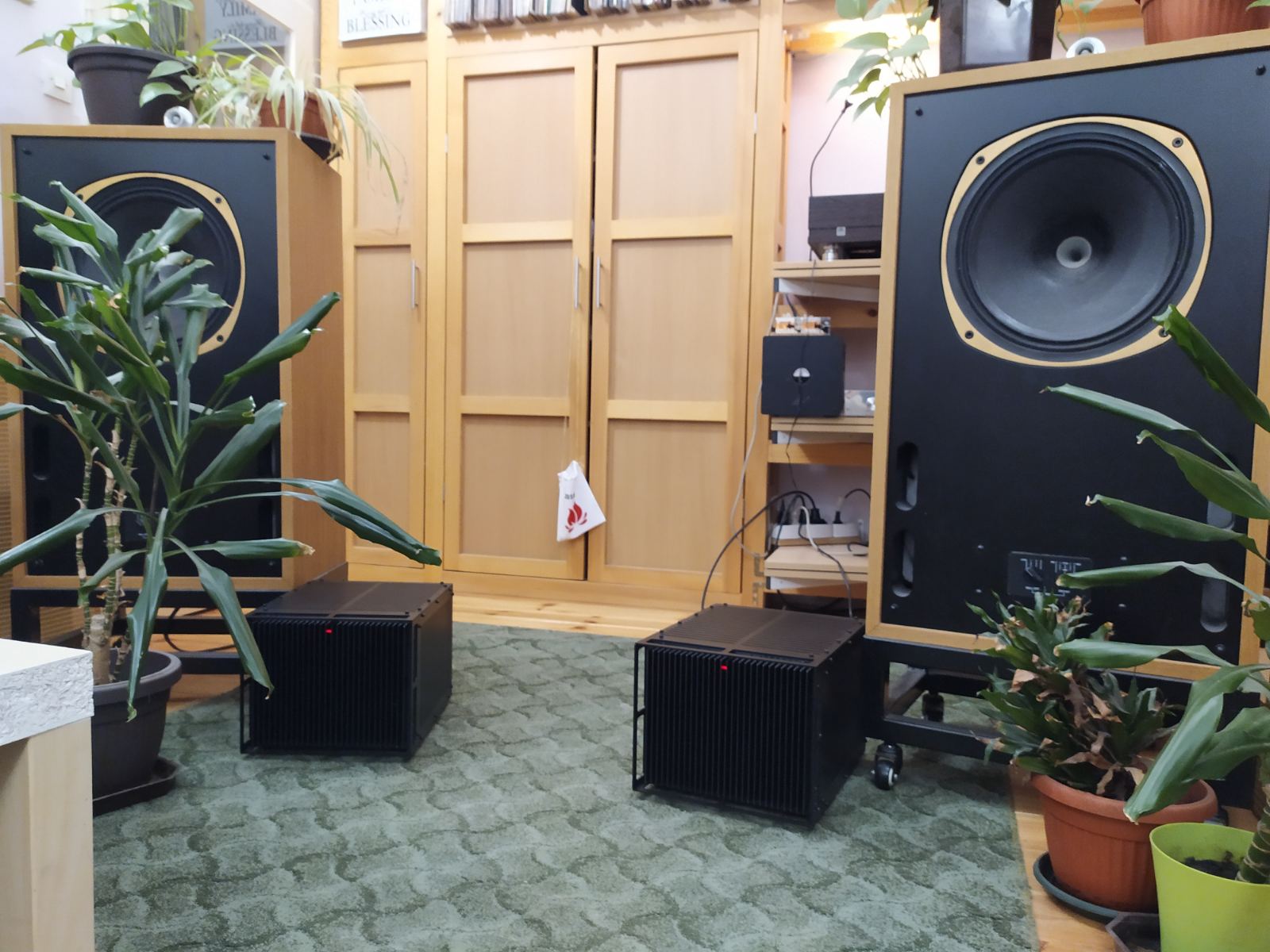

I've just finished one set, for Buddy of mine
Eagles landed 🙂
new- slightly taller speaker stands are in making and amps are going under

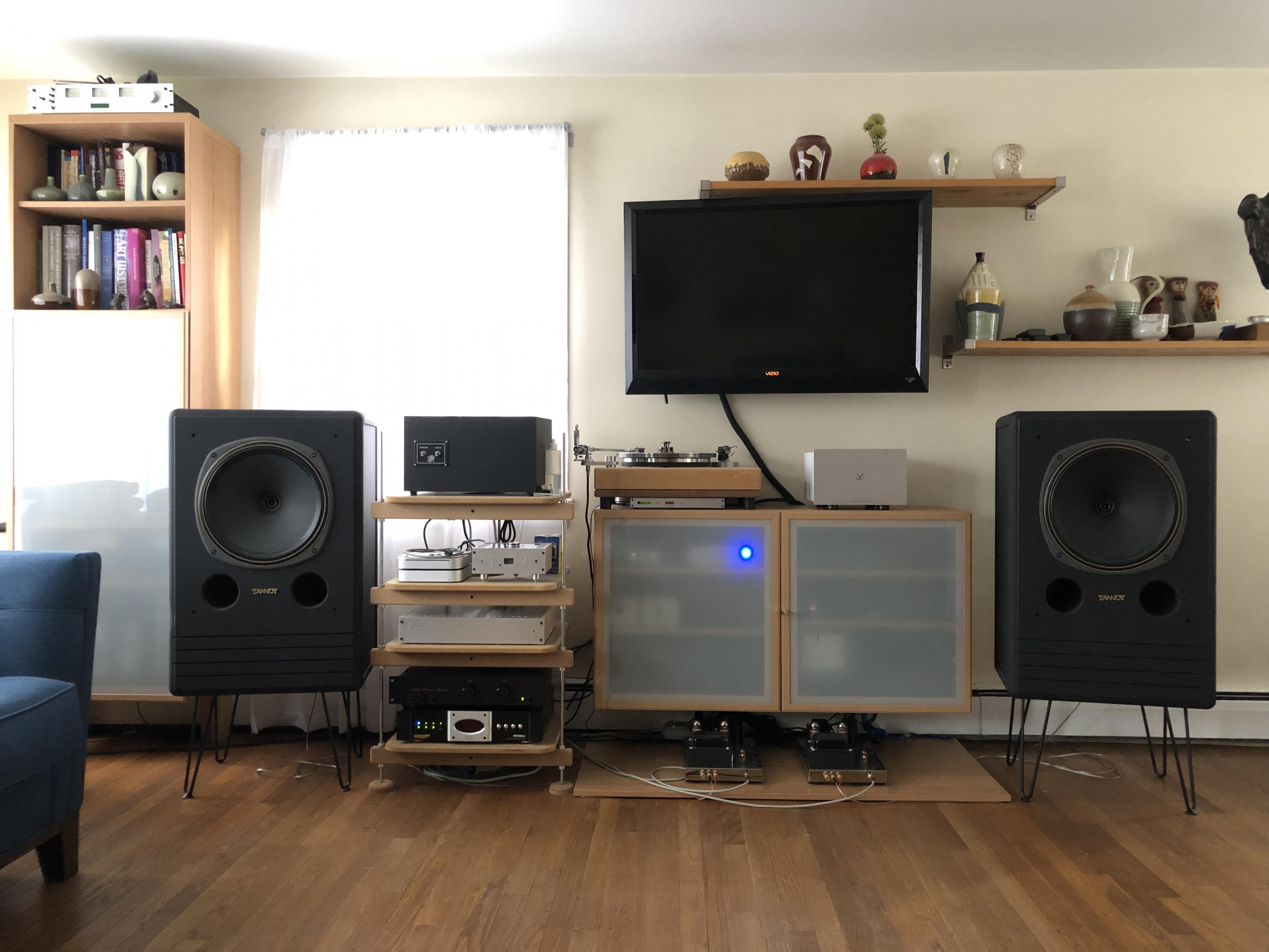

I recently went through finding a way to get my Tannoy to a height where I can use them.
No time for MLTL or OB experiments with on-going slow amp projects…and wanted to at least live with them and hopefully have some enjoyment in the mean time.
I found the legs for $22 US per set on Amazon. They are quite sturdy and were a pleasant surprise.
I thought the same thing about placing amps under them. Possibly in the future as I was considering modifying a 5U case to make two monoblock SissySIT or LuDef.

Modushop monoblock cases are in making , so soon we will have them as option
btw - when you have Tan 15" MLTL, you'll hear night and day difference with same drivers
either that, or spare your self further troubles ...... simply send them to OPLDF
edit: from my experience - I would invest time and energy first in speakers ...... when you have that sorted - drive them with anything you have handy, even proper wallkman will do the job
meaning - with good speakers , many amps are good; with so-so speakers, you must indulge them endlessly ....
15" Tulips are simply choked in these boxes, giving far less than is possible to get from them ........ can't remember what xover is inside, but CPA15 xover is definitely best option for them, made with premium parts (read - bass choke either aircoil with 2mm wire or decent EI or Toroid thingie; I prefer aircoil in this case)
