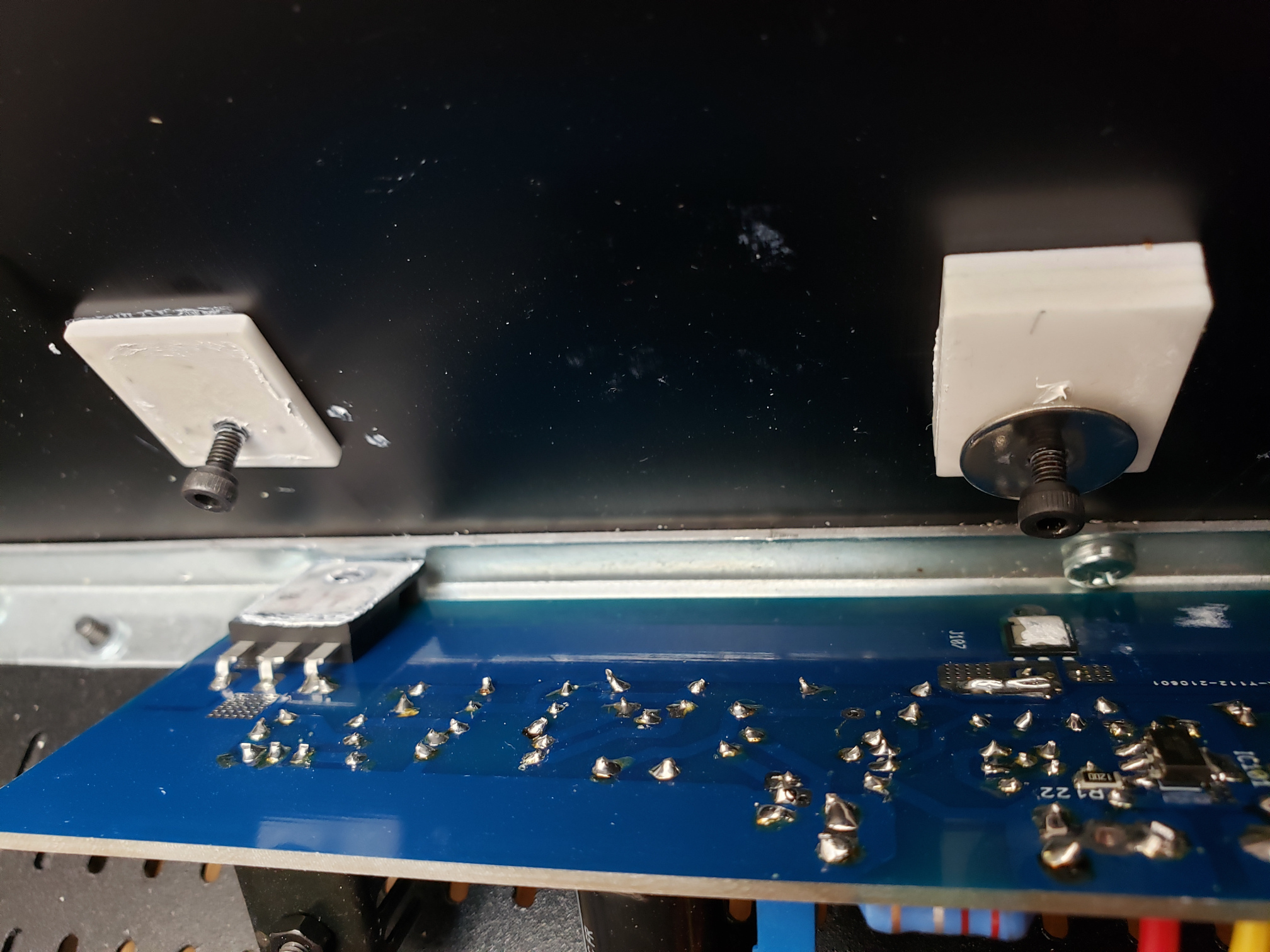

you can mount pcbs parallel, with mosfets in sandwich between heatsink and pcb, with mosfet pins bent adequately - upwards
for that, best to move LU and fix to heatsink separatelly and connect with short wires to pcb
plenty of pics around ...... several here (post #2 and around) Babelfish M25, SissySIT - general building tips and tricks
take pcbs in hands, you'll see wide traces on bottom side , no cutting of pcb please ...... at least not where copper is
I’d be wary of stacking the thermal pads as the heat transfer will be progressively worse for each layer.
Can get away with stacking the LU pads.
LU not putting out a lot of heat and
I've got a metal washer sink on top.

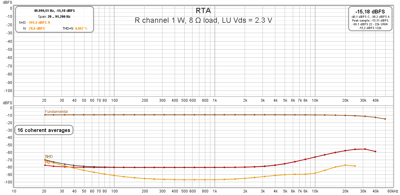

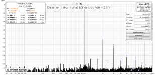

Odd harmonics were high with LU Vds 2.4 V. Some 10 -15 dB below second harmonic(post #657).
Checking at Vds 2.3 delivers more of triode character. Third harmonic remains 20 dB below second through most of frequency range.
ZM was lazy
xeroxed Papa's 2V4 value, too much things were on plate (in fact, still are) to split da hair
that left for cheerful Greedy Boyz

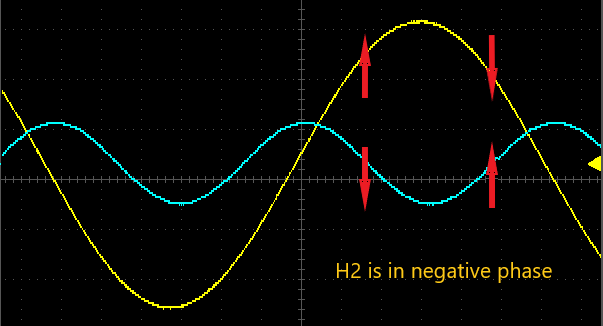

Second most important question
.. in this forum section, after “Will it drive F4?”, seems to be “Is H2 phase negative?”.
Distortion measurement using REW contains phase information and H2 phase is -73°. I’ve put this in perspective using oscilloscope and signal generator. Yellow trace is 1 kHz ‘fundamental’ and blue trace represents 2 kHz ‘harmonic’ shifted exactly -73 degrees, as measured by REW.
We can see that H2 phase is almost perfect negative.
in the beginning was the word, and the word was with ZM, then tombo shows the word in a nice wiggly lines.
From now on, there is no reason for ZM to waste time on measurement of new designs. It is enough for him to declare that sound is spooky and that should be enough for the rest of us.

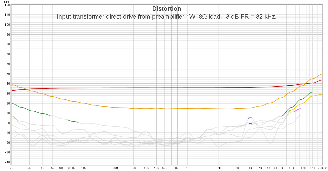

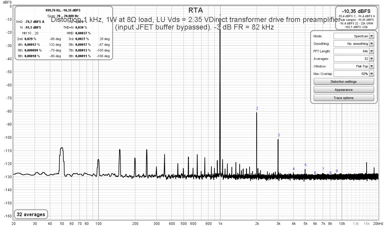

Another function of jumper JP101 on ZM’s contraptions called amplifiers
It was mentioned several times, but not often enough, that on ZM’s amplifiers with input transformer, you can drive transformer directly connecting input to the appropriate jumper pin.
While input JFET buffer is very good, we can get better results driving transformer with proper low output impedance preamplifier (Iron Turtle, Salas DCG3, ACP+, …).
What do we get?
Better frequency response. -3 dB is at 82 kHz in my case.
Lower distortion. With input buffer, distortion was rising toward higher frequency. With direct drive, H2 is at flat level up to 10 kHz, and from that point only slightly rises. But, I don’t care for H2 level past 10 kHz. H3 is 20 – 25 dB below H2 in wide frequency range and closes to H2 level at 10 kHz. But, I don’t care for H3 past 6 kHz frequency. All higher harmonics are at or below noise level.
At 1W, this is very dominant H2, low H3 and nothing else. Well, there is IMD but it is at acceptable levels (0.1 – 0.2 %).
H2 phase is perfect negative through complete frequency range. My rule of thumb is that H2 is good negative if phase is between -120° to -60°. It is better than that. With JFET input buffer, H2 phase is negative only up to 2 – 3 kHz.
My next task is new input buffer that will enable even better results.
What do we get?
Turtle is AVC module, being part of Iron Pumpkin , just to split da hair 🙂
yup, even beefier buffer is possible, but then , tricky to implement that and absolutely necessary ( for intended improvement) proper shunt regs for same ....... there is simply no space in existing form factor
