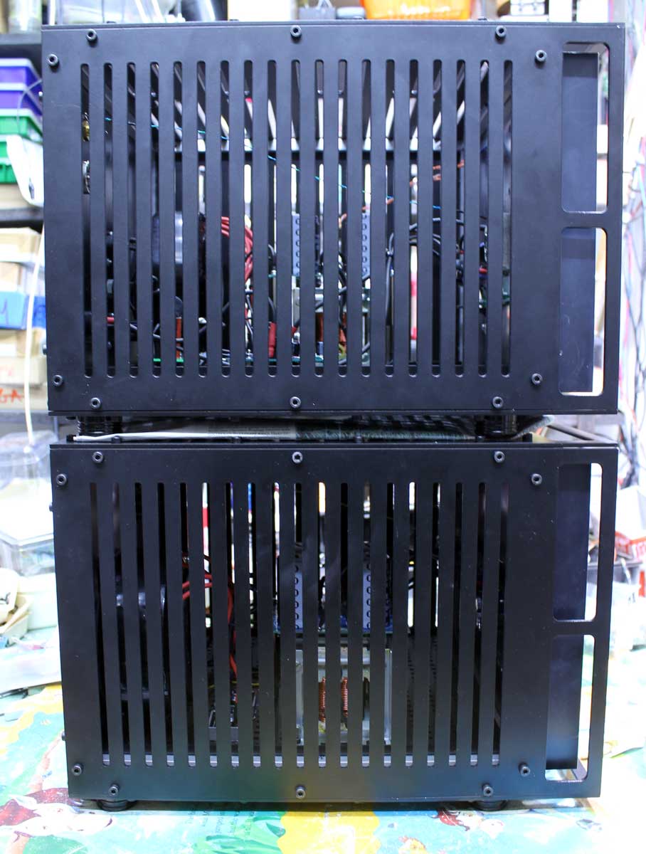

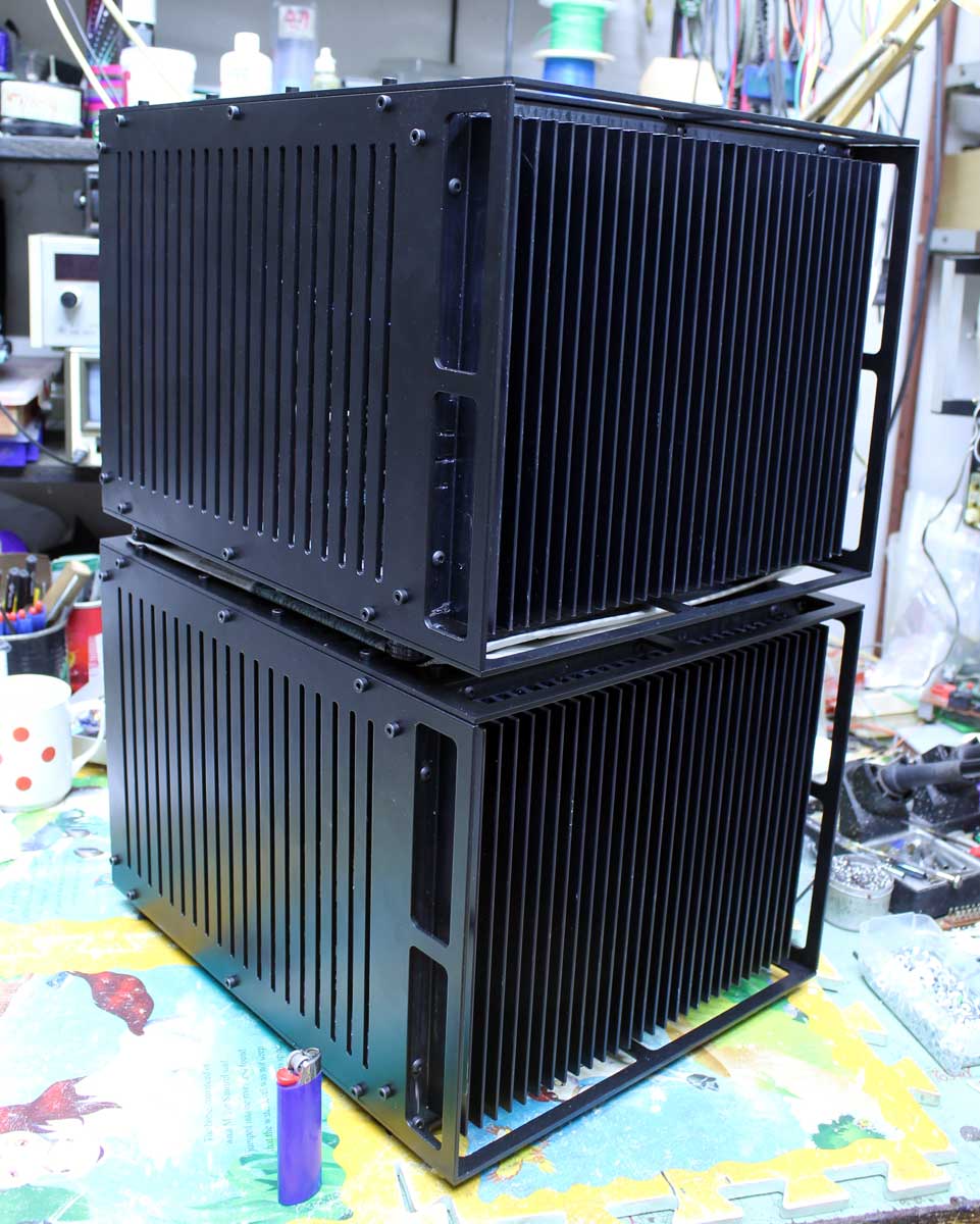

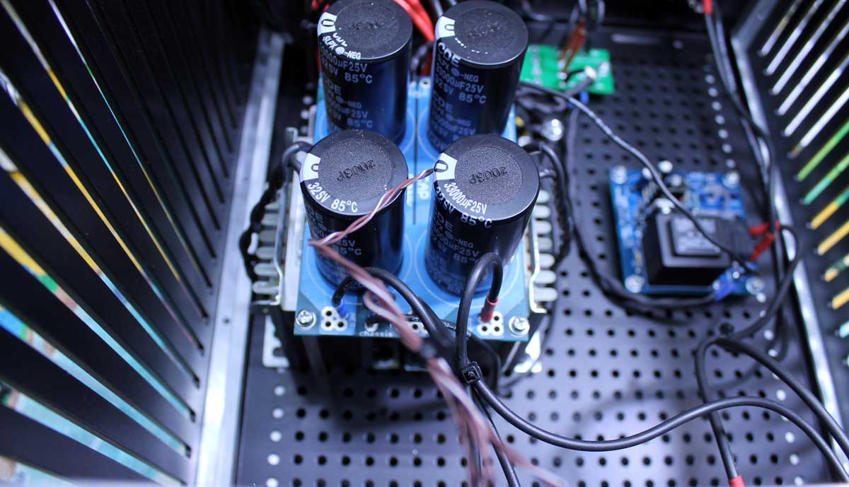

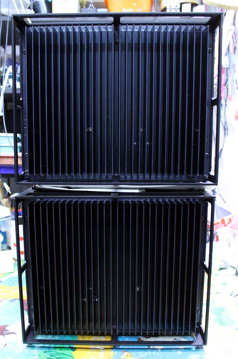

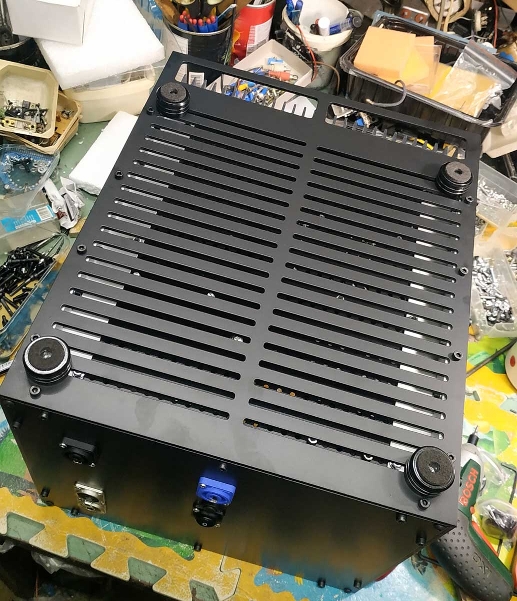

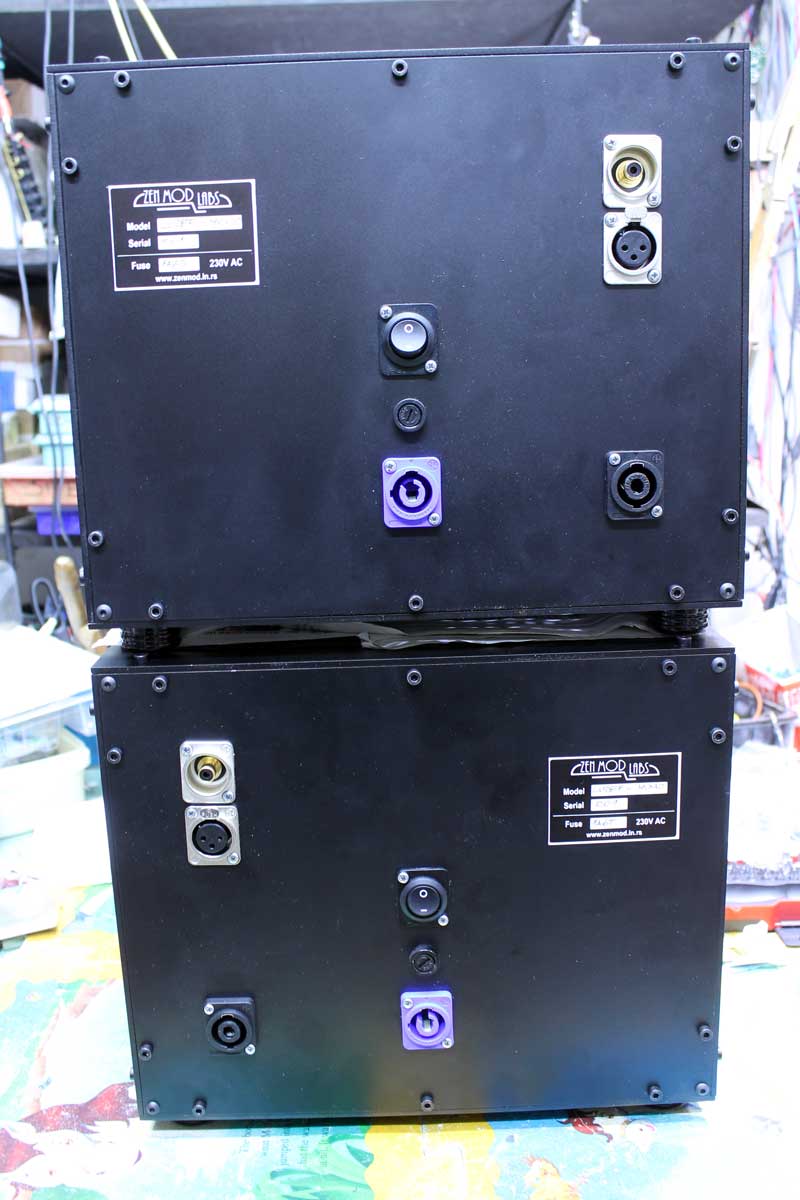

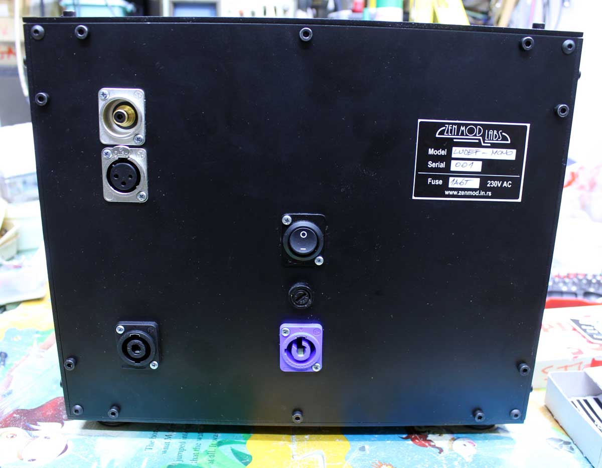

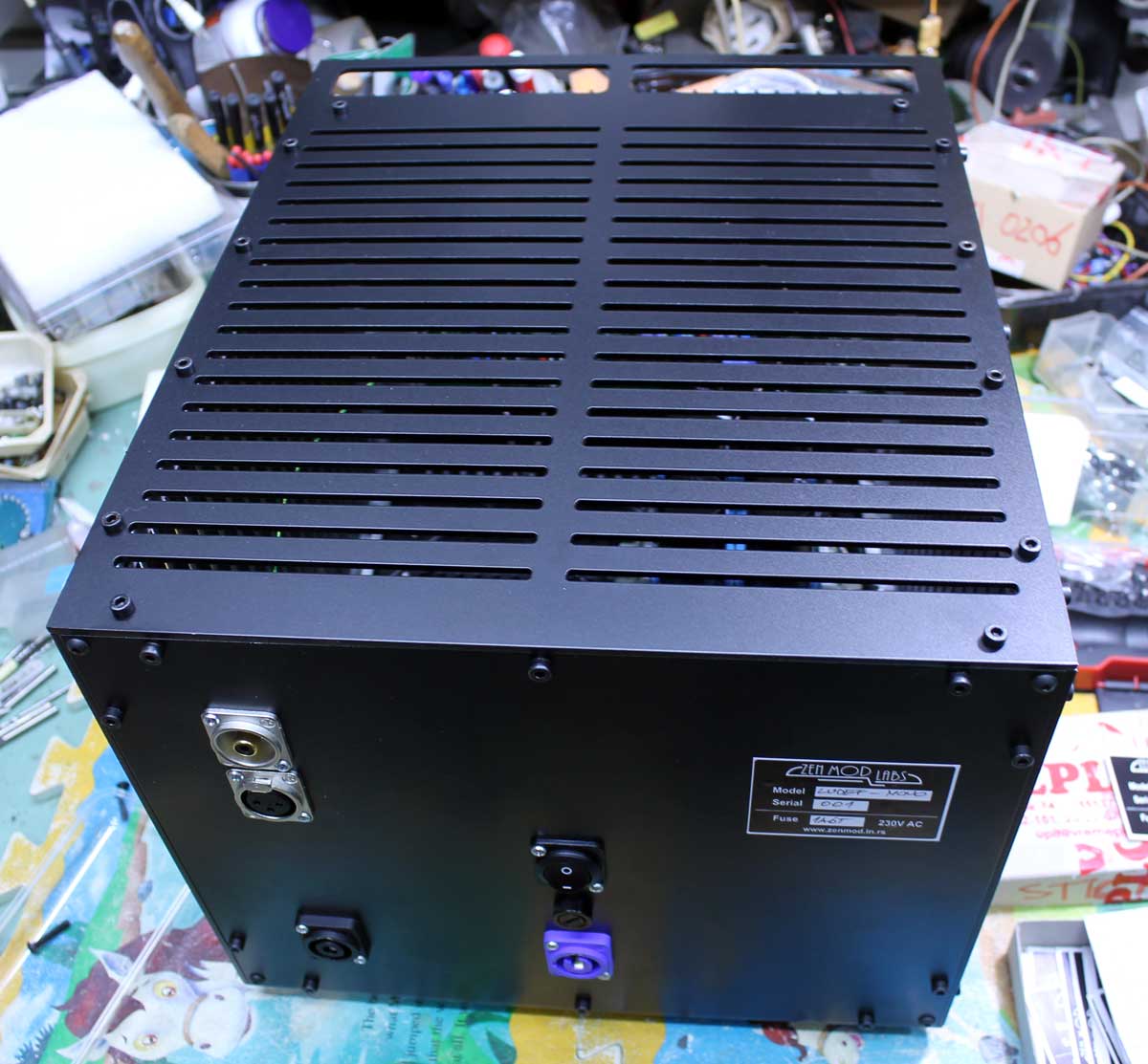

I've just finished one set, for Buddy of mine
custom cases made by him (powdercoated Al) with my nudgenudge about necessary demands (size of hsnk)
overall dimensions dictated with acquired SH heatsinks
not a problem as they go under short speaker stands bellow his 15" Tanns....... even if I more like form factor of 4U/400 long Modushop htsnk
as always custom made Donuts and custom made chokes (4m7H, 0R15), high nickel Cinemags, Neutrik jewels at back
pics, post 1 of 2

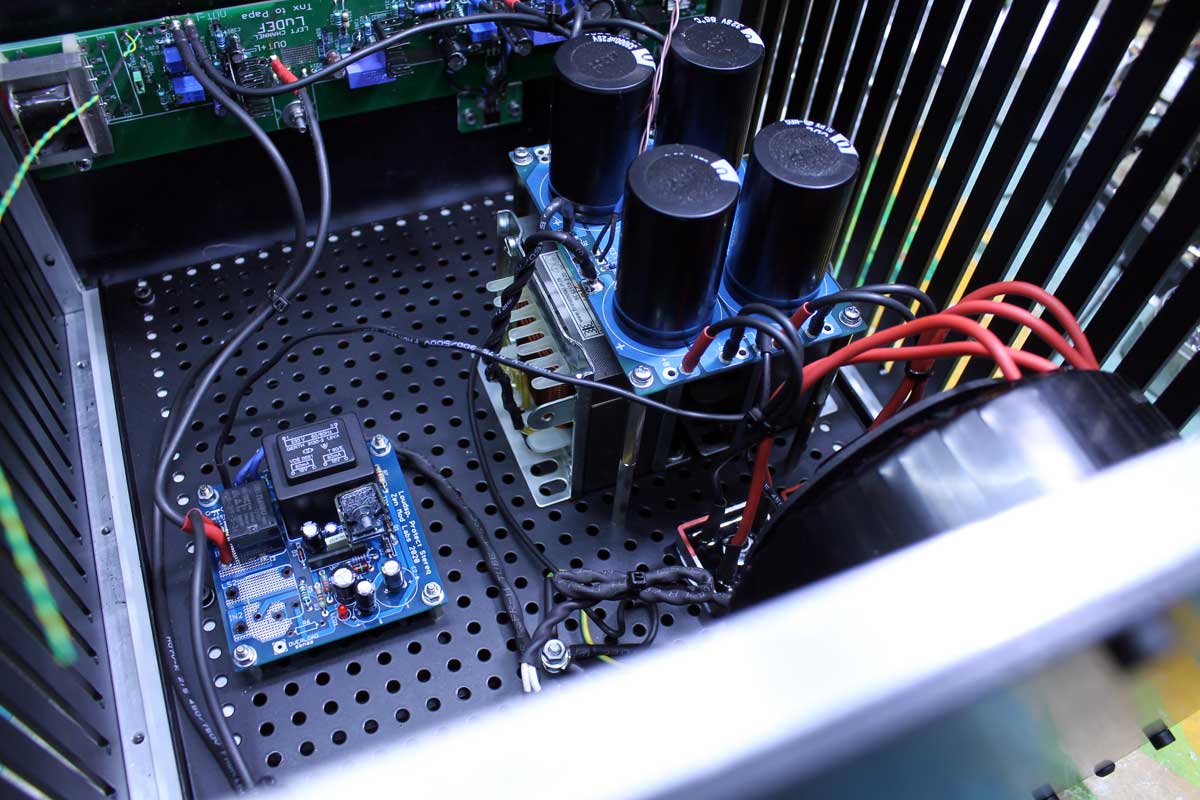

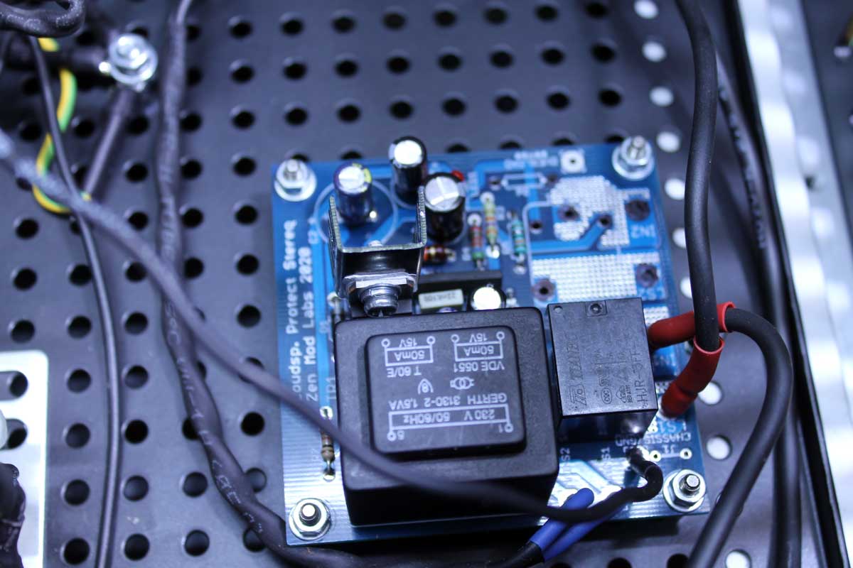

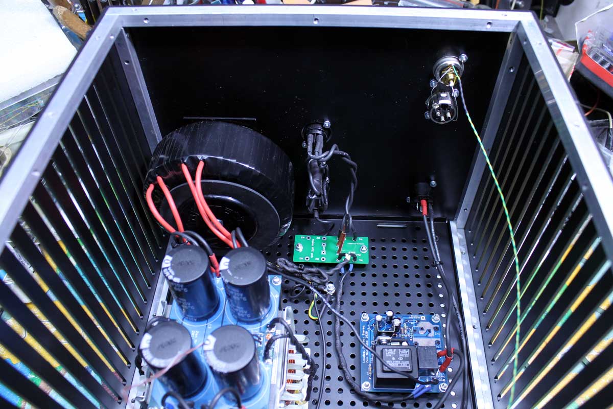

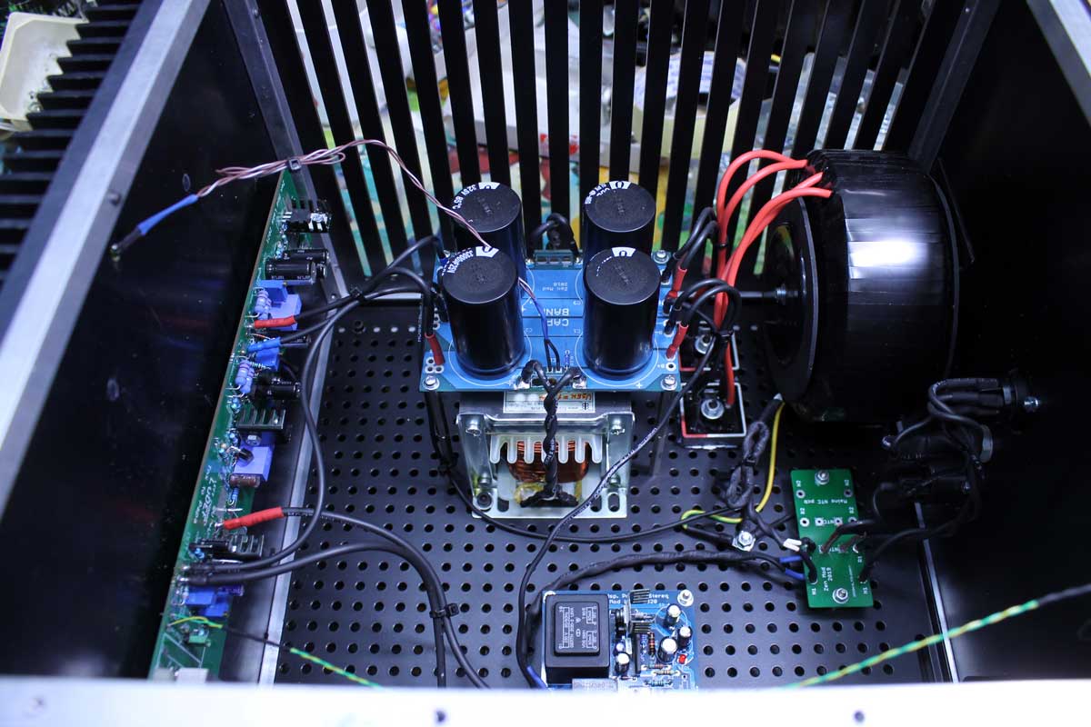

I had to put a work stop on mybuilt as I was busy interviewing for an industry job in 'Pass Country'. ;-) Since I am now in 'wait mode' nothing better to get my mind off things than resume the build!

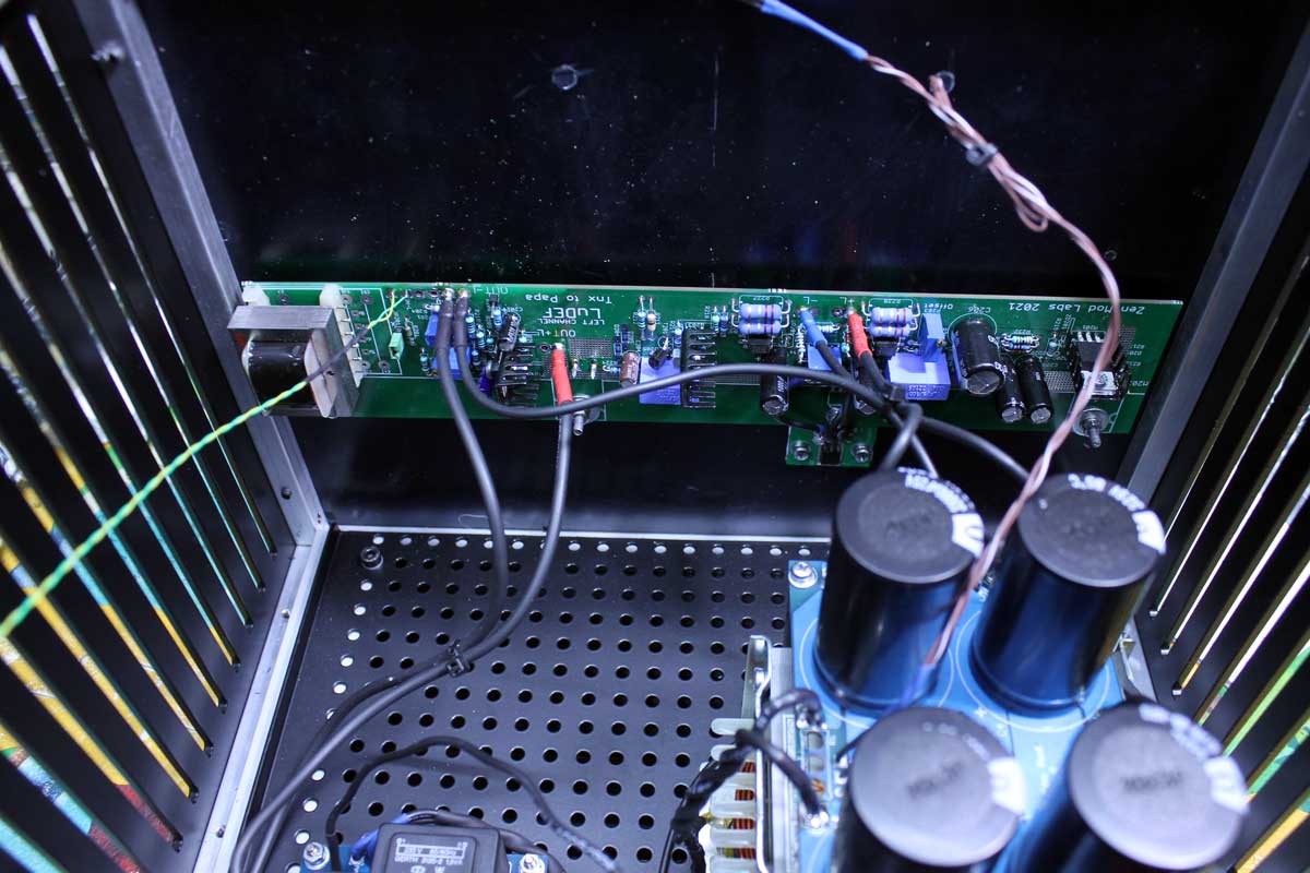

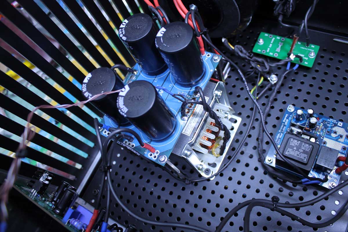

It's almost ready for testing! A couple of power wires and I m ready to go.

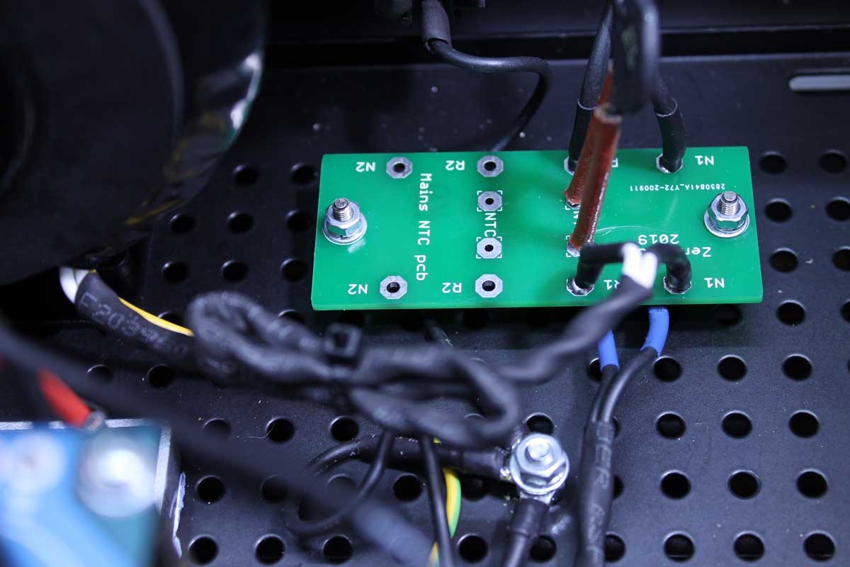

Since traces run near the edge of pcb, I used 3/8 tall (~9mm?) nylon standoffs with nylon screws and washer to fasten PCB to heatsink. Then, I am also relying on TO3p solder joints to hold the PCB via their metal screws. I had to enlarge the holes of said to3p on the pcb to make my life easier.
I am also giving detail pic on how I interfaced the lu1014 to the board. I think its a good solution easy to do.
