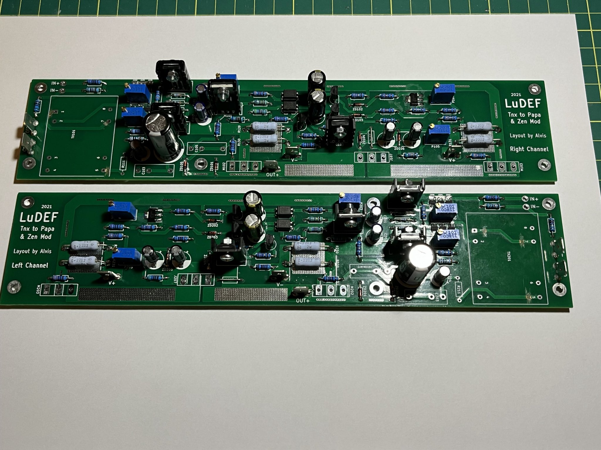

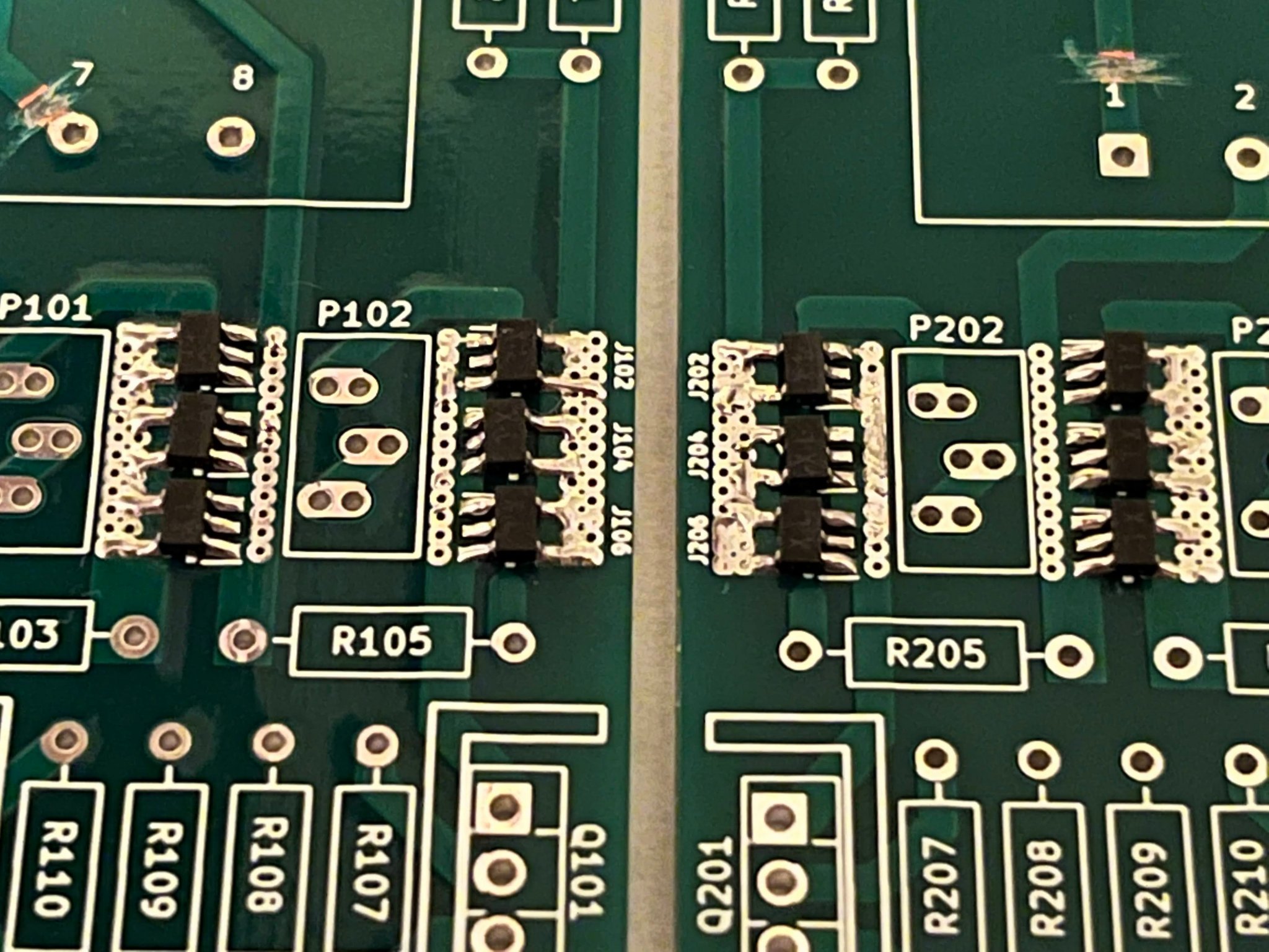

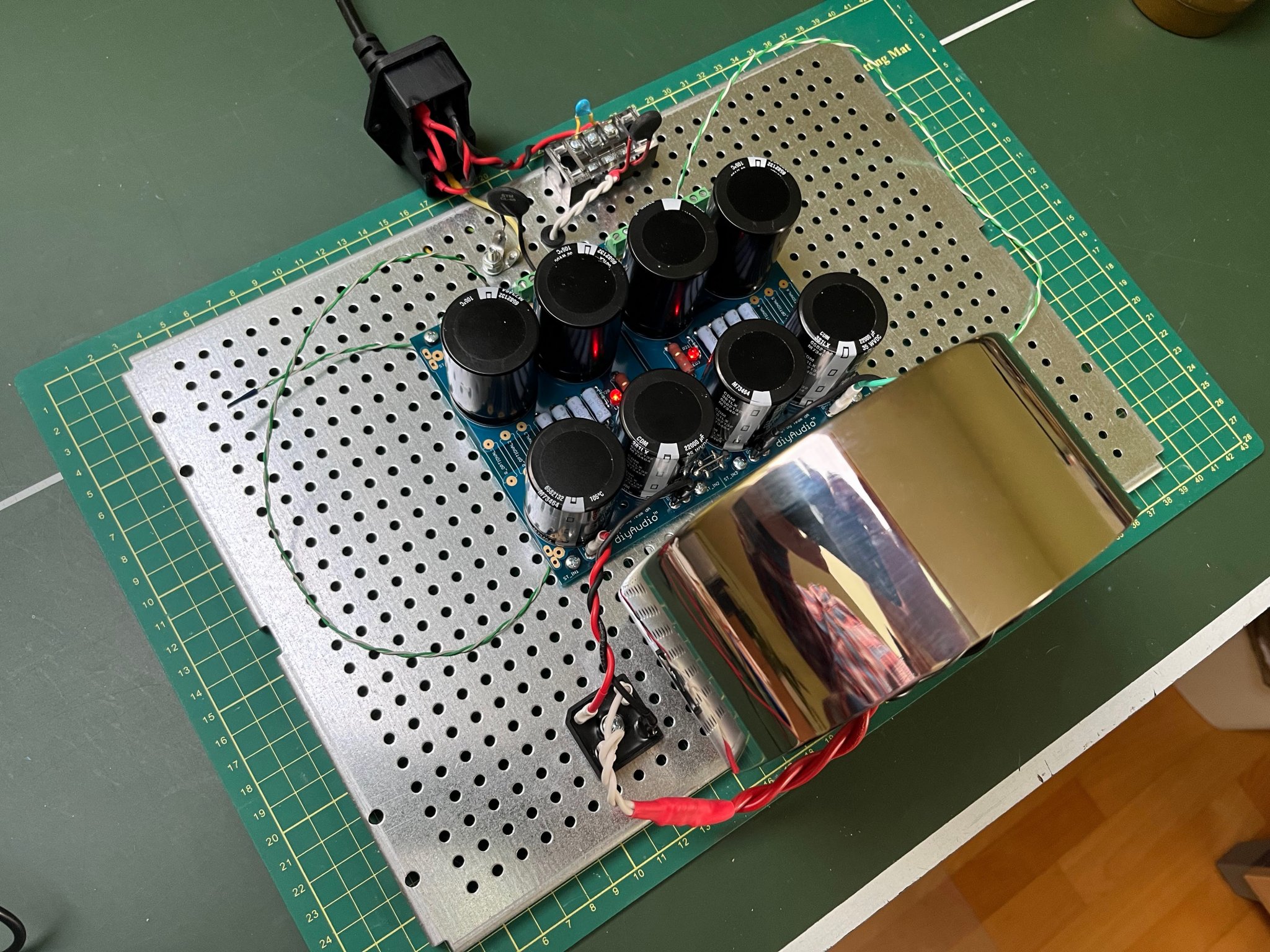

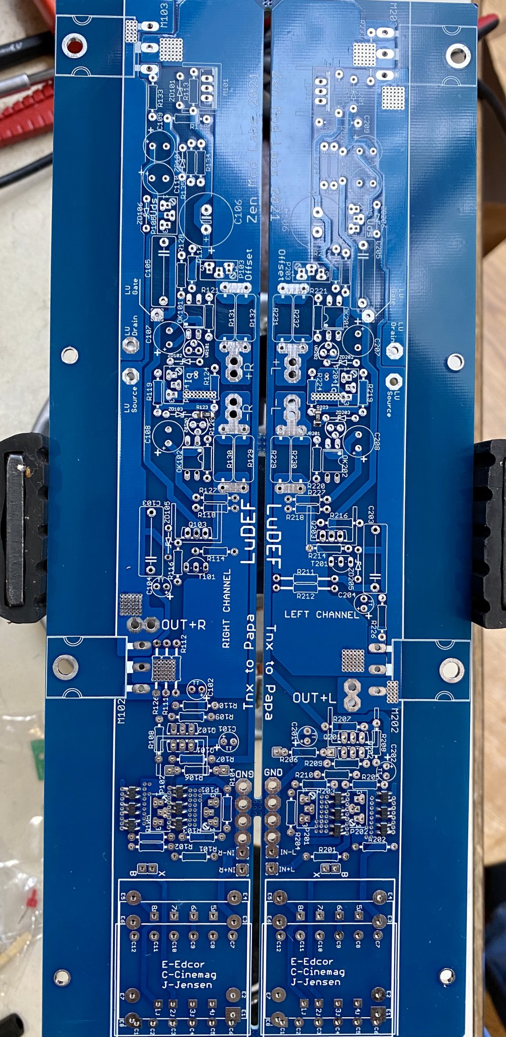

Hey, Zen Mod, the little critters you sent me are already on the boards! Not the cleanest work in the world, I know. But I am OK with myself about that so far. We'll see if I can be proud of myself when the bias setting time will come... 😉
And the PSU is waiting for the boards already. So now - the fun part - boards stuffing 🙂
I don't know exactly why, but I went with 2x19V secondaries this time (instead of usual 2x18V). Perhaps because this LuDEF has to be special 🙂 It gives 26.2V unloaded now. Hope this is to the better, not the worse...
Thanks a lot!
Alvydas

Whatever you say about it - nobody in the world has that looking LuDEF 😀

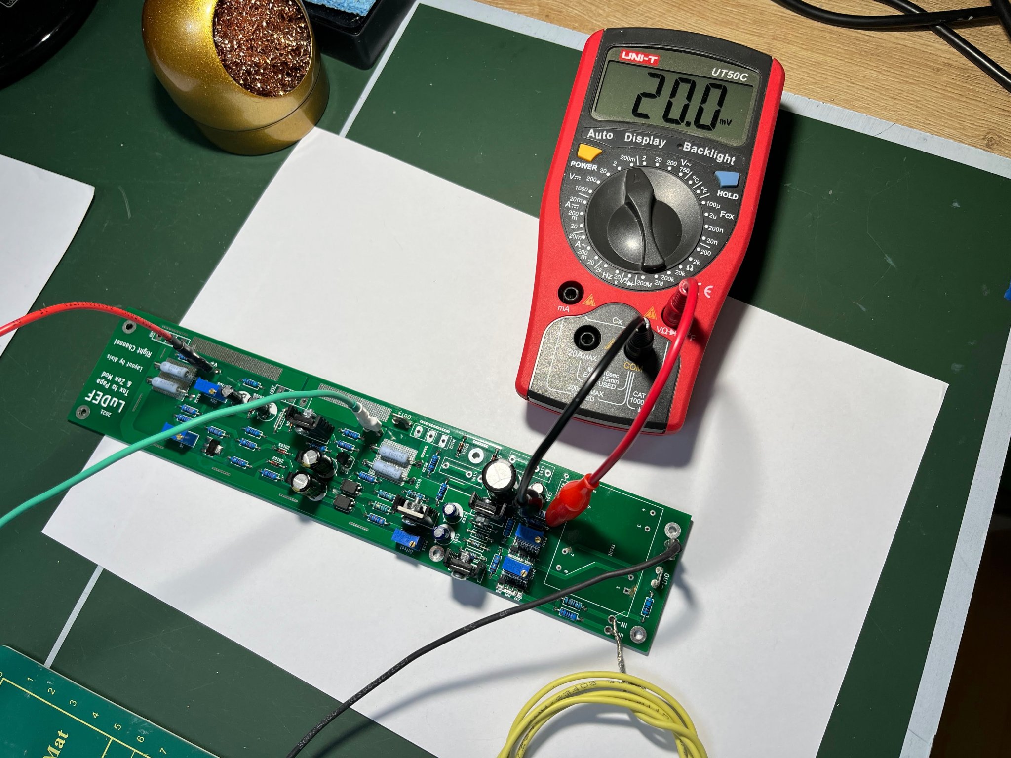

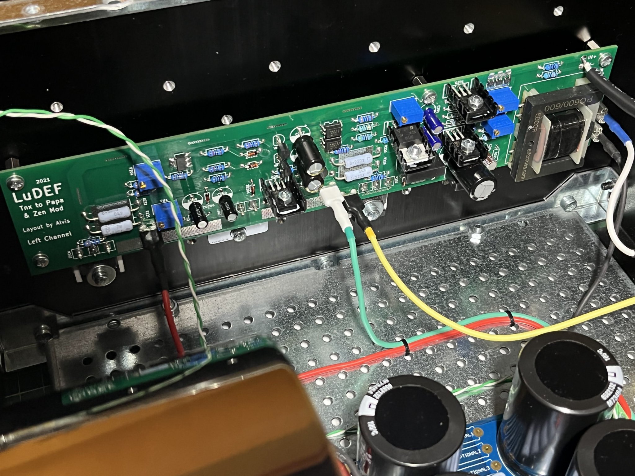

No bypass caps, autoformers and output devices on the boards yet, but it's time to check on the setup process.
ZM, can you help me with that once more to be sure about the details.
My plan is:
1. With the state of the boards like they are now (no autoformers, no output devices and no bypass capacitors), I connect V+, V- and GND from the PSU to each channel and check if I can get 20mV on R106 with the help of P101. What about P102 - what is the purpose of it?
2. If I have 20mV on R106, I solder in autoformers bypass capacitors (still waiting for them), output devices and mount the boards on the heatsinks.
3. I set 2V4 on D-S of LU1014 adjusting P105.
4. I set Iq 1A5 (165mV accross R129) adjusting P104
5. I set DC close to zero adjusting P103
6. Reapeat steps 3 to 5 to get everything in balance.
7. Listening to some fine music.
Does that sound like a proper plan?
Alvydas
procedure more or less same as written ( see first post in proper thread) for SissySIT R.3
if you set buffer trimers as explained (lower one setting Iq to 20mA, upper one setting DC offset of buffer), you'll leave buffer setting for later, dealing first with OS setting
trimpot at CCS chip is for Iq setting ( preliminary set to 0 ohms!!!!) and other one is for amp Output DC offset
difference to SissySIT procedure is that somewhere after semi-set Iq, you need to tweak Uds of LU to prescribed
it is iterative process - setting Iq and LU Uds ...... takke care that final setting of that is done in temp equilibrium
not so important for Iq and DC Ofsett - but important for LU Uds
so- up to SIssySIT R.3 thread - read that..... think
Thank you, Zen Mod. Read it twice, thought about it, set trimpots as recommended.
As I do not have a jumper to disconnect the autoformer from the input, I decided to connect my PCBs to the power supply now and try to set up the input stage. All went smoothly!! Had no problems to set Iq to 20mA and zeroed the input stage DC without any troubles. And the smoke still stayed inside! So, looks that my iron SMD soldering skills were good enough to stick the little jfets to the boards 🙂
I suppose I am safe now to solder Edcors to the boards and brace myself for the next challenge - solder the LU1014 to their adapter boards. I will have to literally fry them on the pan 🙂 Greenhorn way of cooking... 😀 Wish me luck 🙂

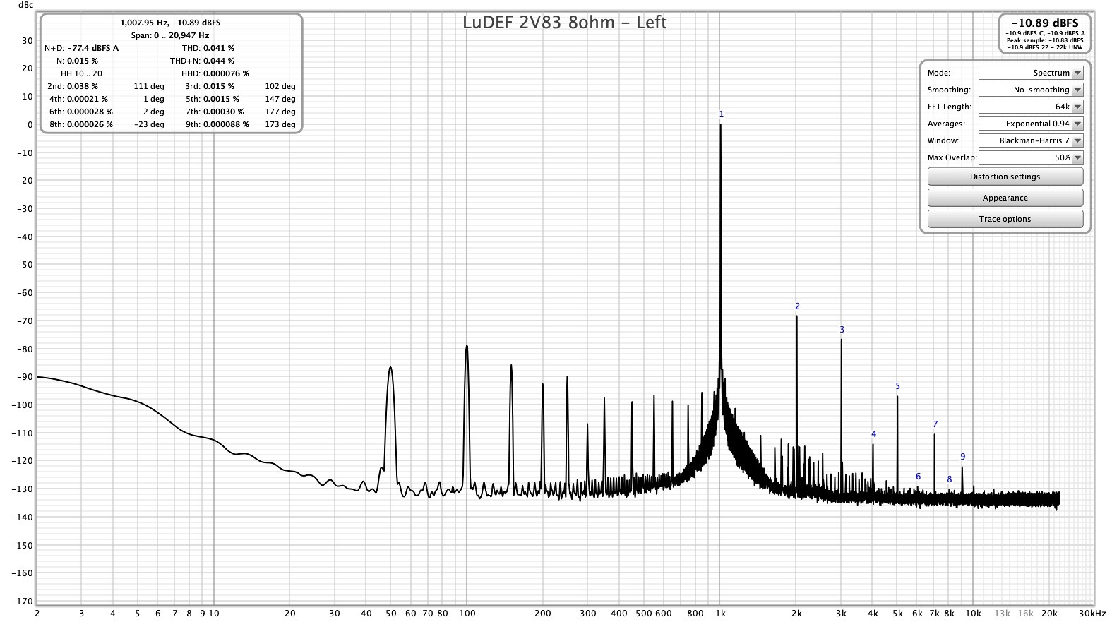

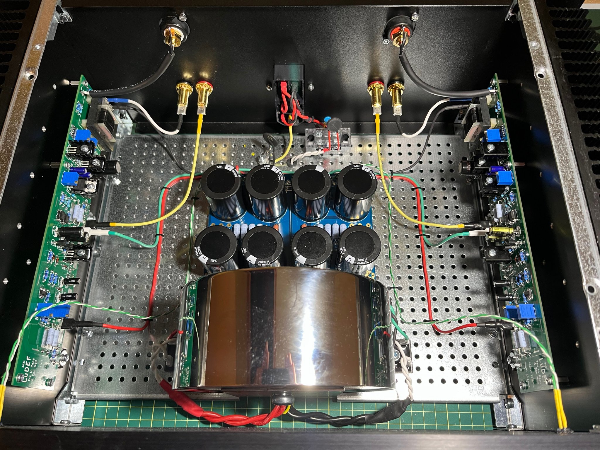

After a long and adventurous journey, my LuDEF is playing a "swanderful" heart-sweetening music today!
I know this one will be my favourite and dearest amp of all the 6 Papa/ZM creations that I've built and own (ACA, M2X, F5, Aleph J Zen, Aleph J and LuDEF). This amp is special to me in so many ways. That was my first ever attempt to learn KiCad, make my own PCB layout and order PCBs from a fabricator. I did make mistakes (some very stupid), had to find them and use some "bandage" under the PCB in the process, but that's the best way for every greenhorn to learn something, isn't it?
Another thing that makes this amp so special is the number of people and the great generosity of them that made all this possible!
My sincere thanks to Nelson Pass himself for donating the LU1014D from his stash, @woofertester for matching them, @JPS64 for designing the adapter board, @wg45 for organizing the group buy of the adapters and distributing the Papa's LU104D, Zen Mod for generously sending me all the matched input JFets and, of course, for the design of the LuDEF schematics and all the other things in the word he does for us, including all the good mood he brings here!
It's such a good feeling to contemplate about all these people and the challenges that I went through myself to build this one.

My LuDEF is doing fine and I am enjoing it all the day long. But I have a few questions concerning the temperatures.
Mosfets are running at about 60C and LUs at 50C, heatsinks (standard greenhorn 4U300) at about 55. All good, in my understanding.
Q103 and M101 are at about 60-65C - looks a bit on a hot side, but is it OK, or my heatsinks are a bit too small for them?
Q101 and Q102 are cooler, below 50.
What I am mostly concerned of is the power transformer. It's the first time I got the potted Supremer Audio grade from Toroidy. It's 400VA, and it runs quite hot, about 65C (above the Papa's X*?@! scale) and I cannot keep hands on it. Is it OK? I don't think my mounting has created unwanted winding around it (should not even be possible with the potted Toroidy x-former). As it is hotter than the environment, so it should be heating from inside.
I have never noticed the transformer heating with the usual Audio Grade from Toroidy in my other amps.
And a note about the output offsett. Noticed it is quite sensitive to the temperature as well. Merely taking off the top cover of the amp very quicky makes the offset to go from 0mV to about -50mV. And when you put the cover back, it gradually comes to zero again in about a minute or so. It's ok, just interesting.
Would be thankful for the comments.
