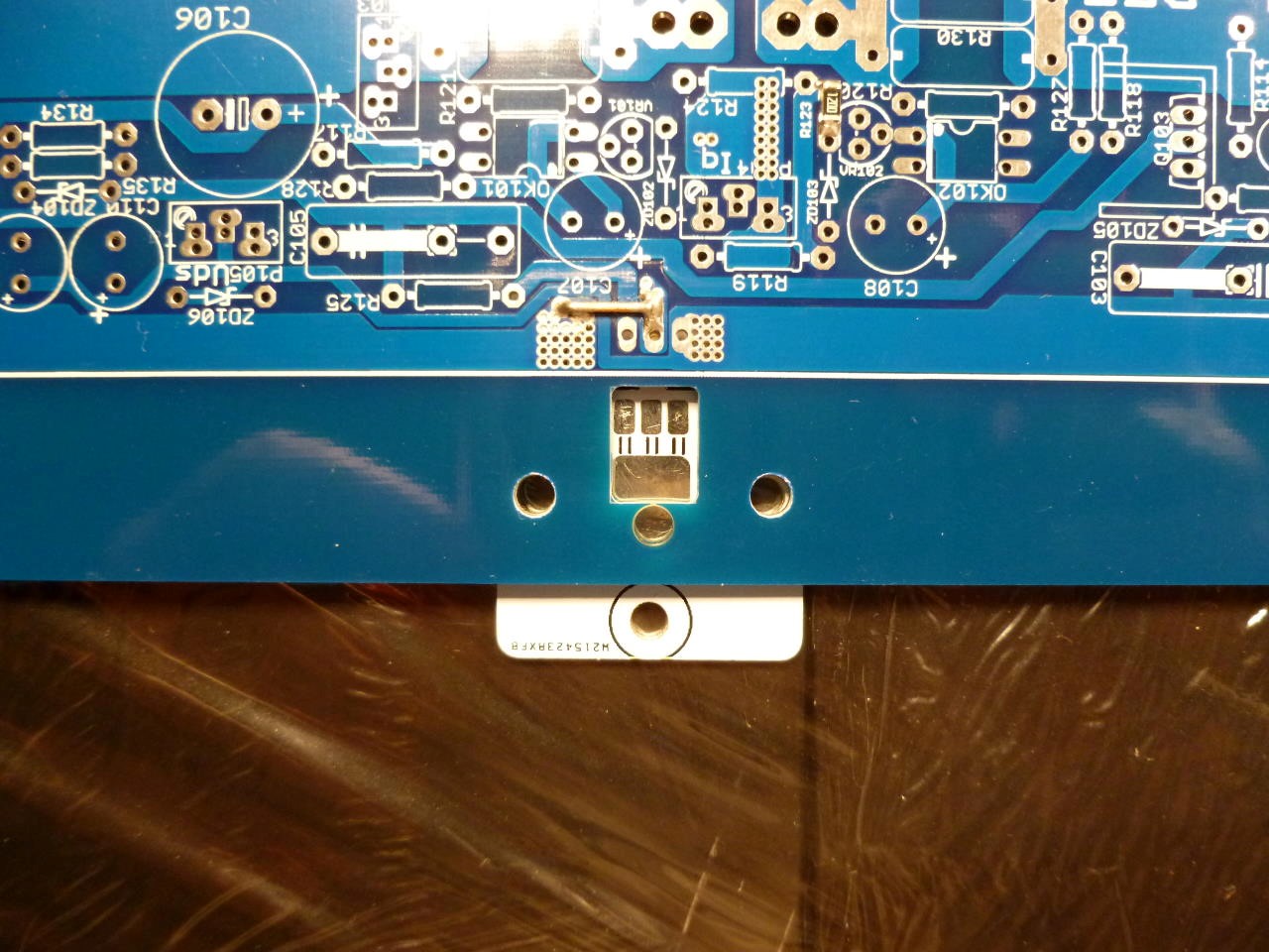

For proper thermal transfer, my intention is to mount LU on adapter board just like regular TO case would be, by soldering solid wire vertical pins, instead of long flexible wires. Two 3.5 mm holes at approximately 8 mm from PCB edge (+- 10 mm horizontally from existing hole) are at right position and wide enough for screwdriver.

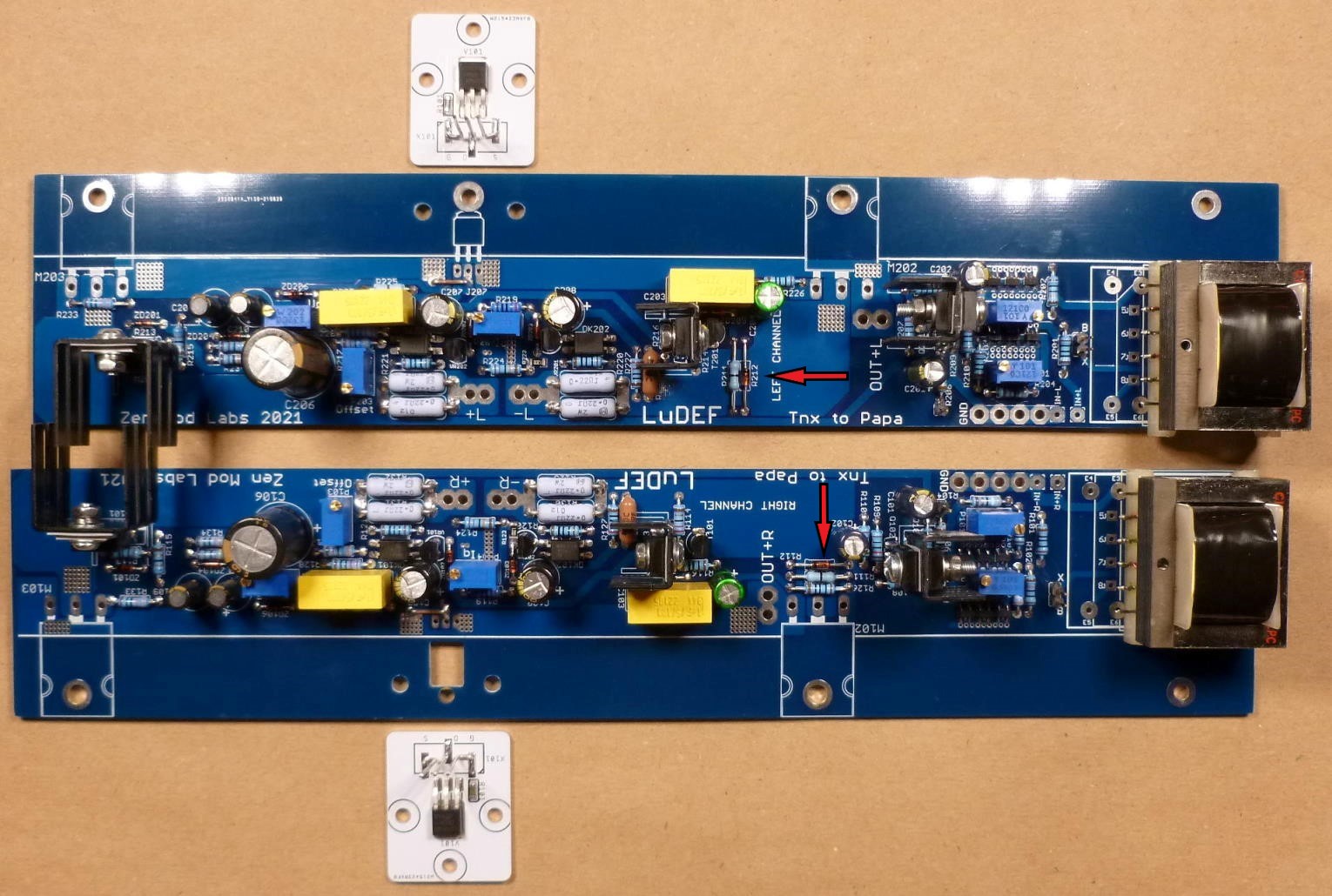

at first start right channel acted weird - found zd104 in reverse - fixed.
now both channels dial in pretty easily - work within specs on spot!
Lu on daughterboard is 5-6 degrees above ambient - no smoke...
still have to check for musicality - pics to come.
cheers
A.

Everything about mentioned ‘diode’ is explained at the linked thread. It is, so called, current regulator diode (in fact packaged JFET CCS). Replacing CCS biasing resistor, which is R112 (made a typo) with this ‘diode’ reduces effect of voltage ripple on base of BJT that regulates current.
Adequate parts are Semitec E-202 or E-272 ‘diodes’.
