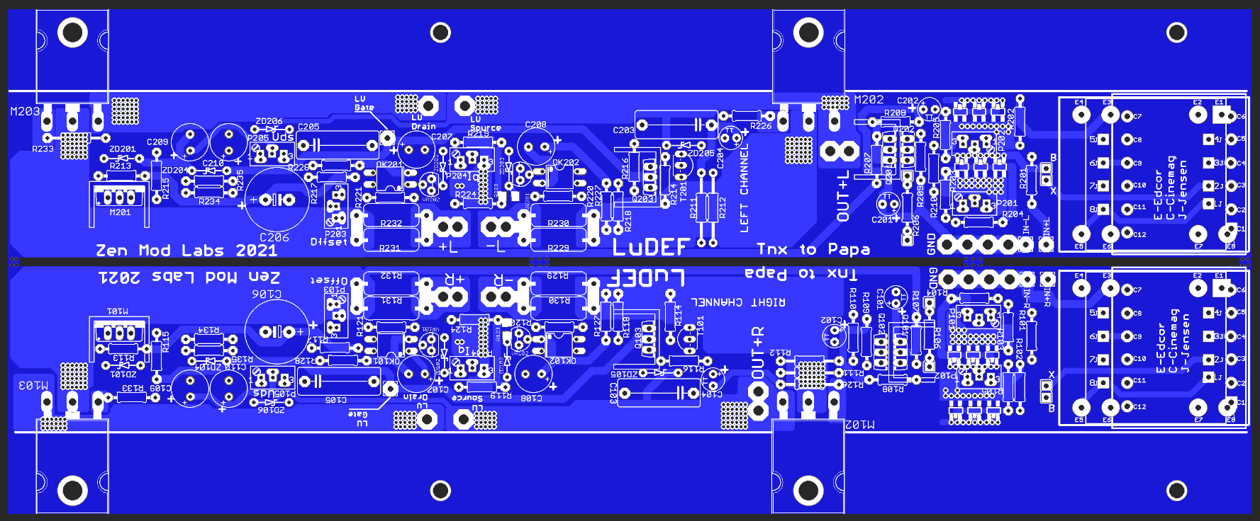

Cinemags arrived today! YES!
But now they came with 12 pins instead of 8. It looks like the 4 outer pins are not connected so maybe I can cut them off because PCB has only 8 pads?
I see the PCB has labels such as E1 5J C8. I am guessing c means cinemag j jensen and e edcor? It's gonna be a busy weekend...
from now on, both will be taken care of
decided that cutting Cinemag pins is stressful enough to Regular Greedy Boy, so from now on all holes/pads included (applies to all amps having 3 Repeaters FE)

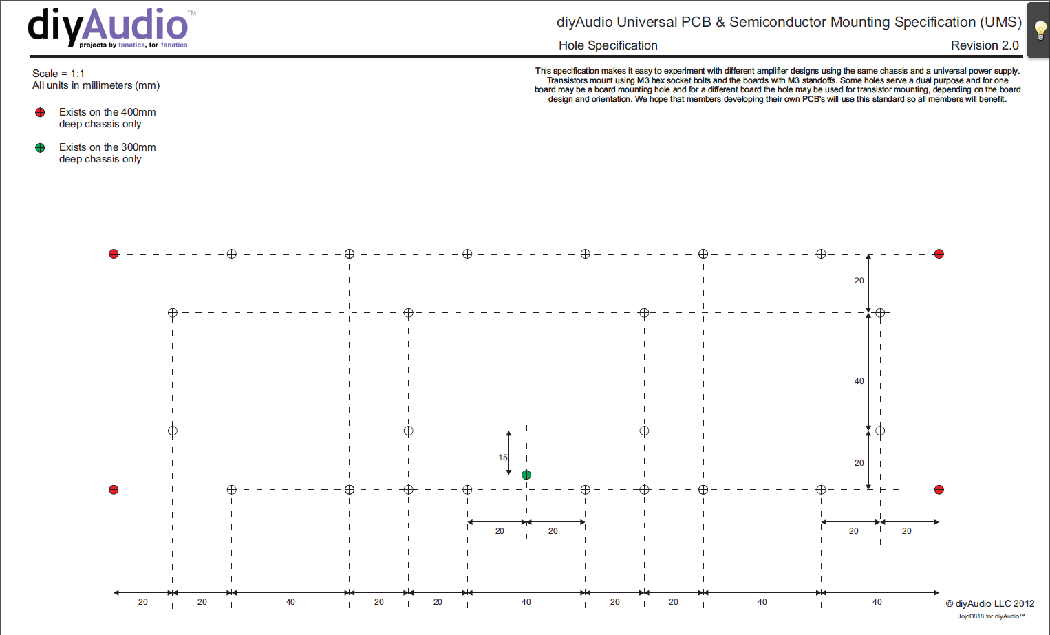

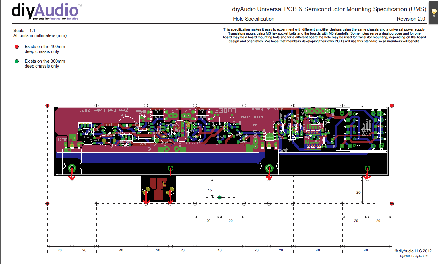

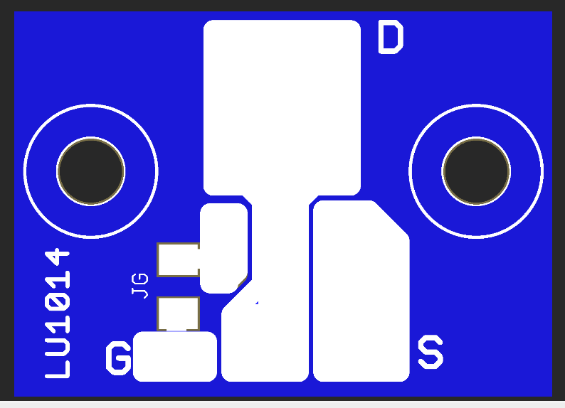

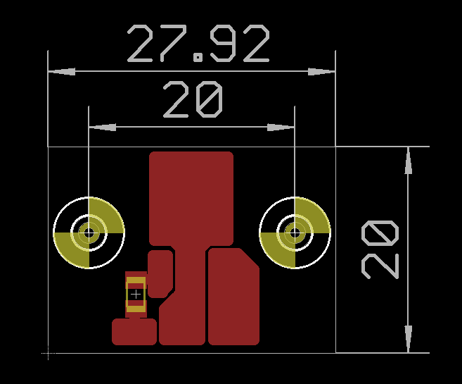

also - LU would be outboard (UMS compliant), small Al pcbs included in package, connected to main pcb with 2 thick and 1 thin wire
pics in time ...... when I get new batch of boards

One question: how critical is the distance of R125 from the lu device? I have already mounted that on the PCB but there is a provision for an SMD on the outboard PCB from the recent group buy. Can I disregard that?

some graphic info
