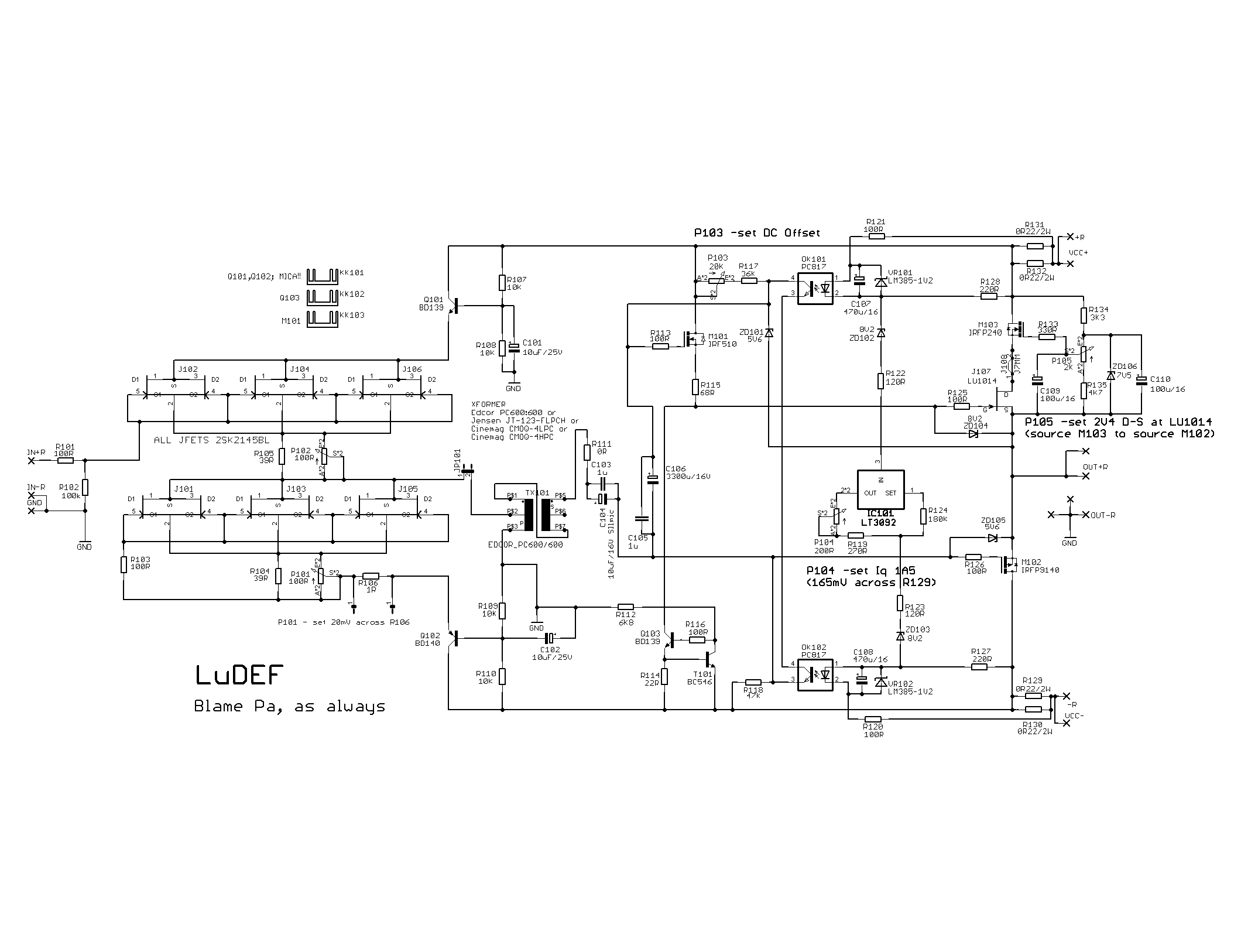

How are the signal transformers configured to produce gain, and what is the overall gain of this amp? I’m wondering if an alternate Edcor model might increase overall gain to ~17 dB.
post #1
Edcor 600:15K, used in M2, can be accomodated in, with some exacto knife and thin wire work
937325d1617106602-ludef-ludef-schmtc-png
Got it. Thanks 🙂
Front end gain of 2 with autoformer configuration of 600:600 repeater. Can go to gain of 5 with 600:15k and a simple tweak. I think I’m going to want that extra gain, so I have a pair of the 600:15k Edcor units on order.
Wait. Is the standard autoformer gain 4, not 2? That would make more sense, now that I think about it.
classic repeater coil, made as meat of Telephony, is 600R:600R jobbie
majority of them are actually made as each 600R (nominally) winding having CT, so practically being 150R+150R:150R+150R
all included xformers are exactly as that - so see schematic; input tap is one CT, you have one of "150R" to GND, while 3 of them stacked on, then output
that means - 1V in, (1+3)V out

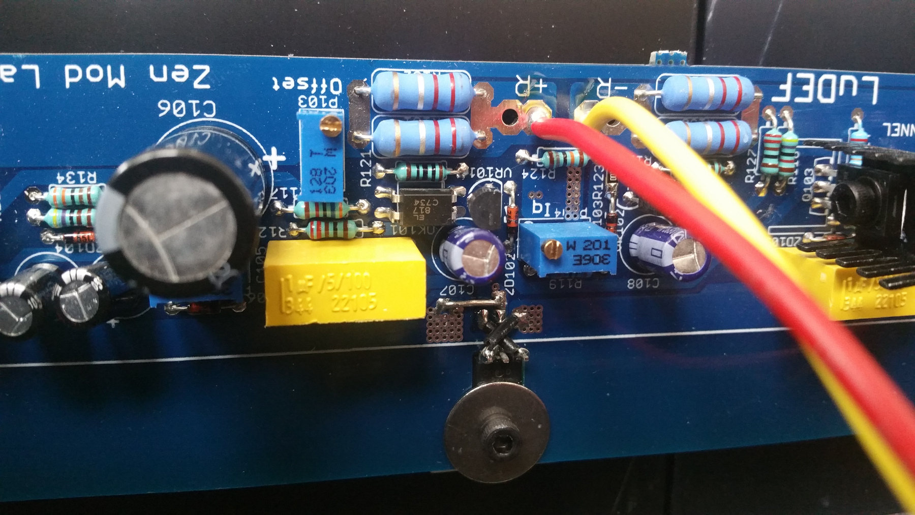

Got my LuDEF build up and running. One channel is rock solid, easy to adjust, no issues. The other starts up the same as the ‘good’ one and adjusts ok, but once it heats up all three measurements on the output stage start fluctuating and offset starts drifting up and down. Both channels make music.
Anything is should be looking at specifically to start? Thanks
Hmm, I also have one channel OK and another at -17 V output and with no reaction to any Iq or offset adjustment. Checking voltages, revealed that no current flows through LT3092 (no voltage drop on resistors or Zener diodes) but electrical continuity is OK. Today, I’m receiving a new LT3092 and we’ll see.
What you describe could be a malfunctioning LT3092 CCS.
Zen Mod, you should not stroke your beard while working on boards. It’s an electrostatic generator. :rofl:
increase gate resistor of IRFP9140
same for LU
how LU is mounted - as intended or with wires?
bummer - I can say that every step while soldering and managing them is pretty ESD - free, and this is first one claimed Dodo?!?
certainly less stressed than with common SMD solder-bath .......
you can increase them (gate stoppers) without fuss to 220R
one thing - to be sure that LU itself is not behaving badly, only way is to replace it, or to switch them (LU) between channels
if problem goes with LU, that's it
if problem stays with pcb, well, it's rest of circuit

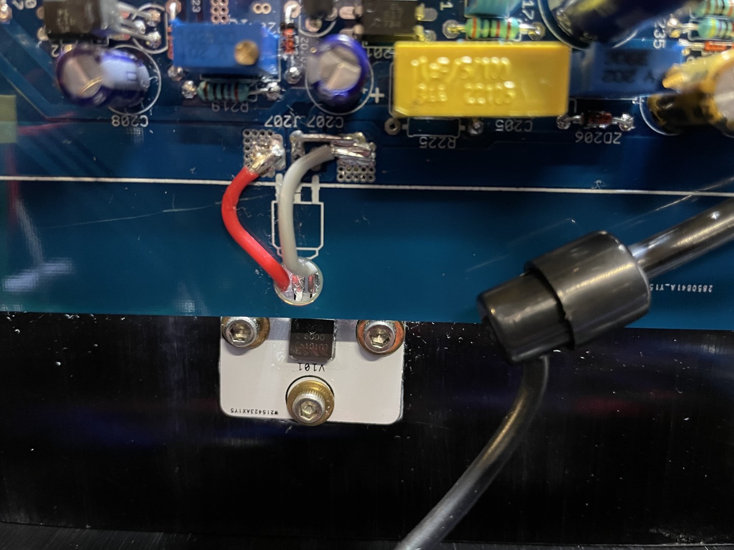

I had to reverse the outer pins of one of the LU1014's since I mounted it flat on a
heat sink and not on a flange like Zenmod.
You might double check the pin connections from the LU1014 to the PCB.
A picture is worth a thousand words. Probably, but few words of warning wouldn’t hurt like: “Pay attention, right channel LU is flip mounted”. Now that this is mentioned several times it is enough of warning. I’m probably not the last one that could make this mistake with the current PCB version and adapter boards.
Meaning of those pictures at posts #6 & #7 didn’t penetrate my thick skull as I just glanced at them. Happily soldering with switched off brain can end with interesting results. 🙂
