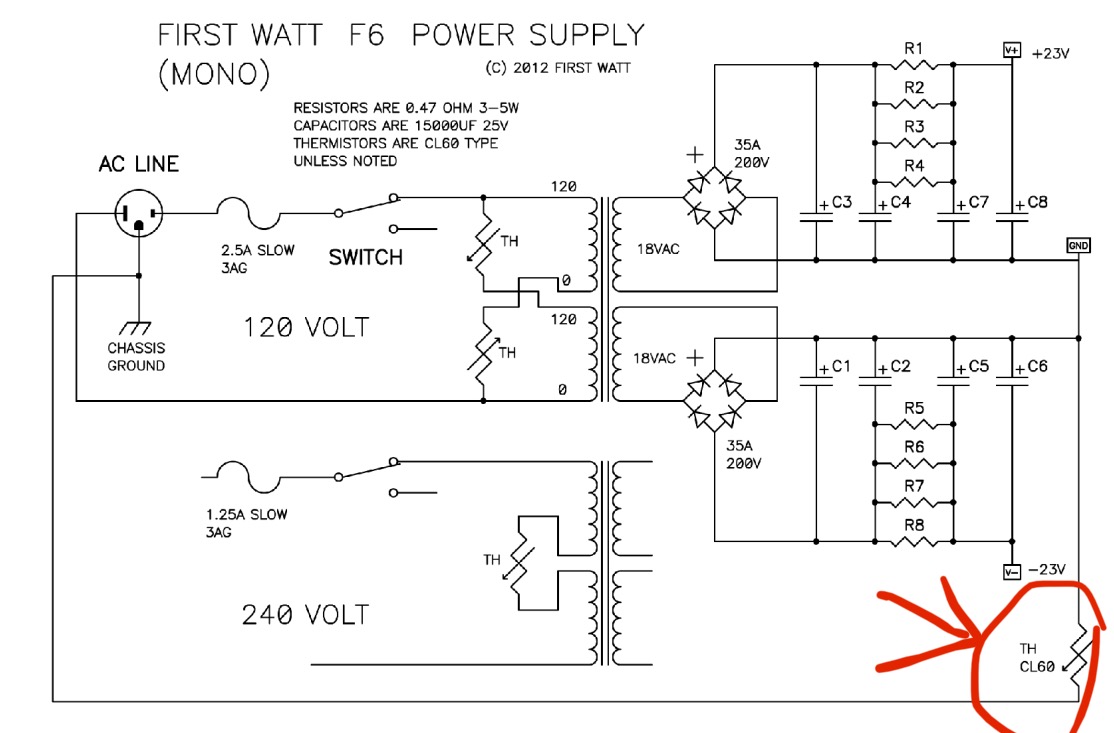

While I am also having life obligations like getting furnace and cars ready for winter I am thinking about the diagram you posted for me to show how to connect dual primary donuts to the NTC boards for us gringos over on this side of pond.
I spent more time researching and reading about thermistors and how they control in-rush current with high resistance in cold state changing to low resistance once warmed up...also looking at examples in other threads like 6L6’s F5 build guide.
I originally thought I had no understanding of the thermistor wiring in the First Watt power supply circuit diagram I posted.
Then I realized that in fact it does show thermistors wired differently for each primary on the transformer...which was demonstrated by 6L6’s guide.
One is wired to the Line (115-120) on one primary...the other is wired to Neutral (0) on the other primary. There is also a thermistor to ground.
I am just wondering what reason there is for this arrangement.
I have seen other examples of thermistors installed as you have advised in your diagram on just the Line (115-120) primary connections.
We are simply trying to control the sudden large current surge when we power the amp on.
Does it not matter where the thermistors are located?

well - just take it this way - NTC and winding are in series ..... it is really irrelevant in which order you are putting them
what I did show in sketch for my NTC pcb is most convenient way to use that one
observe that in Ole Country - I mean - on this side of Pond, in most countries mains plugs are not polarised as they are on your side of Pond..... so even position of switch and fuse ( are they in Phase or Neutral is not strictly declared .......... but (in Eu) that is also calling for dual switches - always best to switch both leads , simply because you never know their orientation
so, just chill

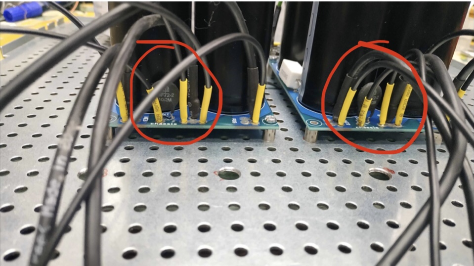

@pfdavid
Yes that is how I am interpreting it.
I am using Mighty ZM’s Cap Bank boards.
He has been generous in supplying a convenient neat little way to mount and connect said third thermistor.
See pics

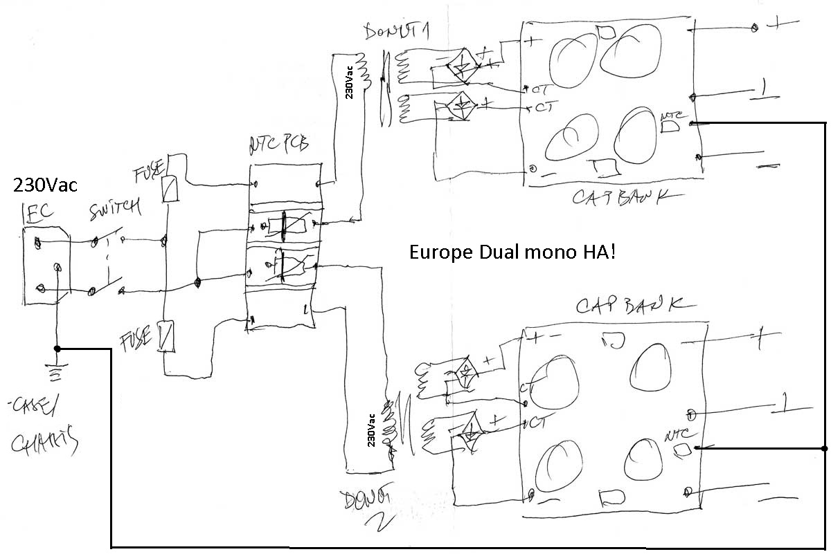

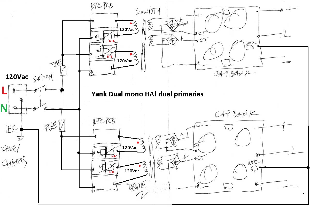

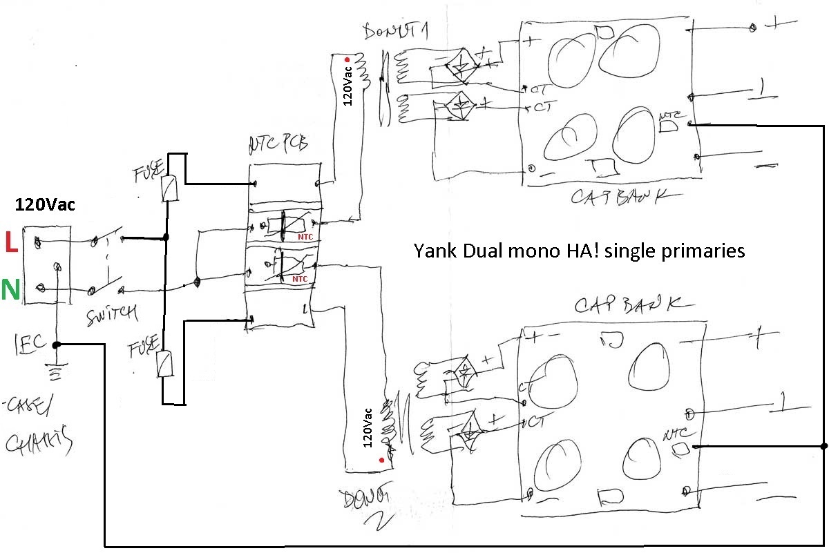

usefull addendum to sketch from post #532
this one for Europe, dual mono
So, fuse not in the same mains pole fo NTC?
I can't see how is that important
fuse will blow if it is in circuit
NTC will do NTC thing if it is in circuit
it is in circuit, be it in front of primary or after
rotate picture by 180deg ........ everything is still going to be the same
