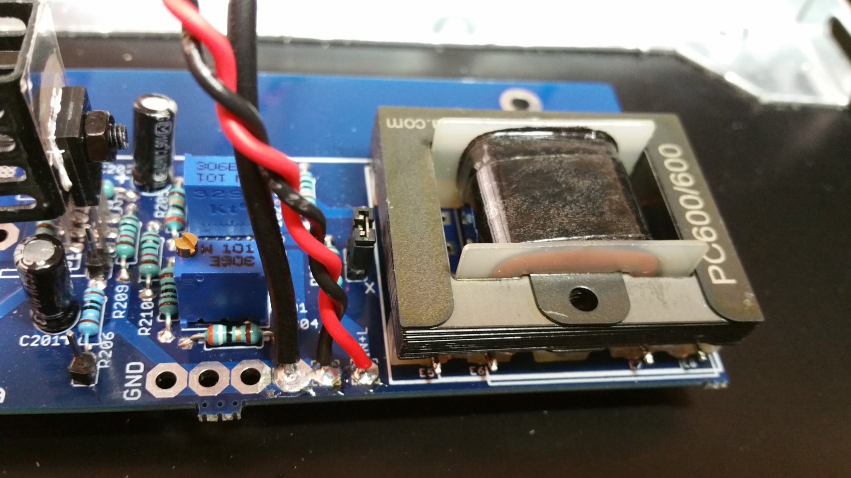

I've completed a LuDEF!
The pot adjustments for offset and bias all
went as expected with correct values set.
But audio output is extremely low on both channels -
can just barely hear it.
I've checked all the values and part locations.
I'm using an Edcor 600/600.
Is this the right one?
I noticed Sissy and M2 use the Edcor 600/15K.
-Bruce
you didn't forgot jumpers , JP101 and JP201? :clown:
check continuity between JP pin marked X and R111
write down resistance
check resistance/continuity between JP pin marked X and GND
Yessir!! JPX01 jumpers were on!
Resistance between JP pin marked X and R111 - 105 ohms
Resistance/continuity between JP pin marked X and GND - 38 ohms

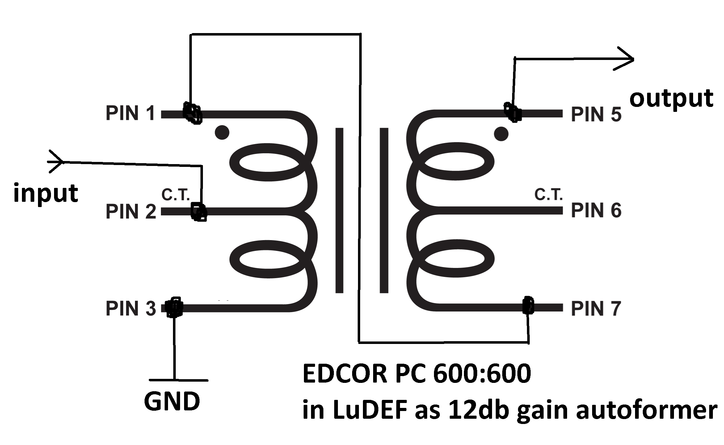

your measurement is confirming that autoformers are connected and in continuity
just checked - everything is by the book, Edcor PC 600:600 pinout just snatched from their site
see enclosed
do you have scope, or if not scope , at least some handy signal gene, able to give under 1V of anything between 400Hz and 1KHz - that you can measure directly with DMM set at Vac
if something is about autoformer, it can be only wrong phasing mark on Edcor site

I put 300mv of 1khz signal in.
At the B pin of the open jumper I get 300mv.
I closed the jumper and at Rx11 on both channels I get nothing.
On the Edcor I get these readings:
Pin 1 - 584mv
Pin 2 - 300mv
Pin 3 - 0v
Pin 5 - 0v
Pin 6 - 300mv
Pin 7 - 584mv
I will begin double checking everything and take pics.
I have a Cinemag on order - don't know when it will come though.
-Bruce

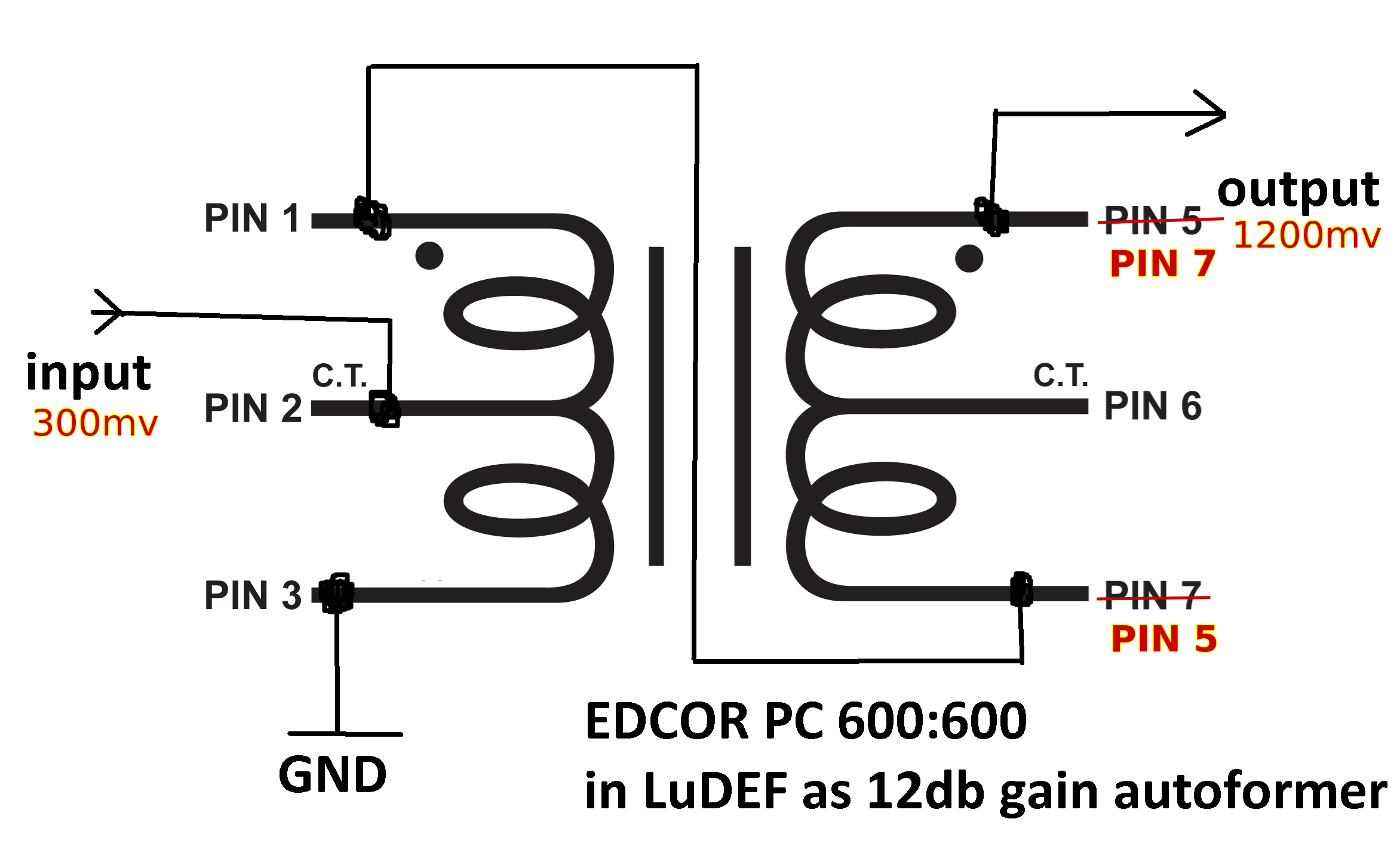

I did an experiment with a spare Edcor 600/600 transformer on the bench.
It looks like its primary/secondary are reversed from expected.
Configured as it is used on the LuDEF pcb with pins 1 and 7 connected I
put in a 300mv 1khz signal on pin 2 and got nothing on the output (5)
Configured with 5 and 7 reversed I got 1200mv from the output pin (7)

Many Thanks for the troubleshooting help Oh Mighty Zenmod!
I reworked the offending Edcor parts and reinstalled them - didn't want to cut up a fine PCB!

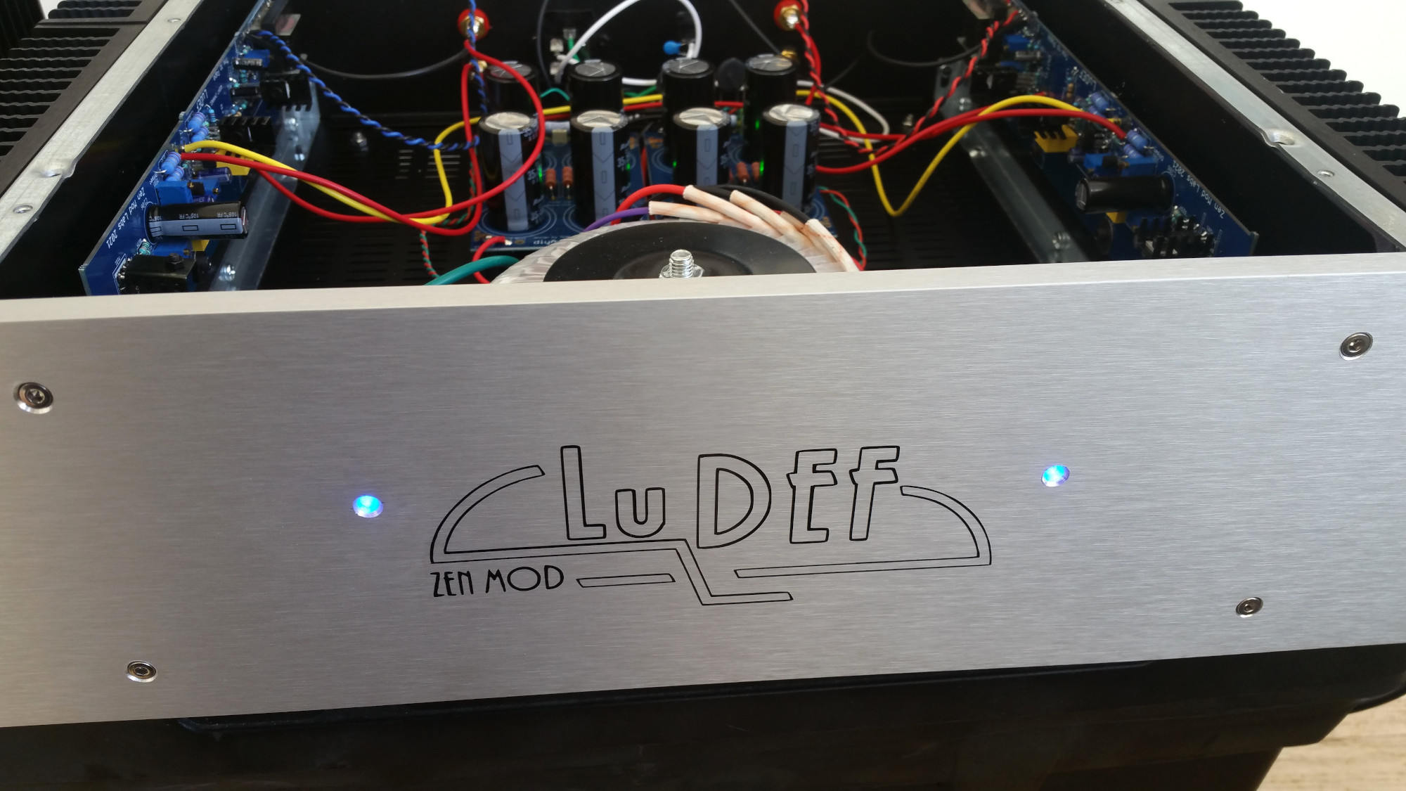

I did a quick power measurement and LuDEF
goes right up to around 25 watts into 8 ohms at clipping - very nice!
And now they are playing beautiful music!
Very fine, detailed - magnificent!

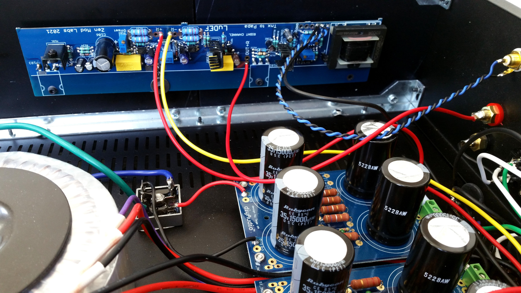

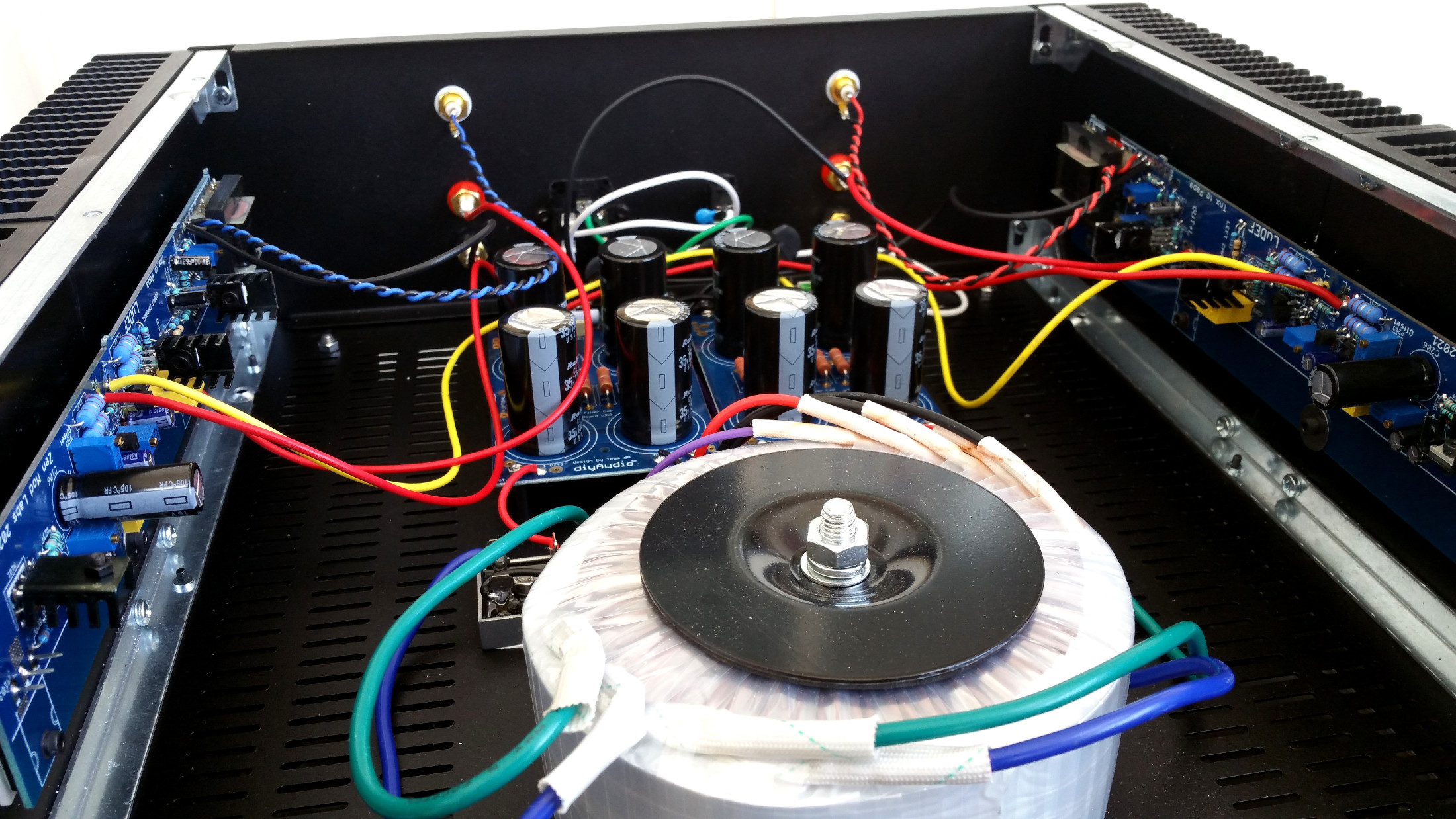

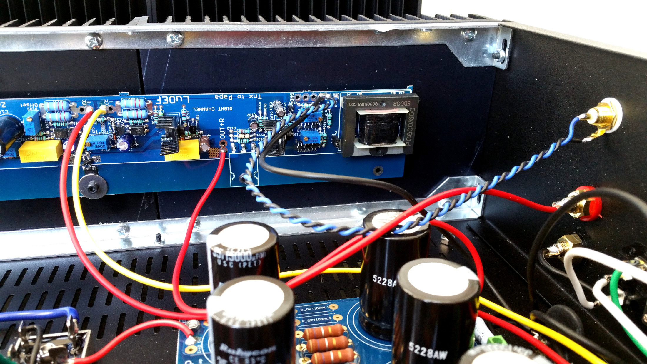

Some photos of my build:
-Bruce

Great detective work banderson546! Now just twist those power wires and you'll get an official 'fugly'! :cheers:
But as this seems to be the first LuDef in existence outside of the OPLDF, you deserve an award. :cheers:
Fugly! (means awesome job in ZMEngrish)

Fugly!
and inventive - including how you decided to take your own care of LU mounting
:cheers:
Bruce, can you please explain how you reworked the Edcors that you did not have to cut vías on the PCB?
-Alvis
The rework I did reversing pins 7 and 5 on the PC600/600's
was not as clean as I would have liked - I'd call it crude but effective.
I snipped off the thin magnet wire on pins 5 and 7. Scraped off
some coating on the end of each wire with an exacto knife.
Then soldered extension wires to extend each pin over to the correct pin.
I covered the wire extensions with a small piece of insulation.
I could have done cuts and jumps on the PCB but I was trying
to keep it original so I wouldn't have to undo things
if sometime I wanted to install Cinemags.

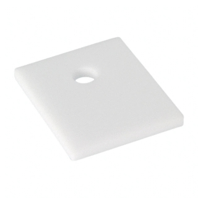

I used Aluminum Oxide Ceramic Thermal Pads from Digikey (4180G-ND) for IRFP240's,
IRFP9140's and the LU1014's.
For the LU1014's I put two pads under each one with each part facing up.
On the Right Channel PCB, extension wires from the two outer pins of the LU1014 part
to the PCB had to be reversed.
