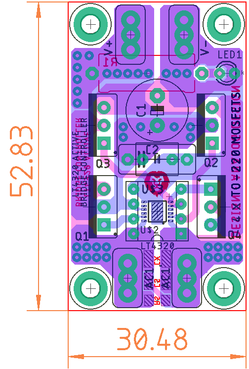

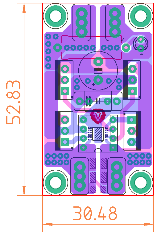

Hi Prasi,
I have used the THT in my Alpha amplifier.
They're great :)
I like the snubber option, on the pcb is the best place where you can put a snubber.
I find LED indication only useful if it's also used as bleeder for the caps.
Now I've added 3w 3k with 20ma leds as bleeder across the PS rails.
The THT should remain a thick PCB, those thick wires from the transformers put a lot stress on the PCBs.
Grts,
Danny
Thanks Danny for your comments and also congrats on great build of alpha amp with LT4320.
Yes, I will put a large size resistor at the bottom of PCB for LED indication which will also work as a bleeder.

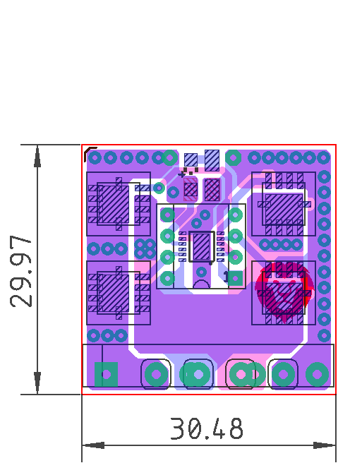

I can put SMD snubbers as option on THT but for SMD rectifier, they will take up too much space and reduce current carrying copper area. Lets see if I am able to come up with a solution for SMD also.
regards
prasi
Here are drafts for tht and smd. lots of copper and vias for tht also. thicker traces all around.

I'm actually not sure about SMD snubbers... because of the (to me) unknown power dissipated by the snubber resistors. Which power handling capability do they need? Maybe 1/3 Watt? ...? I'd prefer at least the snubber resistor to be a THT component which could be placed vertically to save board space...
