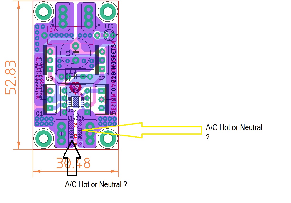

Please clarify hot or neutral phase on pic. Thanks
This is not a mains circuit. You need a transformer ( with dual secondaries) in between with secondary voltage of less than 50VAC. One pair ( 0 and <50 VAC), is connected to the above board to get rectified DC voltage and then further apply smoothing bulk caps to get DC voltage to apply to your amplifier and other circuit.
