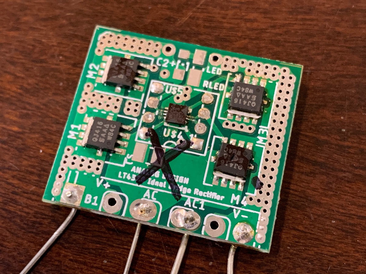

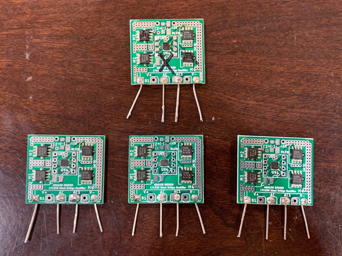

I'm not sure if anyone else has built and tested their LT4320 ideal bridges yet. I assembled a set last night and ran into a lot of problems with the small VSON10 based package. I have built many other LT4320 bridges in the past and have pretty good SMT soldering, and never ran into problems like this before. 3 of the units tested out and work. The 4th exploded one of the MOSFETs with a pop and spark and smoke upon power up with a 250VA 25vac trafo input. I replaced the MOSFET and it still exploded. I re-installed the LT4310 but still explodes MOSFETs, I assume it was killed and osicllates or something upon turn on so instantly destroys the MOSFETs - they become shorted out. In looking at it, I think it may be that these boards were not finished in ENIG and the HASL is kind of rough. It causes maybe small misalignments/shorts or cold solder joints on the tiny underside pads. So perhaps these should be used with the 12 pin MSOP or the DIP pacakge only, not the VSON10 which requires a very precise smooth surface to attach to.
Here are my 4 units with the bad one marked by X. I ended up toasting 4 MOSFETs and 2 LT4320's trying to debug it. Will just toss it and start new.
attachment.php
Here is the problem one:
attachment.php
Otherwise, they work well - just avoid the little VSON chips.

Yeah, the SMD version of the LT4320 is really tiny. I wouldn't attempt to solder that unless I had a good binocular microscope and a special tip for my soldering station. Maybe a hot air tool as well.

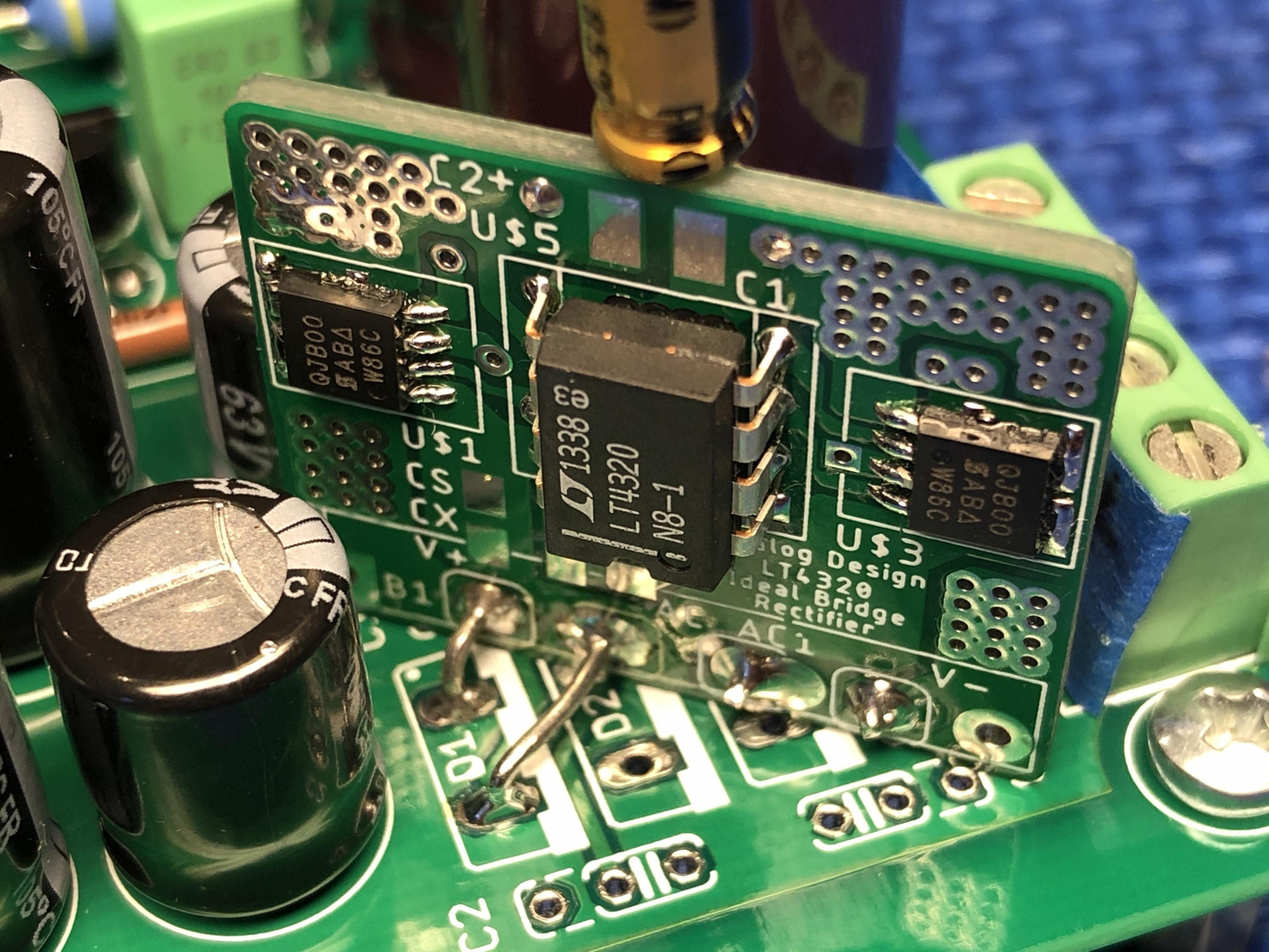

I've used pcb sockets on the different pcbs (Prasi single fet, Prasi dual fet and SLB) with just the 8 pin chips - so far, so good

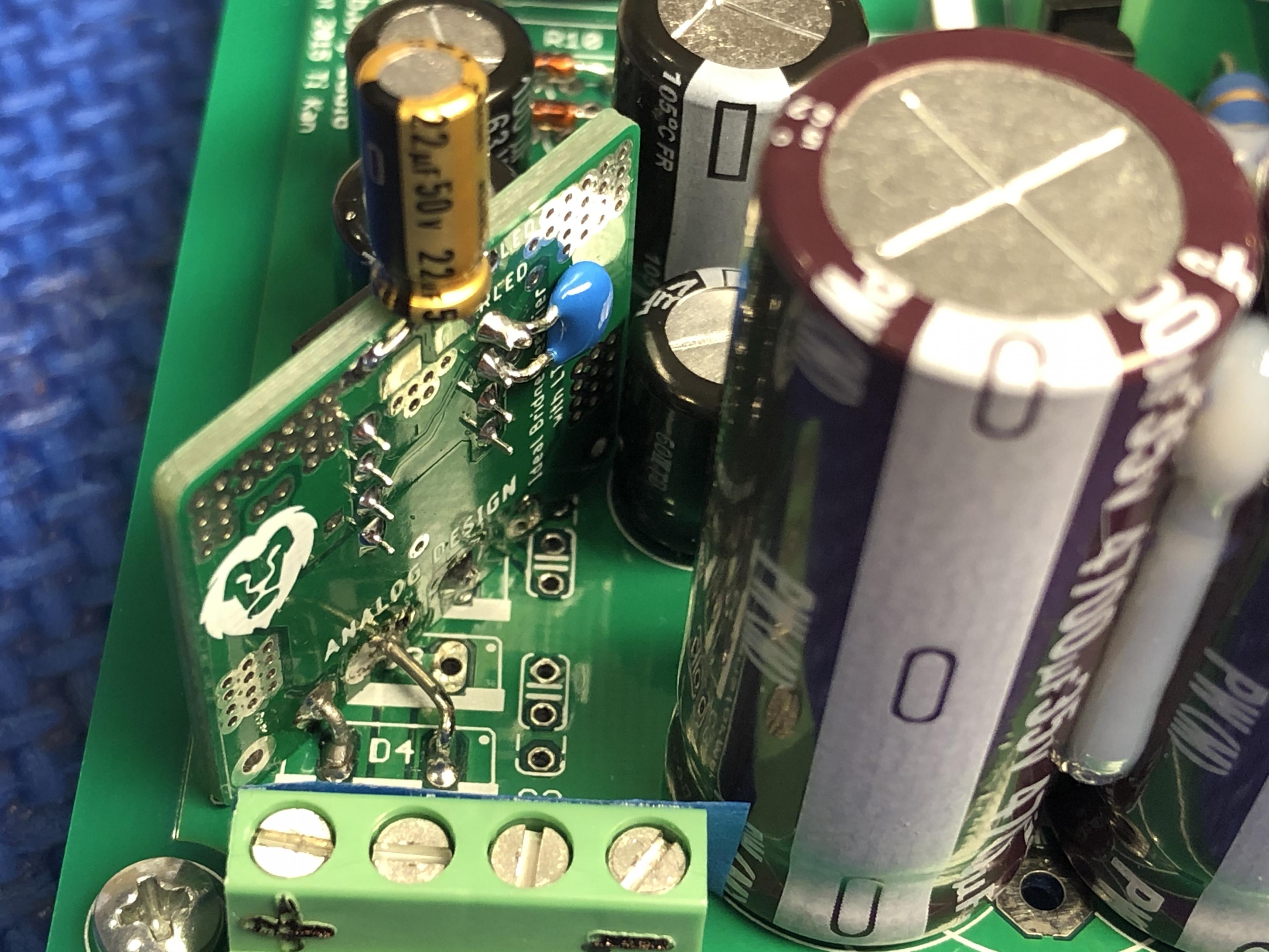

Like in the photo above, I've used the solid copper wire and bent the long legs (with insulating sleeves) to replace the 'normal' diode bridge rectifiers (not the SLB) - the Salas L-Adapter board wasn't so easy but it works very well too.
I actually have hot plate and hot air gun and have successfully soldered VSON chips before successfully. But always on nice smooth ENIG finish boards. The MOSFETs are no problem, but these bottom facing tiny pads really require a smooth surface. The MSOP12 version is not too hard to solder for SMT. Really no reason to use this one unless you are trying to really make it tiny.
I also recently built one of the smd board versions, but cheated and used the LT4320 DIP8 package. It’s replacing the standard diodes on an AMB Sigma11 psu. With a bit of creative positioning it fits perfectly!!
