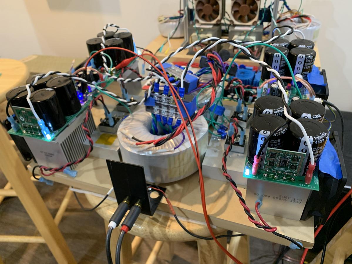

Yes, I have a 1uF 100v X7R at C1 on the other side. I don’t think the snubbers are needed with the idea bridge.
I made a new board with DIP8 and it works fine.
I got an extra 4vpp on the rails now for my Aspen Omega amp. That’s a huge difference for watts on the top end. You can see the old bridges and heatsinks that thy replaced. It took this amp from 25w to 35w, not bad.
