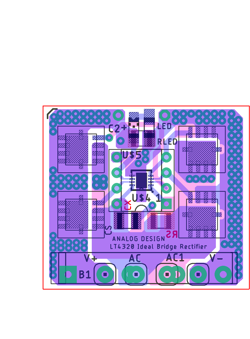

Hello Wlowes,
Please find below the BoM.
Please note that there are many options for mosfets. Choose the best ones for your application as per the guidelines posted by tvicol posted towards the beginning of thread.
Also LED/its resistor are optional. Also optional are the quasimodo components CX/RS/CS.

Thanks. This is very clear.
I look forward to comparing this innovation to the existing super soft recovery diodes I use in my digital front end today.

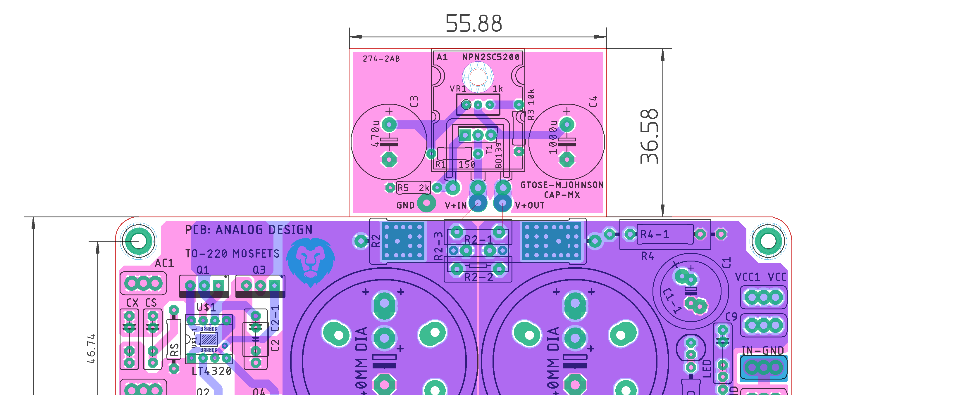

Hello all ,
almost 70% deliveries completed.
Here is a concept/try out suggested by a kind gentleman-member. Instead of the "R", a simple cmx by gtose / mark johnson can be "diy-ed" like shown as a daughter board..
If anyone is interested, I will post the gerbers for the daughter board.
regards
Prasi
P.S. same board can also be used for negative rail by reversing cap orientation and PNP/NPN substitutions of transistors.😉

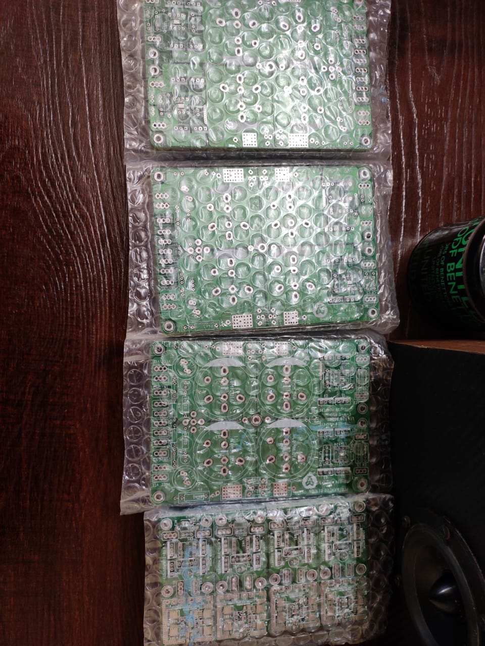

Hello all,
Hopefully everyone is back from holidays.
I have received the PCBs almost a week ago for the above GB.
I will start sending invoices today evening. If you havent sent me your paypal and address details , please do it as per your convenience.
regards
prasi

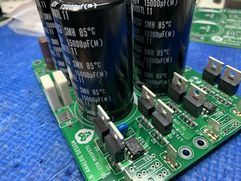

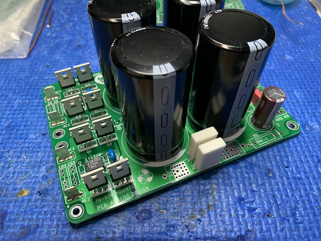

Hi Prasi,
One tested and working properly. No bleeders yet but they will be added.
Thanks again for everything!
Do
Hello Do,
Exemplary work!. I always , for myself , use sockets for 8 pin DIP opamps, that way I can use different opamps.
Here too, since LT4320 are somewhat premium, use of sockets would help in easy swap.
regards
prasi
