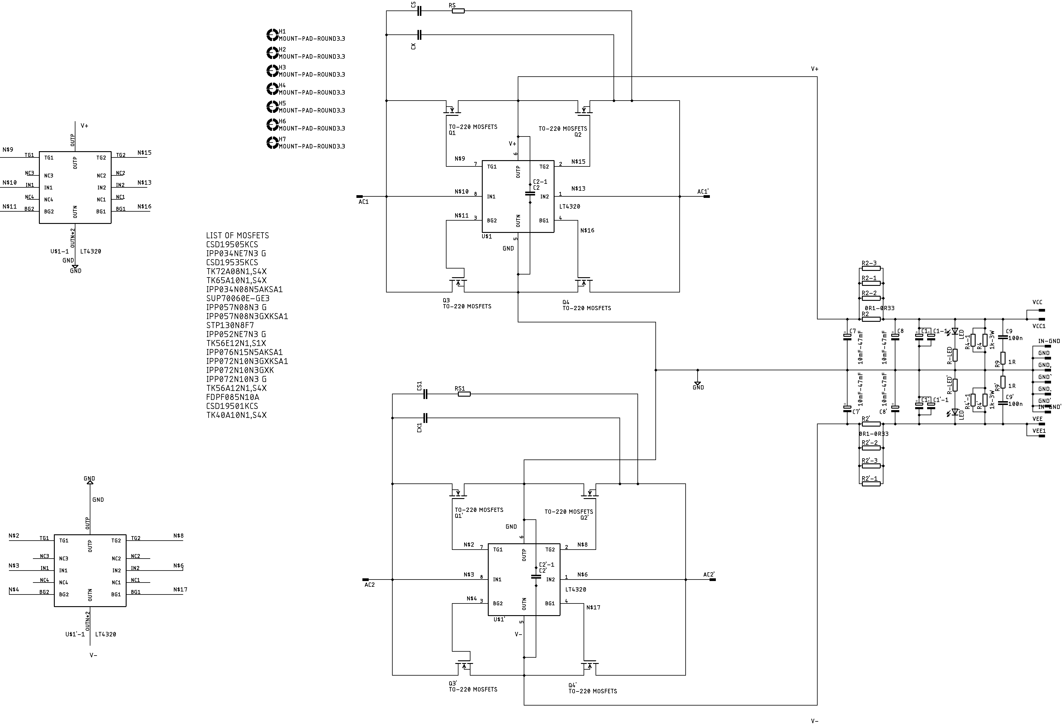

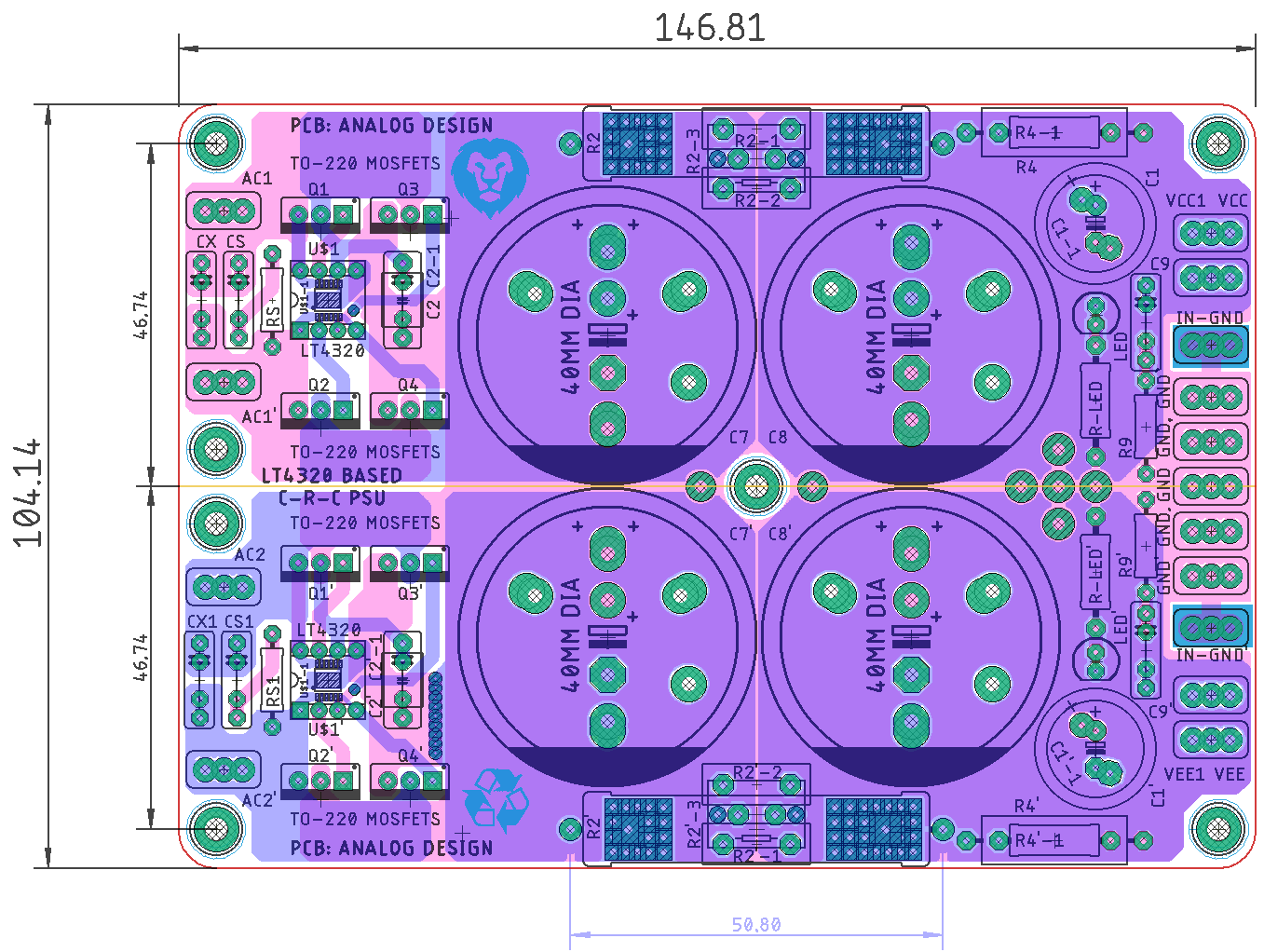

Dear all,
here are the sch, stuffing guide and bom.
regards
prasi

Hi Prassi.
For R9 (output zobel) the schematic shows 1Ω, while the BOM part is 10Ω.
Hello Alazira,
Right-on..
I have it corrected here.
This is an example bom only, one is free to choose whatever components available with him, as pcb is more or less universal with many options for most components.
regards
Prasi
Hello Mpa,
Just some thoughts that could help optimize the psu. The BoM is just a suggestive one.
1.You may want to increase the capacitance of the Main filter caps depending upon your amplifier and parts available with you.
2. Another aspect is Transformer snubbers (CS,CX, RS), you may have to find the correct values depending upon your transformer based on quasimodo design by Mark Johnson or leave them out completely.
3. R of CRC will depend upon your choice, anything from 0.1 to 0.33 ohm can be used here depending upon loss of voltage you can tolerate vs the ripple reduction.
4. LED resistor and power needs to selected based on your voltage.
I have tried to make the BoM as informative as possible including maximum dimensions and pitch spacings of components that PCB can take.
So, request everyone to spend some time studying their amplifier requirements and how best to customize this particular PSU to fulfill those requirements.
regards
Prasi
Thanks Prasi. I have snubber values for my transformer from the quasimodo results thread. Would those still be valid for this circuit? Also, am I best to stick to the R values of CRC from the original Aleph J psu design? 0.47r 3W I think.
