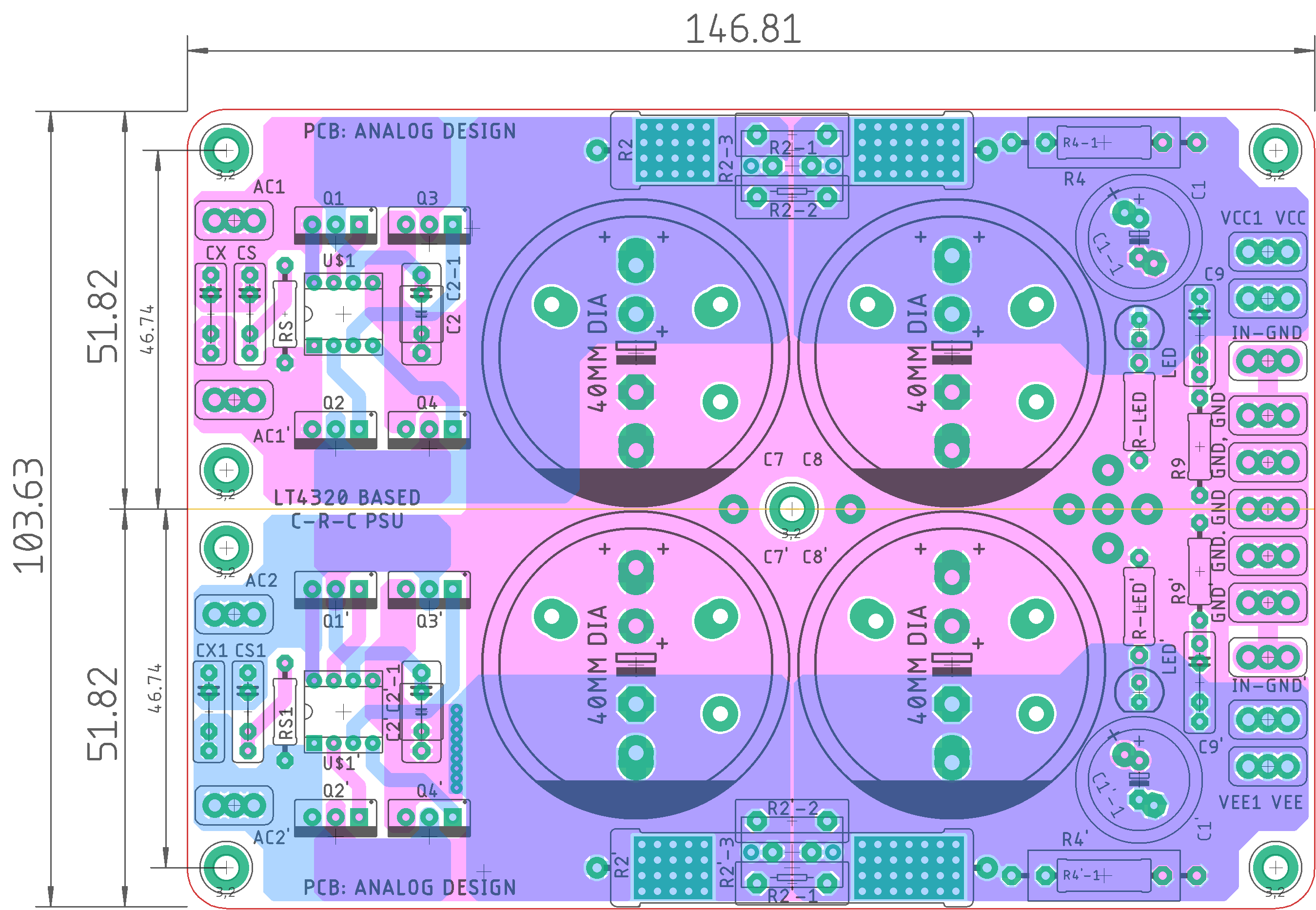

Hello Nikos,
I am ready with my design and sent the gerbers off for a quote @ boardhouse. here is the design.
The current GB list is as follows.

If anyone wants your ripple eater, they can make a separate list at the bottom indicating username and number ripple eater pcbs required. I will produce those too and supply if the demand is anything in excess of 25 -30 boards. otherwise, you may like to produce yourself and supply via a separate GB.
regards
Prasi

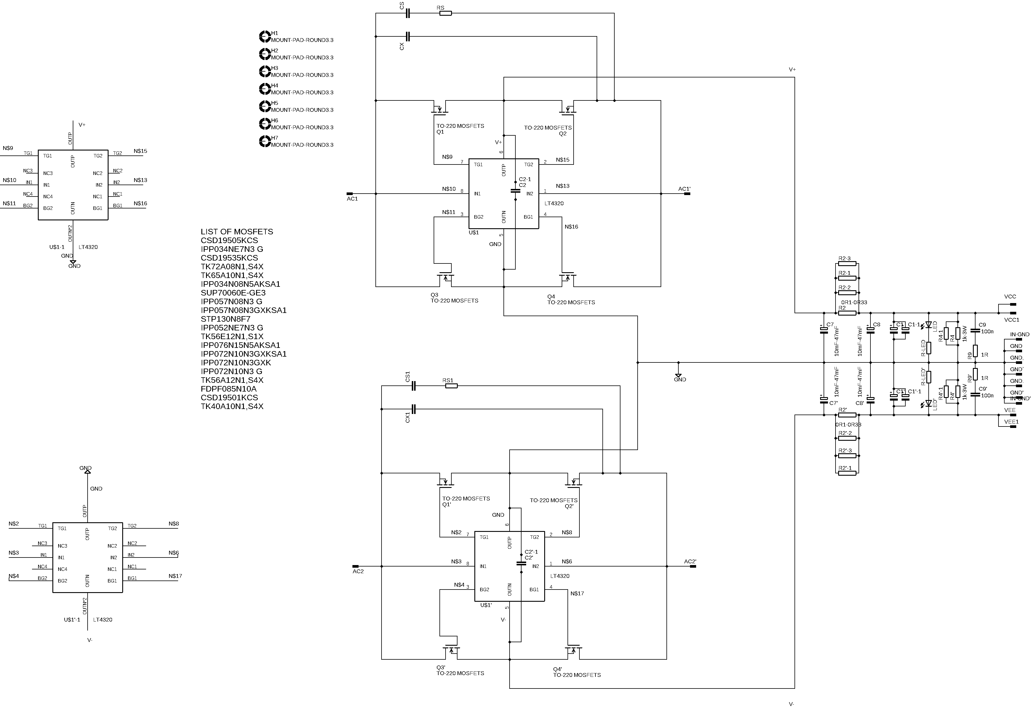

Here is the schematic as per the quoted pcb.
