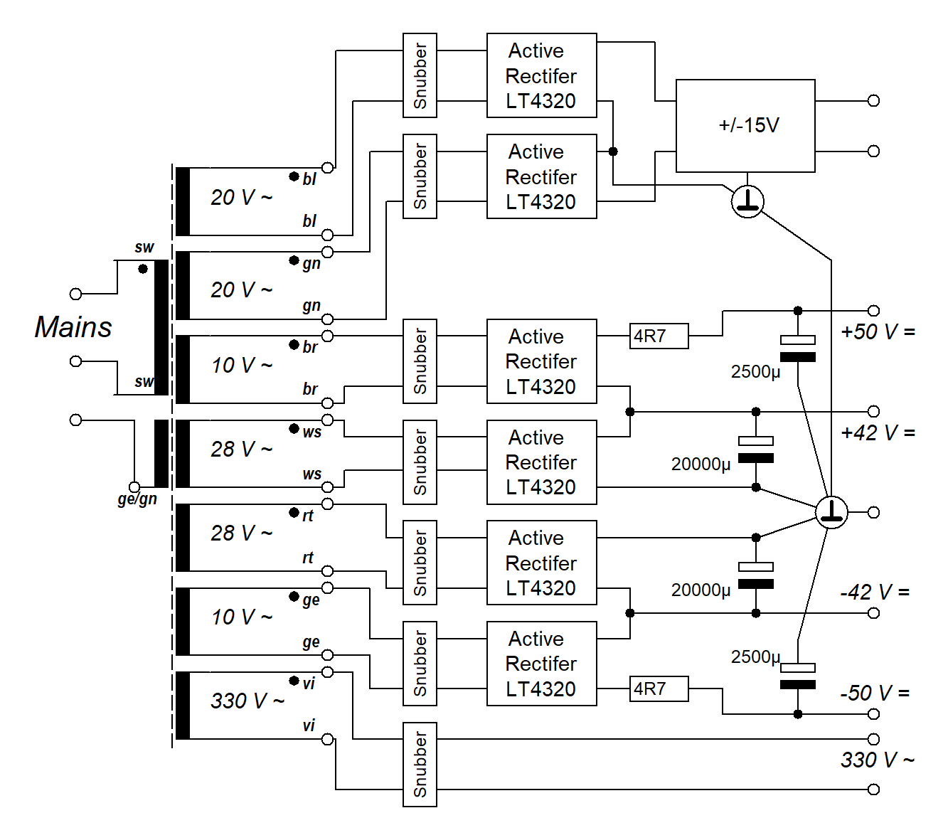

Hello Folks,
I hope it is OK to go slightly off-topic and post my LT4320 based active rectifier question here, where so many enthusiasts are 🙂
I'm redoing the powersupply for my (old) active speakers. Attached is the simplified diagram of what I plan to do.My main qustion is about the staggering of more than two Secondary voltages. I would THINK there is no issue, but maybe someone here has experience or knowledge if my idea would work.
Please have a look at the schematic and if appropriate reply here or send me a private message.
Thanks for the help and advice!
Winfried
Winfried
