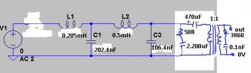

Mine friend Jordi from Tarragona sent me today a couple of tx 15K : 300Ω that I want to try in place of 1:1 tx
I have several doubts about reflected primary impedance can affect your 50Ω characteristic impedance filter to match de Amanero 50Ω output impedance.
Mine maths helped with other forum members are:
-Impedance ratio 50:1 (15000:300)
-Impedance ratio square root 50 = 7 aprox. = 7:1 turns ratio
-15K secondary tx in parallel with 100K load (26 preamp or 5687 headphone amp) = 13K043 secondary load
-13K043 secondary load / 50 impedance ratio = 260.86R reflected primary impedance instead 300R
¿Loading opt tx x2 or x3 times so 50Ω x2 or x3 times = 100 or 150 Ohms and here is x5.72 times this can affect the Amanero's output impedance of 50Ω & your filter?
I'm only a beginner with impedance specs of trafos but those impedance figures represent the load impedances not the characteristic impedance(s) of the windings themselves.
The impedance factor of 50:1 means 100k from your preamp becomes 2k at the output of the filter, this is about 2.5% reduction of 50ohm not really a problem, you could increase the 50ohm load resistor to 51ohm but I doubt its worth the effort.

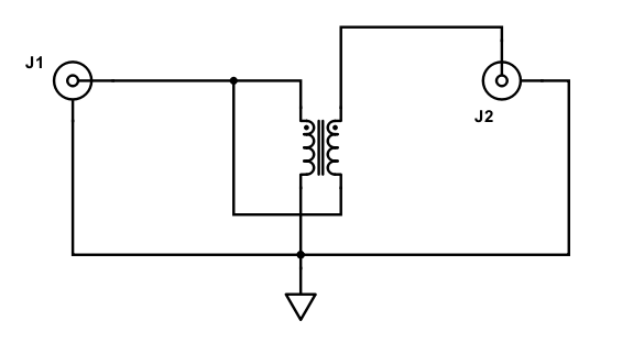

I want to use the 1:1 OPT for a gain of 6dB (attached pic), could still use your filter without modification?
