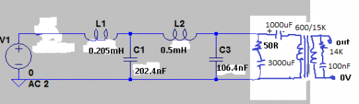

Now time to measure the LCLC low pass filter together the OPT to measure ringing to calculate the proper RC filter.

Attached last schematic I'm using.
Real values LPF are for inductors are 0.2mH & 0.5mH, for capacitors 200nF & 100nF.
  • ACTUAL 50 ohm characteristic impedance 4th order low pass filter con tx 1=1 600 ohms (2019_07_02.png

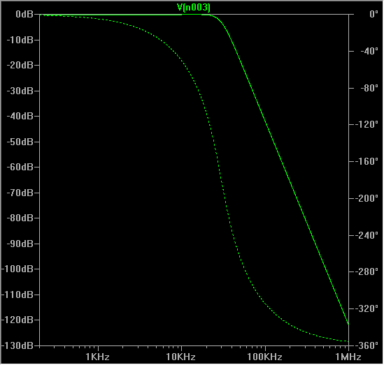

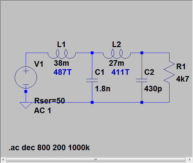

Here's a variant of the noDAC filter designed for use with an active buffer (Zout is 4.7k). It has a loss of only 0.2dB.
Thank you very much, the filter have two specs that I like very much: one is the low loss & the other is the output impedance that I guess will match very well with the 100K input impedance of the next source, if I calculate well with OPT 600/15K will reflect 4K, it's OK?
What kind of filter is: Bessel, Butterworth, etc?
Whats the corner frequency: 50KHz?
... the output impedance that I guess will match very well with the 100K input impedance of the next source
The output impedance of this filter is well suited to a local buffer's input. Its not suited to feeding to another piece of equipment without a buffer between.
I'm unclear how you're thinking of connecting the transformer. This filter isn't suited to driving a transformer directly.
The filter's a Butterworth, 4th order with an fc about 30kHz.
